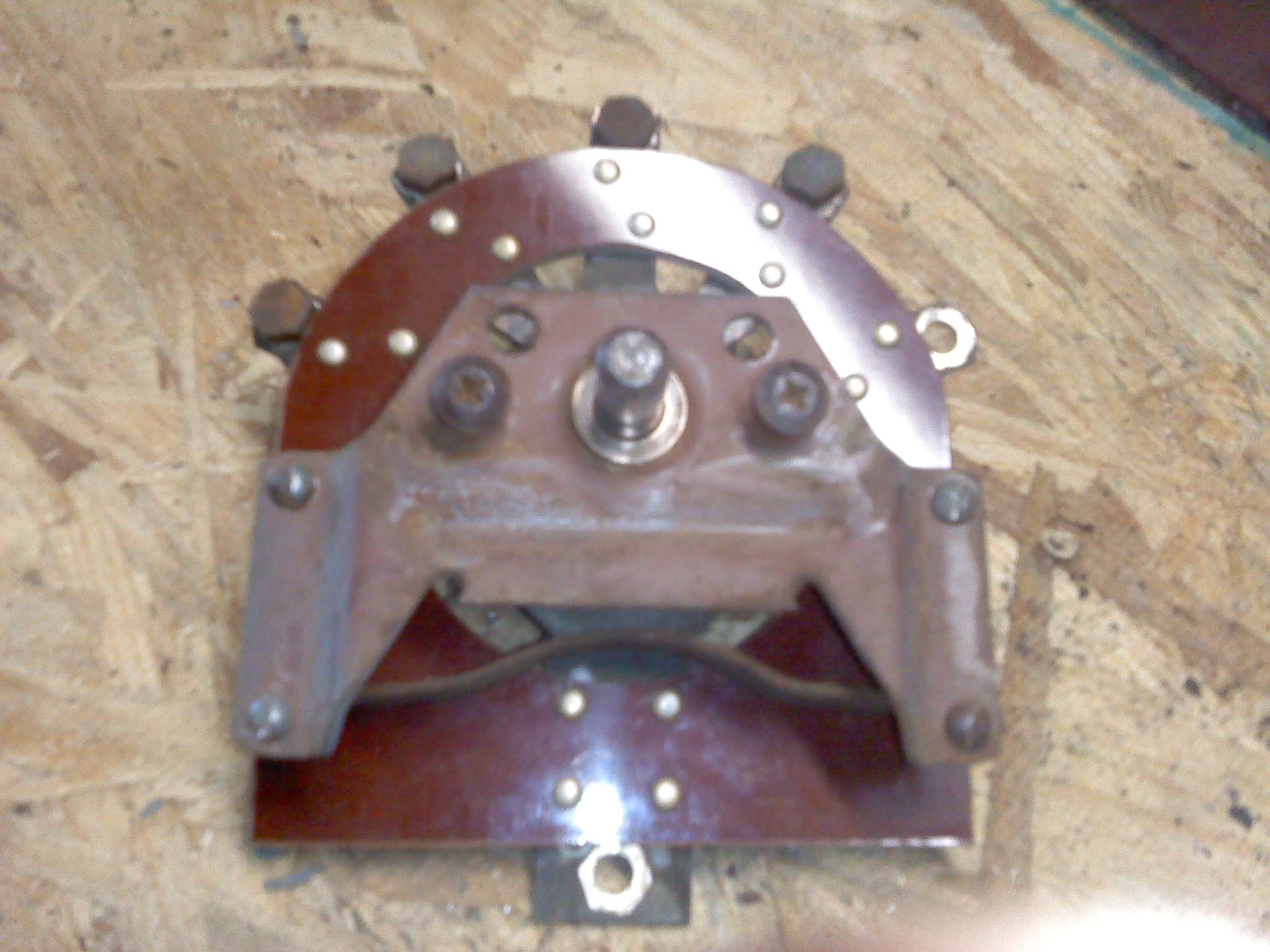

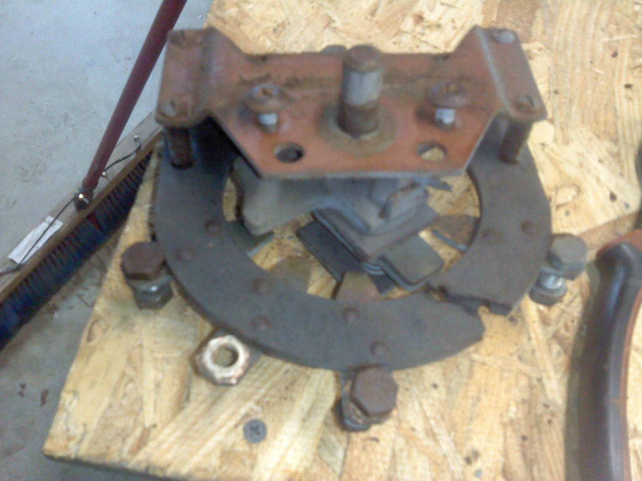

Instead of doing nothing, I did have a fix to the amp switch I needed to take care of. The Macarta insulating board that hold the contacts was broken and one contact loose. A new switch is about $200 and I didnt want to pay that. So, I orderd a 12x12x3/16 peice of macarta board from granger. Total cost $13. took the old switch apart and drilled out all the rivets that hold the contacts to the board. I Then laid the old broken board on top of the new board and used a scatch awl to outline the edges of the board, With the old board and new board clamped together, I used the old board for a templet to drill the 14 1/8 in holes for the contacts. A little bit of work with a jigsaw and dremel and here are the results. Less thant $20 instead of the $200 for a new switch.

Thanks, its nice to have a buddy that owns one those fancey rivet squishing machines. Took him all of 5 minutes to attach the contacts
