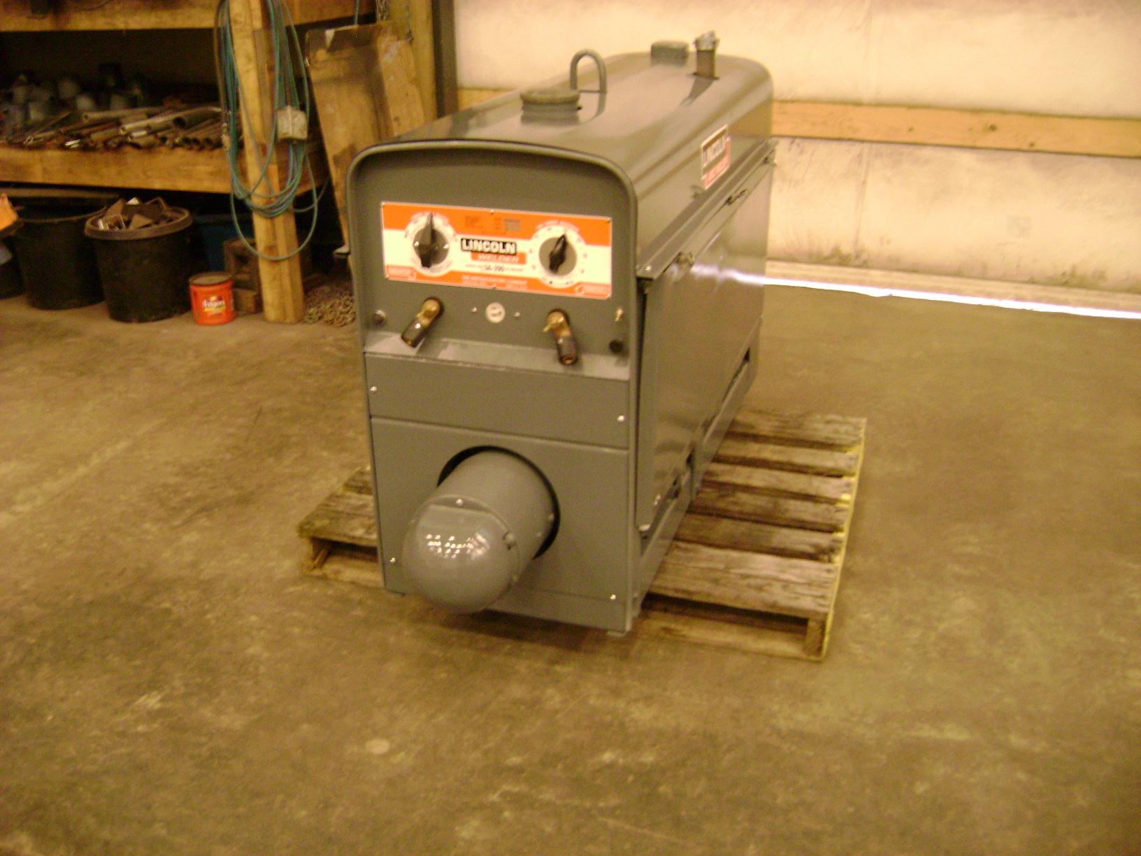

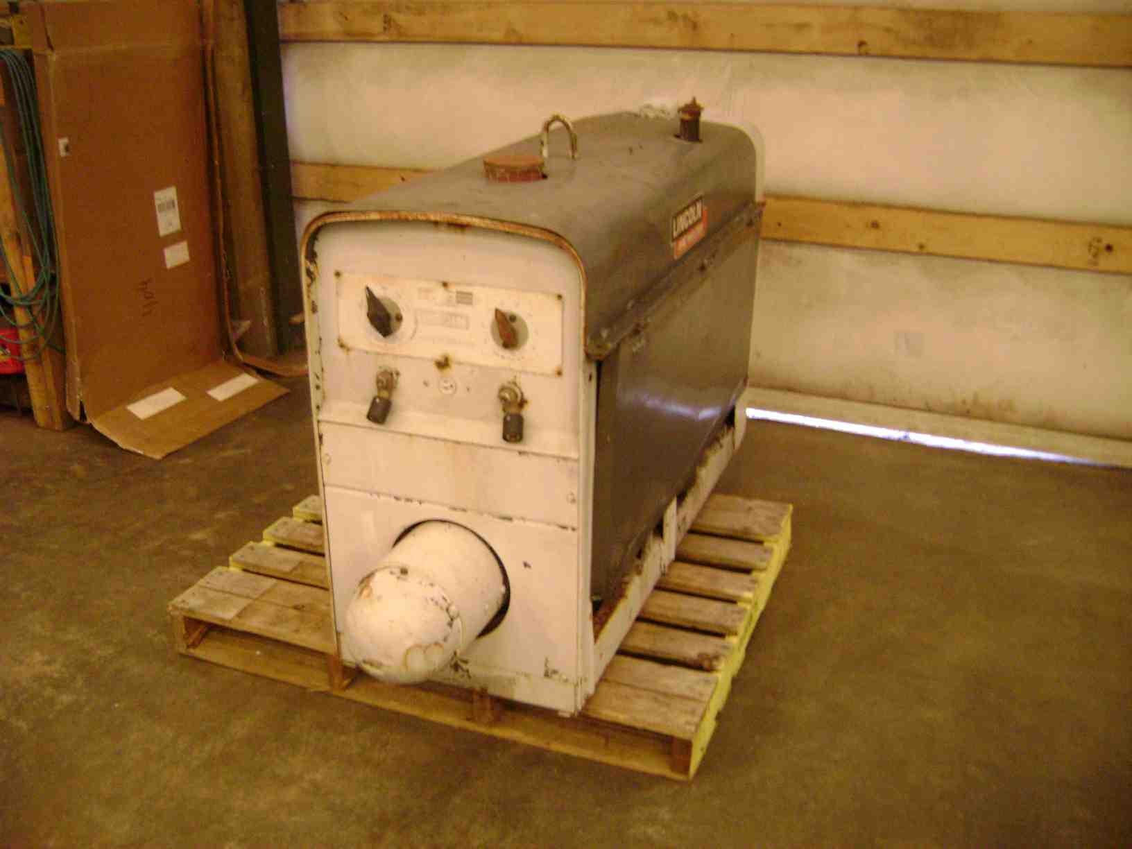

I paid $200.00 for this 1966 Red Face, and turned down $6,000.00. Guy was mad as a wet hen when I wouldn't sell it to him.:laughing: Paint will cost you around $150.00. Remember those Continental engine went is a lot of equipment, especially forklifts, and tractors. I'd offer him $250.00 remove the spark plugs and fill the cylinders with Kroil penetrating oil, and let it set for a month.

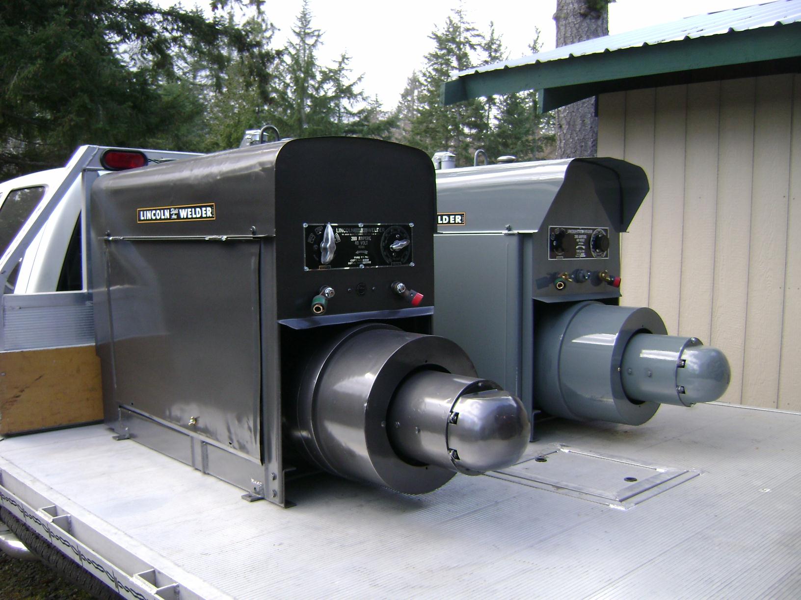

muddstopper the SA-200 you're thinking about buying must look like these?

The welder looks more like the one on the left than it does the one on the right. Its a few miles to where the machine is at. I plan on sometime today driving over and I will get a few pic's. Where do I look for serial numbers and such other information to identify with.
I am sure the faceplate around the dials is not red, No color at all really. Dont know if its just faded or what. It is good to know the flat head engine was used for many years, but it could also mean the machine isnt as old as I first thought. I guess a little more research is in order.

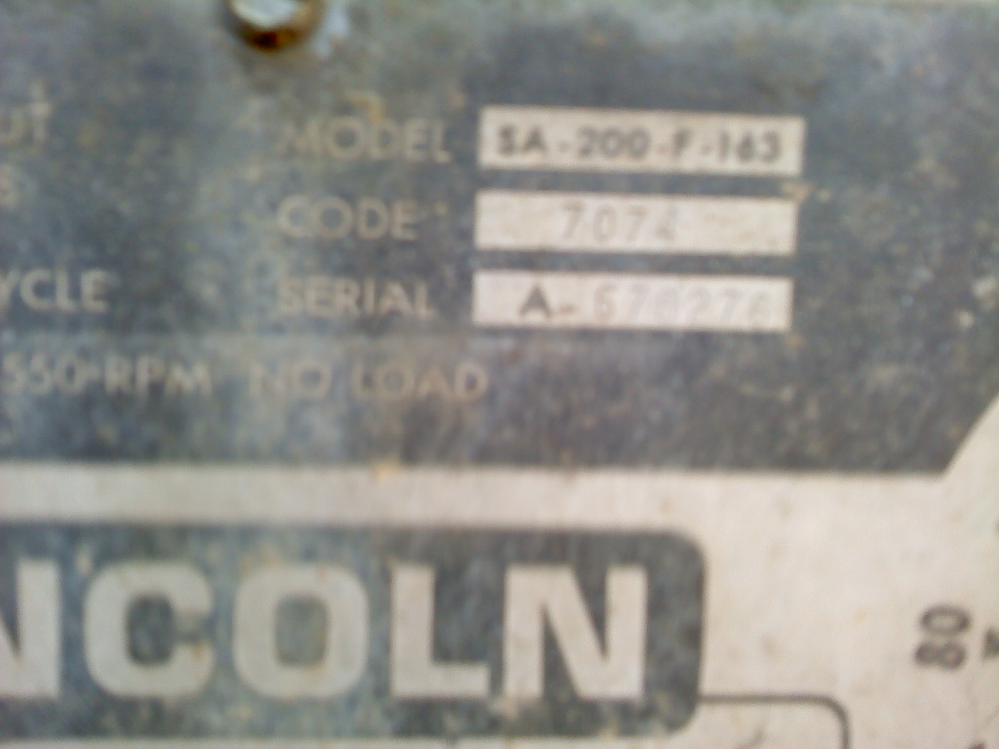

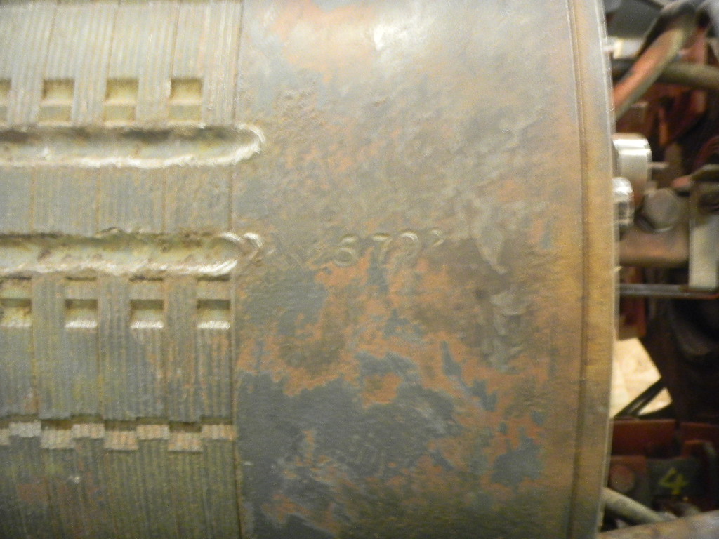

The serial number, and code number should be on the face plate. If not the code number should be on the generator, on the left side looking at the face plate.

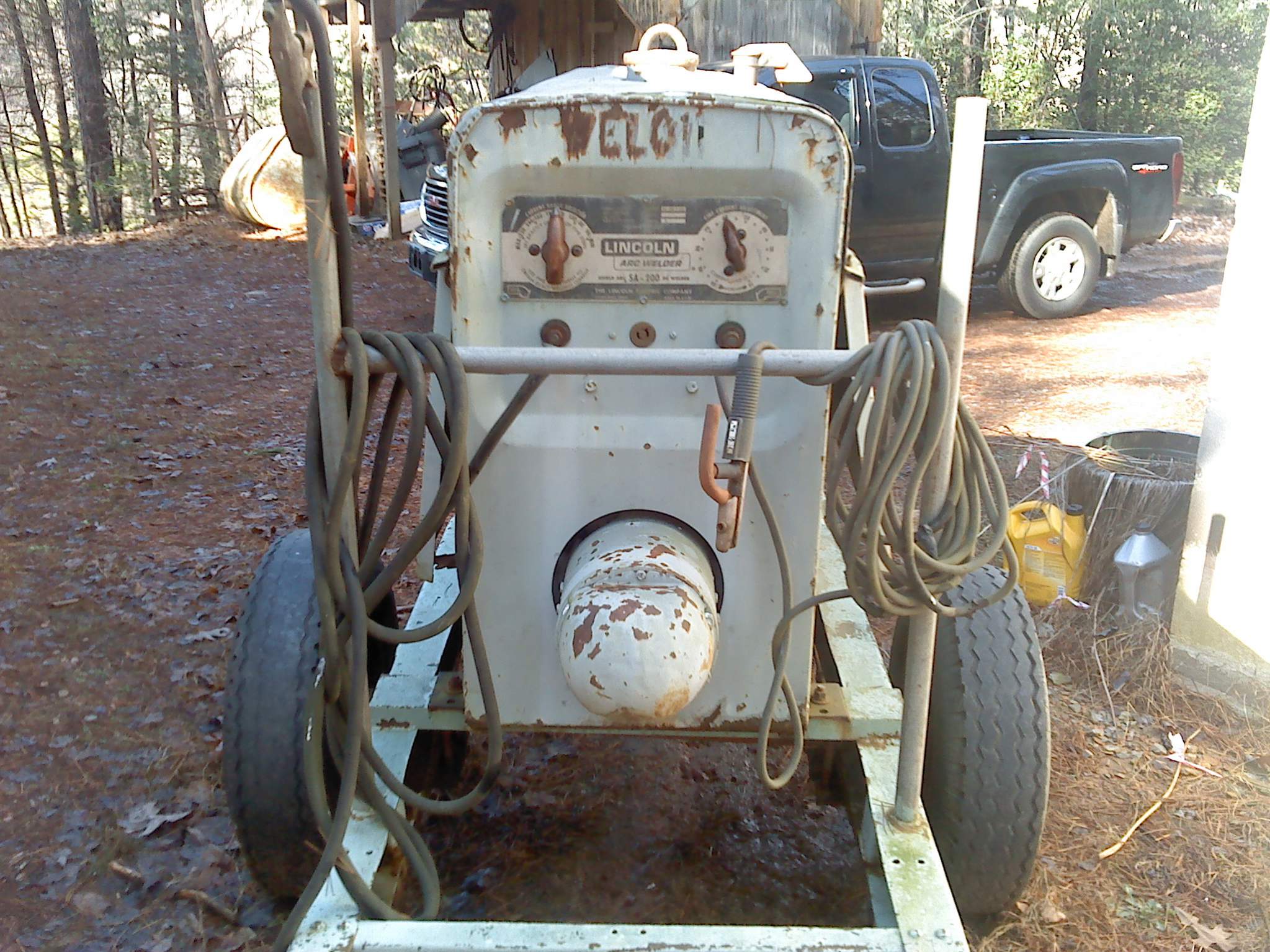

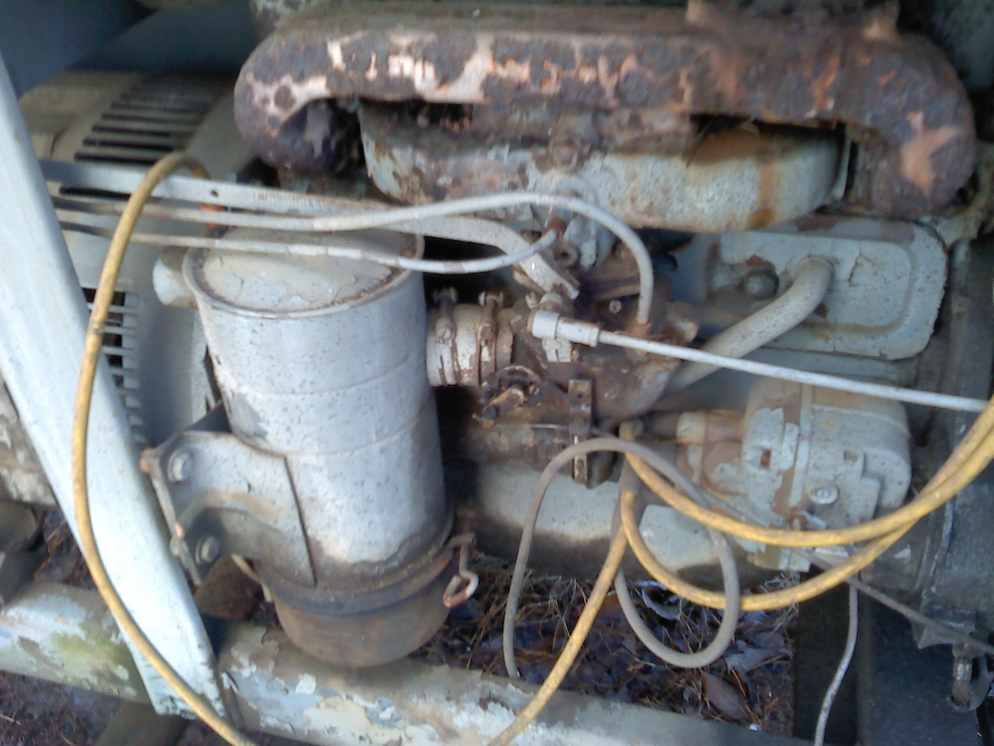

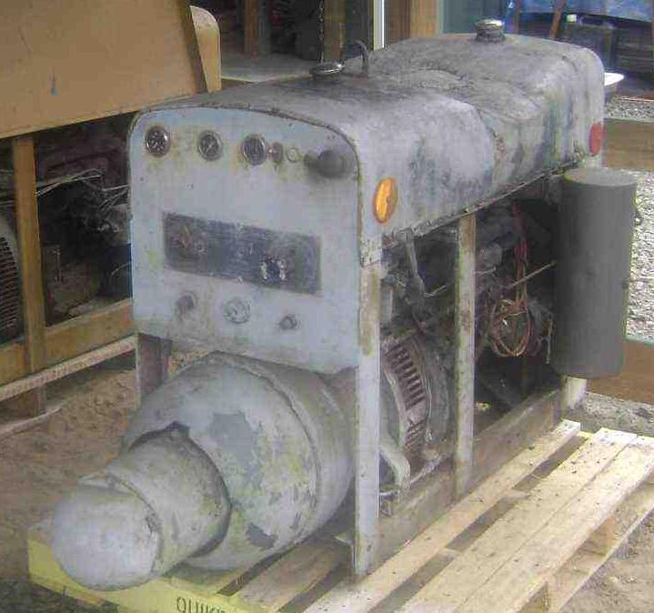

finally got back to take another look at the welder. Here are what numbers I could find.
Model sa200-f-163
Code 7074
Serial#678276
Magneto
Fairbanks Morse
CW 15
fmX4B16A-1
Serial# 7164291
I found these numbers on the engine, but dont know if its a complete number or partial. 400space6space2.
I have some pics to post after I get them uploaded

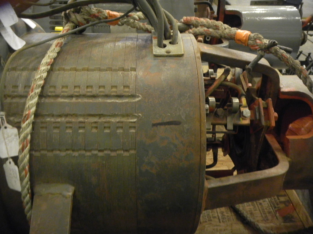

It's a late 1971. It has the octagon barrel generator!:( I have a 1974 with an octagon barrel generator, personally I don't think they weld as nice as the round barrels.

In my opinion the octagon barrel generators are just another welder, nothing special at all! If I ever get off my a $ $, I have my 1974 in the shop now, I'm going to mate a 5-gear round barrel to the engine, and put it all in a Short Hood body. :thumbsup:
/ SA200, what it worth?
#14
Are the octagon barrel welders that are supposed to have the aluminum winding? What are the drawback or faults of this particular welder
/ SA200, what it worth? #15
Yes they have aluminum in the shunts. I think it was 1977 had the highest failure rate in the history of the SA-200s.
It's hard to explain the difference. But if you could weld with both side by side you could see the difference in the quality of arcs. It is just hard to beat a 100% copper DC generator!

It must be one of the first octagon barrel machines. I thought they didn't come out till 73? It looks in pretty good shape appearance wise. While not as desirable as the round barrel it's still an SA200 :thumbsup: I don't think there's a welder on the planet that would complain if all that was available to use was an octagon SA200. Now if you were talking about about buzz box's and 110 volt machines, most welders would rather stick something sharp in their eye. When they work properly, there's not really such a thing as a bad SA200, some are just more desirable. It's worth getting checked out for sure!
