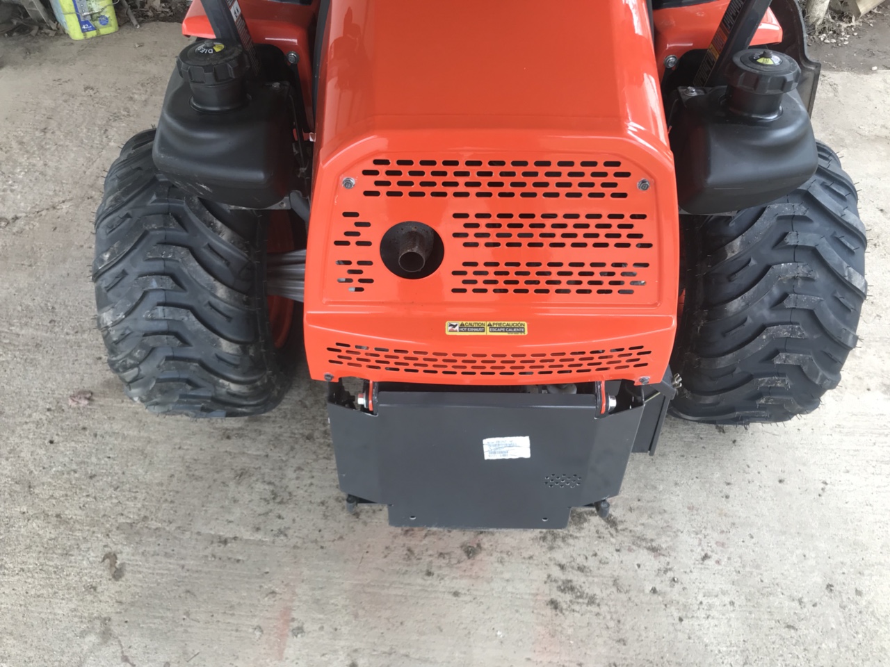

I just put WT300 tires on my ZD326P this spring and really like them so far. Much better traction and they don’t seem to scuff the turf as bad as the original tires that came on it. If been running ZD machines since 2002 so perhaps I operate the machine better now than when I got my first one. I’m glad I upgraded

Looks great!! I may need to get a set! Were they hard to mount like mentioned in blog post above?

Too bad my machine doesn't look as clean as yours! Way too dusty here...

As far as mounting they weren’t that bad but we couldn’t get them to air up. Had to go to a tire shop so they used those big volume tanks to seat the bead. My advice is take them to a tire shop
Yours can be clean too, soap and water is all it takes. Lol

Put a ratchet tie down around the circumference of the tire, tighten it a little, then seat the bead with air. Take the tie down off before fully inflating.

Do you have a side view of mower with new tires?

The WT300 tires are 10/10 for me. I wish I put them on years ago. R3 turf tires are useless to me.

Tried that John, didn't work for me.
I used a liberal amount of dish soap on both the tire and rim. I also kept the tire vertical to catch the rim easier. Sometimes you just need 3 hands. The first tire caught perfectly on the first try. Second one I had to get a helper as I don’t have self locking inflator.

Do the sharp edges of the tractor tires cause any turf damage?

It's all in the operators hands.
I tear up grass less with the WT300's because they don't slide. On slopes the R3 Turfs slide no matter what because they have no traction. I have no tear up on slopes with the WT300's because I can now control it. If you control it like toggle switches (i.e. full forward to full reverse) you can tear it up good.
