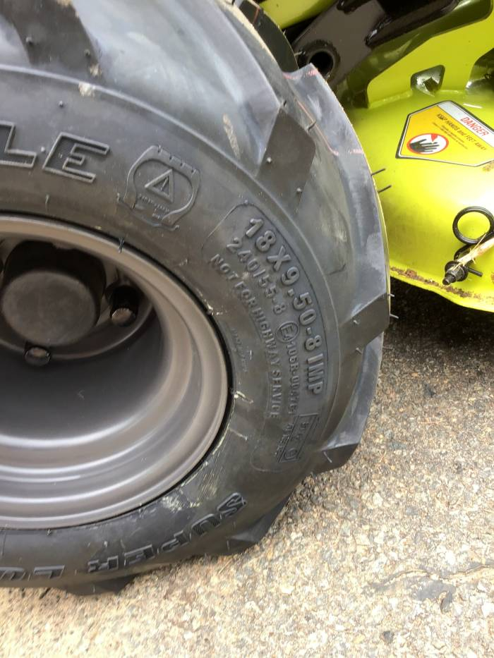

Put these on the Ryobi ZT480e. LOTS better traction than stock turfs. However, they can really gough if you're not careful, particularly going downhill and turning.
Much much safer to use than the turfs.
