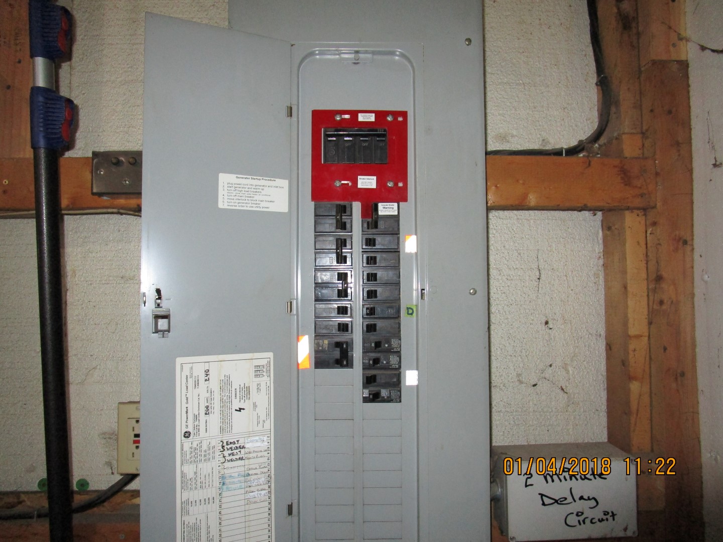

The new gen you bought should run the important stuff you need to have on, and you can turn off/on breakers to manage the rest. I start by shutting everything off except specially marked breakers [ reflective tape you can see by flashlight in the middle of the night when you are half asleep ], shut the main off, fire up the generator then start turning breakers on as needed. I run a forced air furnace and deep well pump with my gen that is similar to yours. The TV's and most needed lights are nuisance loads.. don't really mount to much. So the better half can watch TV, read, or whatever whilst you are outside feeding fuel to the beast and flipping breakers... Here is a picture of my barn panel, which I backfeed. The house is fed off this panel via a 100 amp breaker. I have two switched neon lights clipped onto the feed coming from the meter to monitor if/when the store bought power comes back on.
