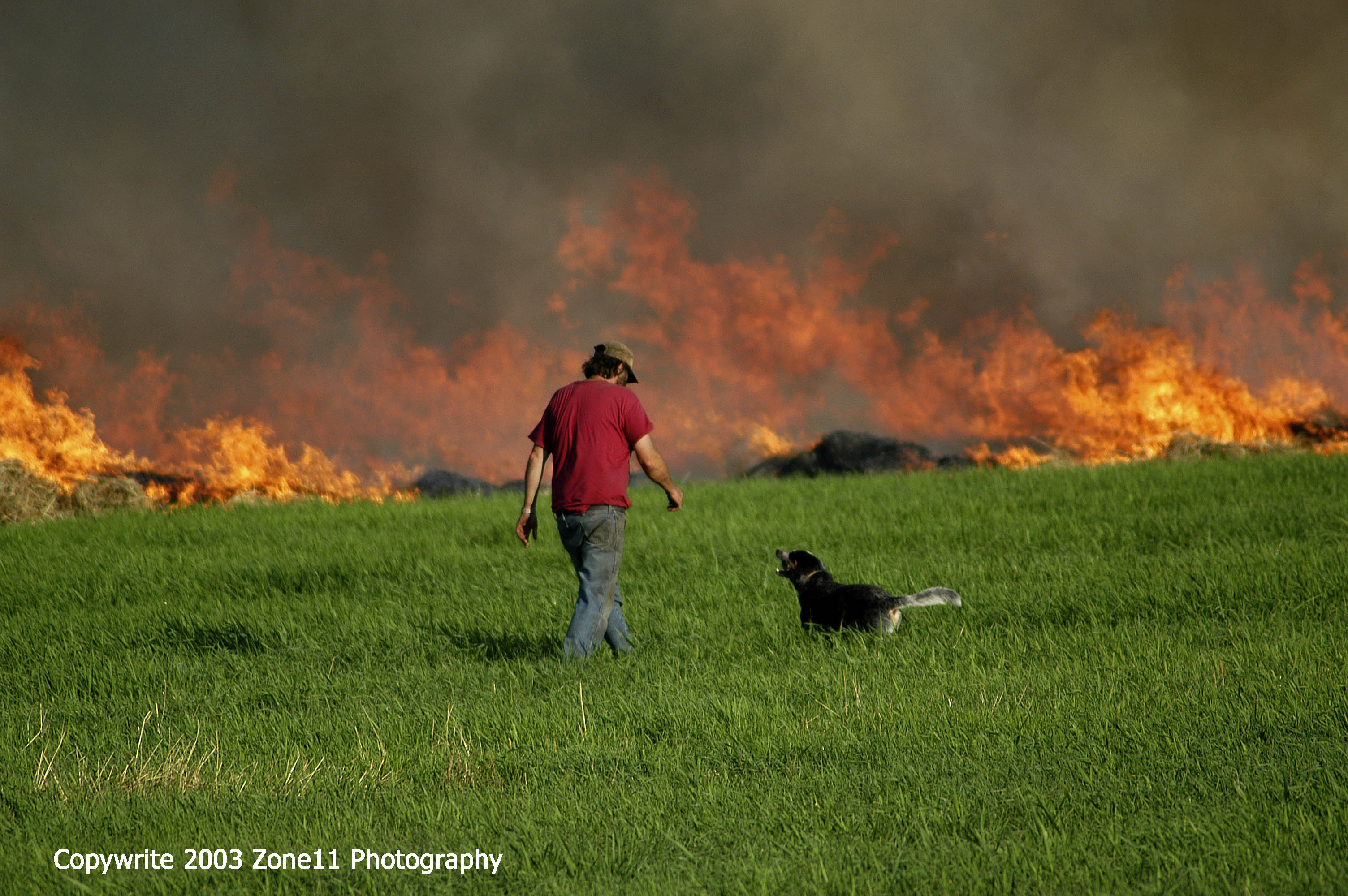

...and here is a photo to prove it. I shot this in VT as the farmers burned their junk hay in the field. I think it got wet before they could bring it in.
Aquaman said:
The old-fashioned way is still probably the best - burn the field. Kills weeds (and bugs), stimulates the grasses, and enriches the soil. Not to mention drying it out...........:cool:

PNW is where most grass seed is grown. Burning the field after harvest is very common practice. Weeds are not tolerated and if burning promoted weed growth the practice wouldn't fly around here.
