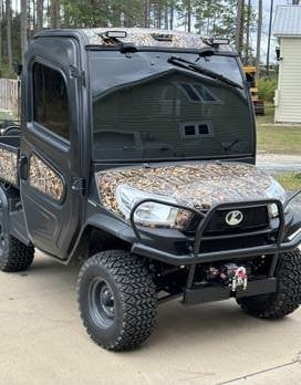

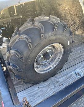

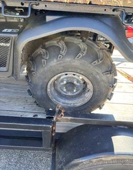

There is a way to get more speed out of them, but I won't mess with the governor on it. I don't need speed; I need a workhorse, and you are so right about fuel. I got this one back in November. I use it just as much as my Ranger around the farm, and it sips fuel. The thing is built like a tank! The picture I showed had factory turf tires, and being in N Florida, we have uplands and lowlands, so I put a set of ITP Mudlite 27x10x12 tires on it. They ride really well and get through our swamps, where those turfs did not want to go
