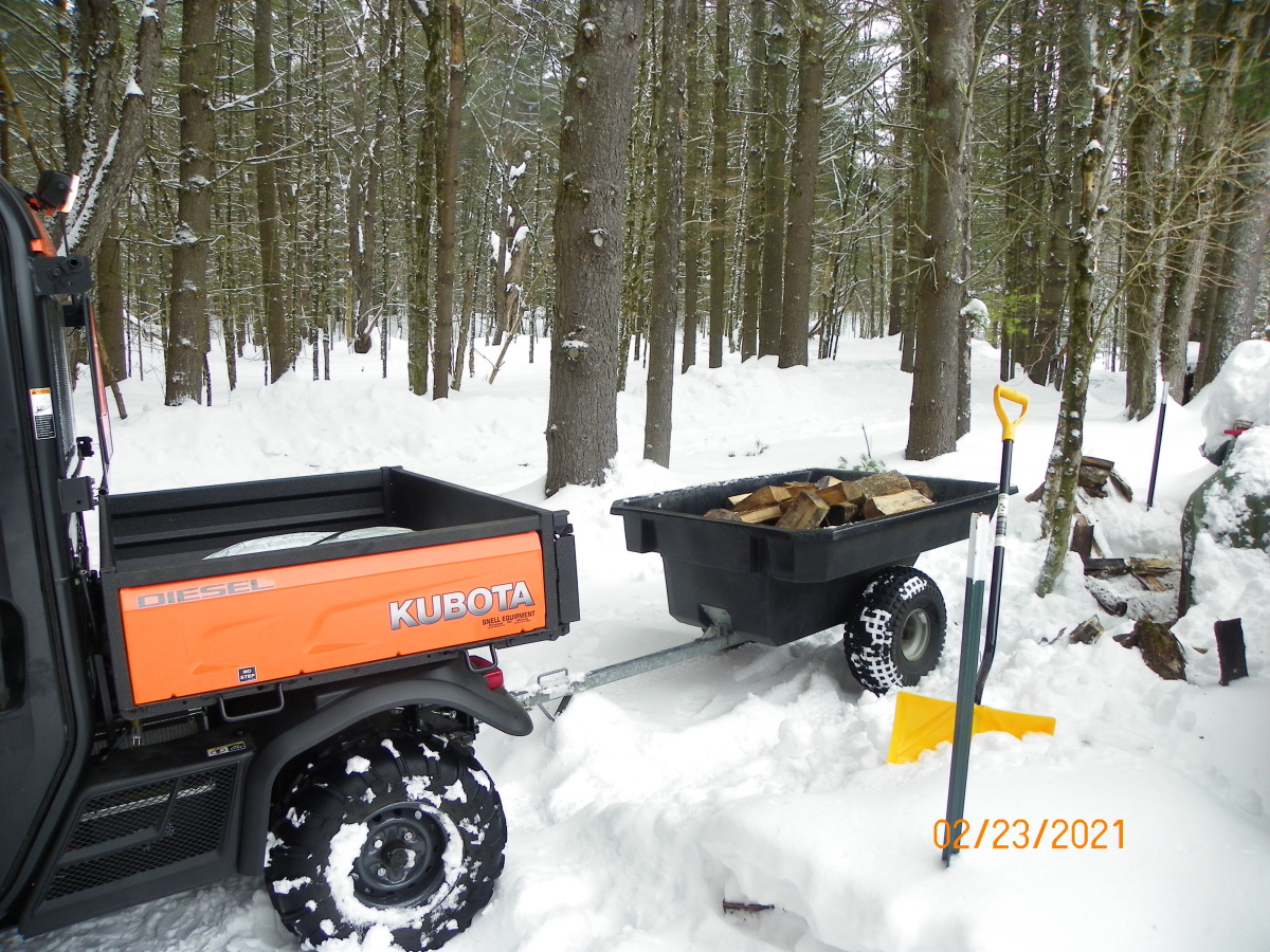

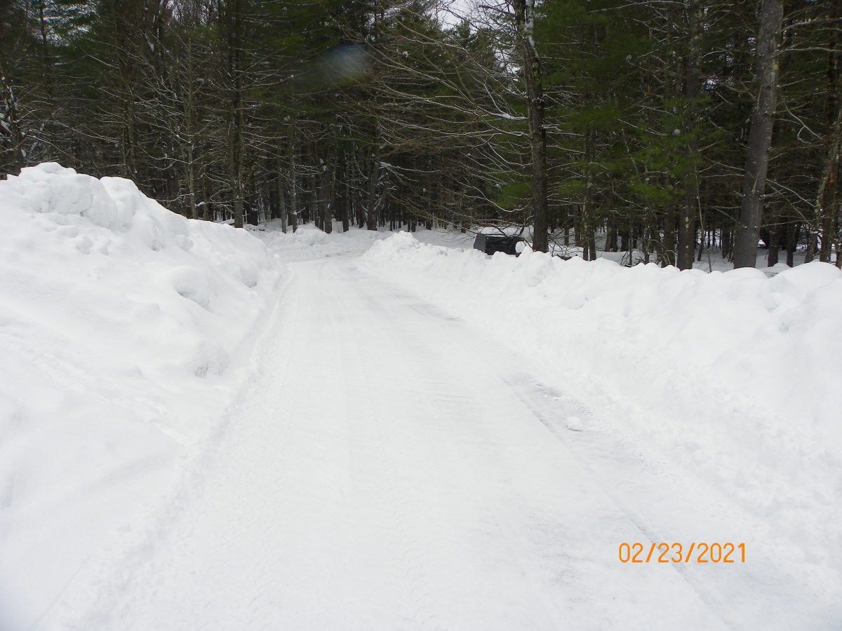

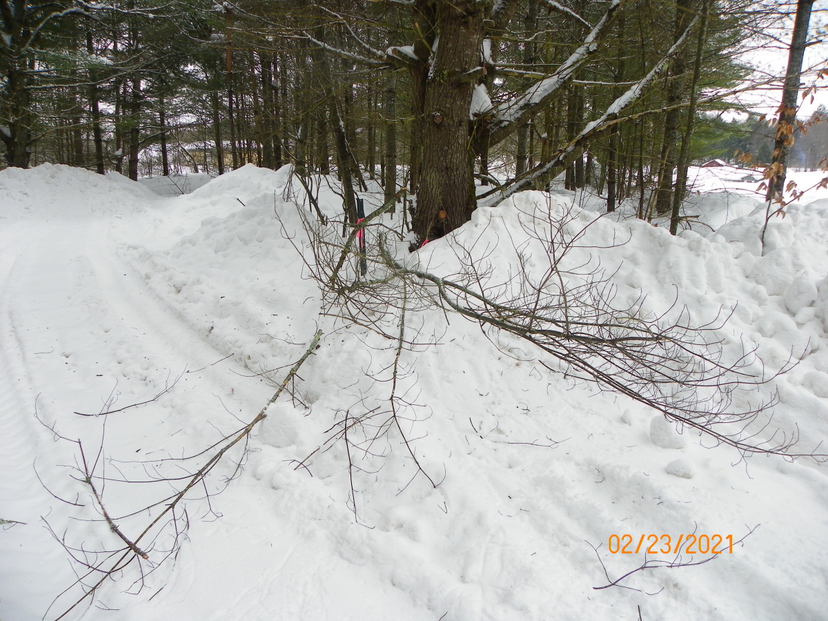

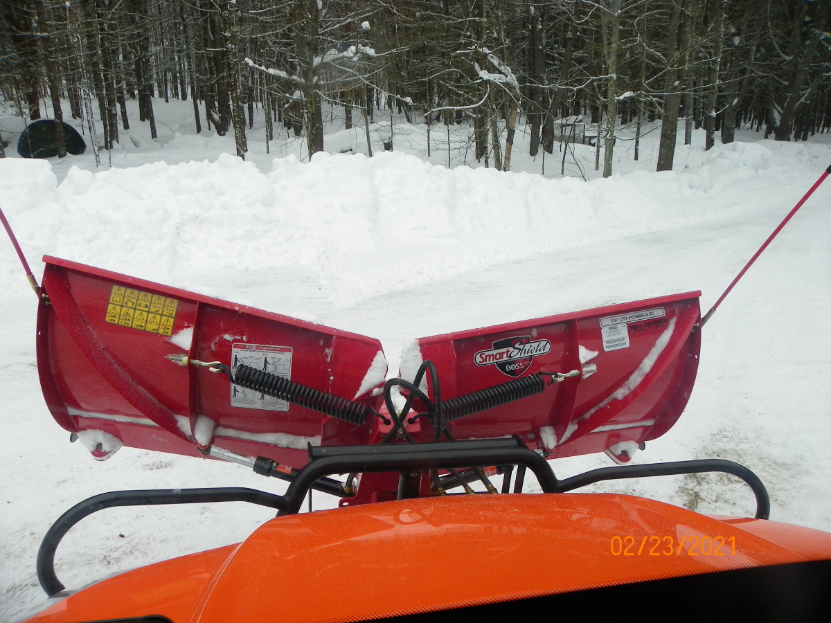

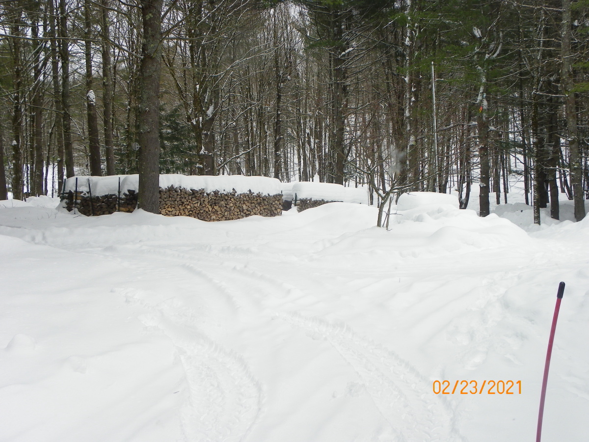

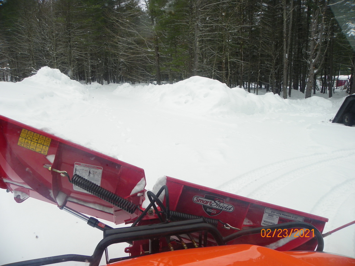

We had just over two inches of snow so I removed that from the driveway.
Picture 1528 I'm just getting started, 1529 is pushing the snow to the southside of our driveway, 1530 is some branches that came down yesterday, I moved those so I could plow in that area,1532 is the first of two smaller loads of wood we put in and the last picture is the next two years worth of firewood, 24 face cord of ash.

We put in two loads of firewood this morning, the first load was all Yellow Birch and the second (pictured) was mostly Cherry.

Sorry for not getting on here sooner, we added two lights up front on the top of the cab and one on the back, we also added the screen for protection of the back window.
I don't have the Boss V-Plow model number inside but I see you went with something else. We did go with the ATV tires and glad that we did.
