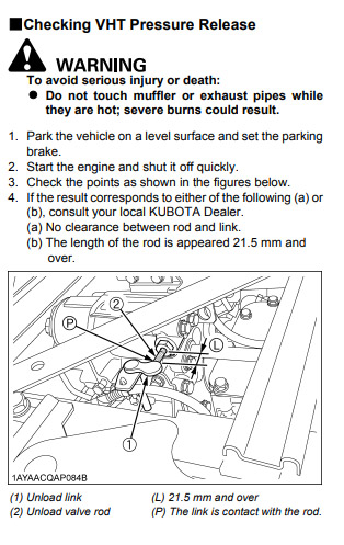

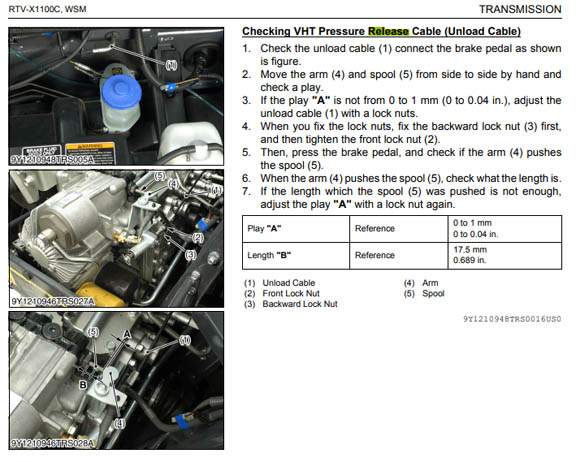

Looked at both the OM and the WSM for the RTV-X1100C about checking VHT release pressure.
The WSM seems to check if the "spool" length is at least 17.5 mm while the OM checks to see if the "spool" length is not over 21.5 mm.
Maybe I'm reading this all wrong.
Won't be checking today as it's single digits out there.

Yeah, I would ignore the owner's manual as that clearly looks like a bad translation and they only seem to be giving the spec to diagnose a problem. The WSM has the proper adjustment procedure.

I am trying to improve my shift response too on my 2016 x1100c , I see my rod is sticking out of control valve 21.4 mm when cold and not pressing brake. I am tempted to tighten cable so that lobe pushes in on rod a few more millimeters even without pressing brake , so that when brake is pressed it will push rod in further to release hydraulic pressure when shifting. I do not have a WSM so any suggestions from those that have a WSM much appreciated.

Well you definitely don't want any pressure on that plunger rod until you mash on the brake, since it will bleed pressure off and that would be bad while you're under power. There should be a very slight gap between the cam lobe and the plunger under normal conditions, then you need to get the rod length set to ~ 17.5mm when the brake pedal is mashed.
The left image up in post 82 is from the WSM so refer to that.

Thanks s219....The operator manual is useless in explaining what to aim towards...instead it tells you what not to have. .....that 17.5 mm when brake applied ....and a slight gap between lobe and rod when no brake applied is what I will aim towards. There seems to be a bit of slack in cable that I can reduce. Thks

I checked today and with the foot off the brake the length looked to be over 21.5 mm so I tightened up the cable to 21.5 mm - or as close as what appeared to be that as not that easy to get my hands with a digital caliper under there - and after adjustment with the brake pedal pushed the rod length was 17.5 mm - or pretty close for reason already mentioned.
I assume the cable will stretch with time so will need adjustment in the future.
Seems to shift better but still on occasion - not as often - it will seem to stick in a gear and will require a small blip of the accelerator to move the gear a small fraction to free up to shift.

That is the same thing I did yesterday lloyd123, although I had some calipers. It seemed to slightly improve shifting, but maybe that's in my hopeful mind. At least I know it is adjusted to specs and probably will continue to require the few times where I feather the gas pedal while gently find sweet spot to click it into gear, sadly that is a slow process when in middle of plowing or on a rocky hill. It is the only downside to this rig that I love otherwise. I have learned to NEVER turn off ignition without putting in neutral, because getting it out of gear to start it is a bear ! ( shake and push rig to loosen )

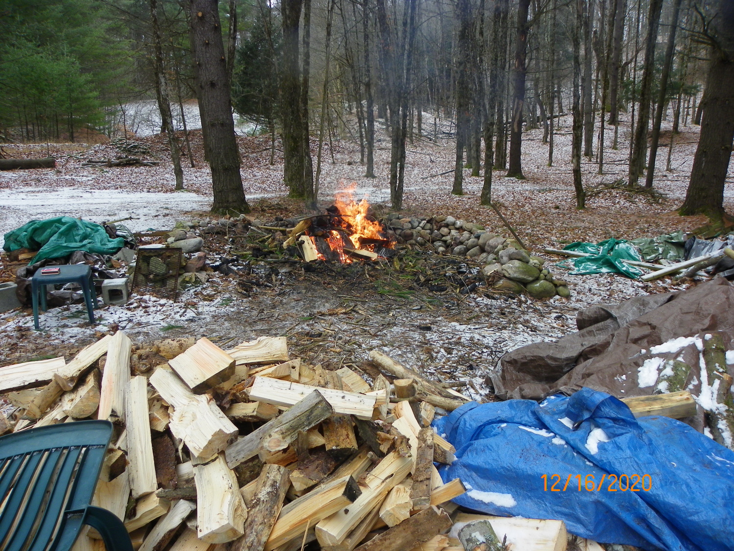

With the next two storms capable of dumping a total of two feet of snow on us, we decided to put in what was left of our February firewood. That was the last of the beech,sugar and red maple.

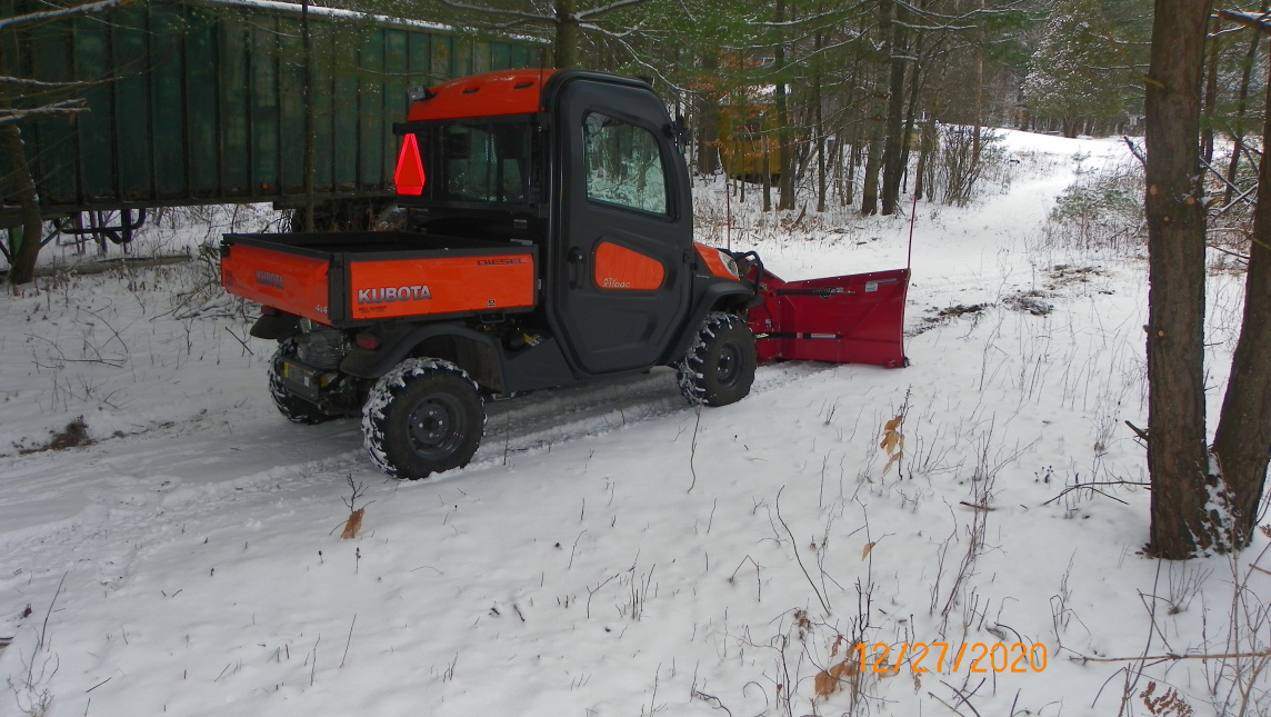

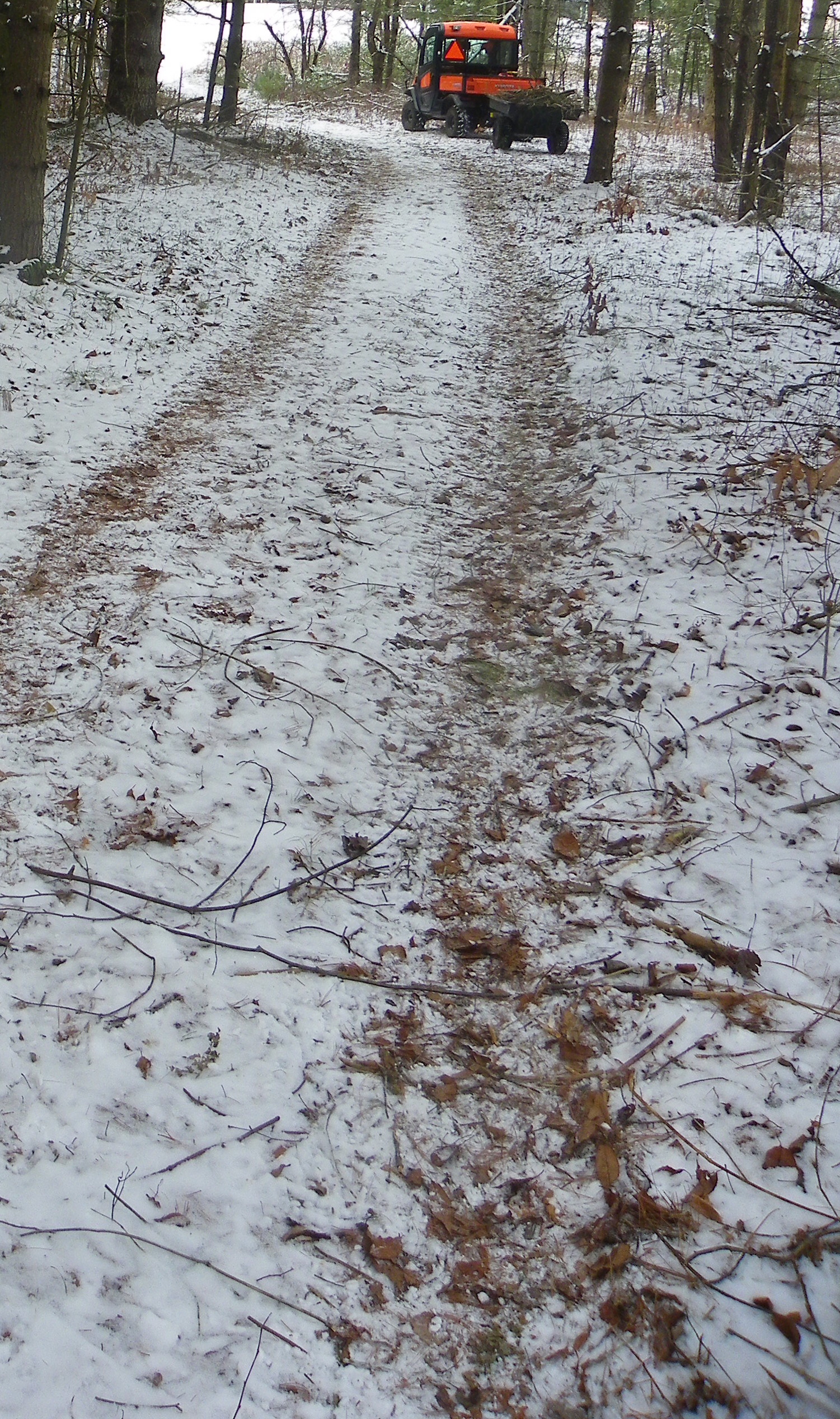

I cleaned up the 2 to 3 inches of snow on the driveway and plowed a bunch of trails in the woods. The next system coming in will only drop 1-3 inches of snow on our area unless the forecast changes.
