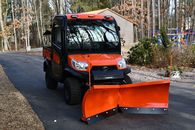

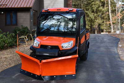

I'm not sure why I didn't post this but this was at the dealers after the installation of the plow.
Swampy6........I was just going to ask this.......I just ordered the Boss 6.6 vee plow for my new RTV 1100C and I was wondering if you could still use the grill guard. Looks like you can!
One other question, my Boss dealer wasn't sure........do you still have access to the front receiver hitch in the summer with the low off? Because I had my winch put on a receiver mount from Orange Aftermarket so that I could use it front or rear.
We looked at the install manual and it does look like the plow mount harness has a square hole in it?
/ RTV - X1100C #139
You can access the front hitch with the V-plow off for the summer but the access is cramped to place your hitch pin.
You may also have to “adjust” the placement of the hitch pin for your winch because it looks like the depth of the front hitch pin receiver placement is not standard - I have had to drill new pin holes in a couple of cases.
