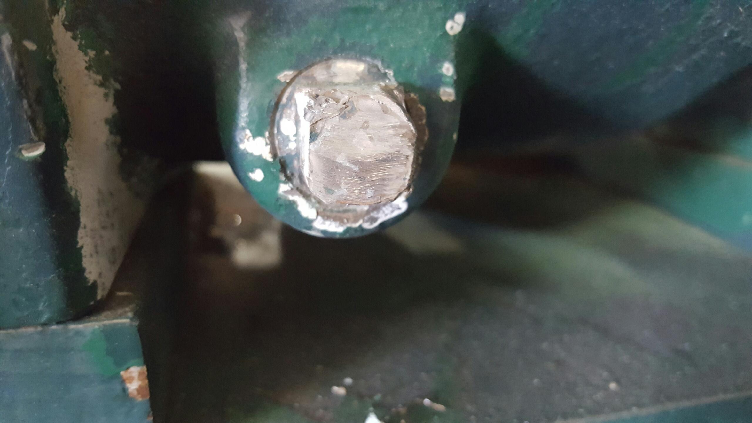

OR, grind what's left of the whatever type headed plug, then center punch it and then drill it with a close to the original thread diameter bit and let the 'oil' out. Then easy out the remaining carcass of the original plug and insert a new plug, with a head that the OP can put a wrench on to remove for the next 1000 year oil change, whether it needs one or not. Job done, throw money!:applause:

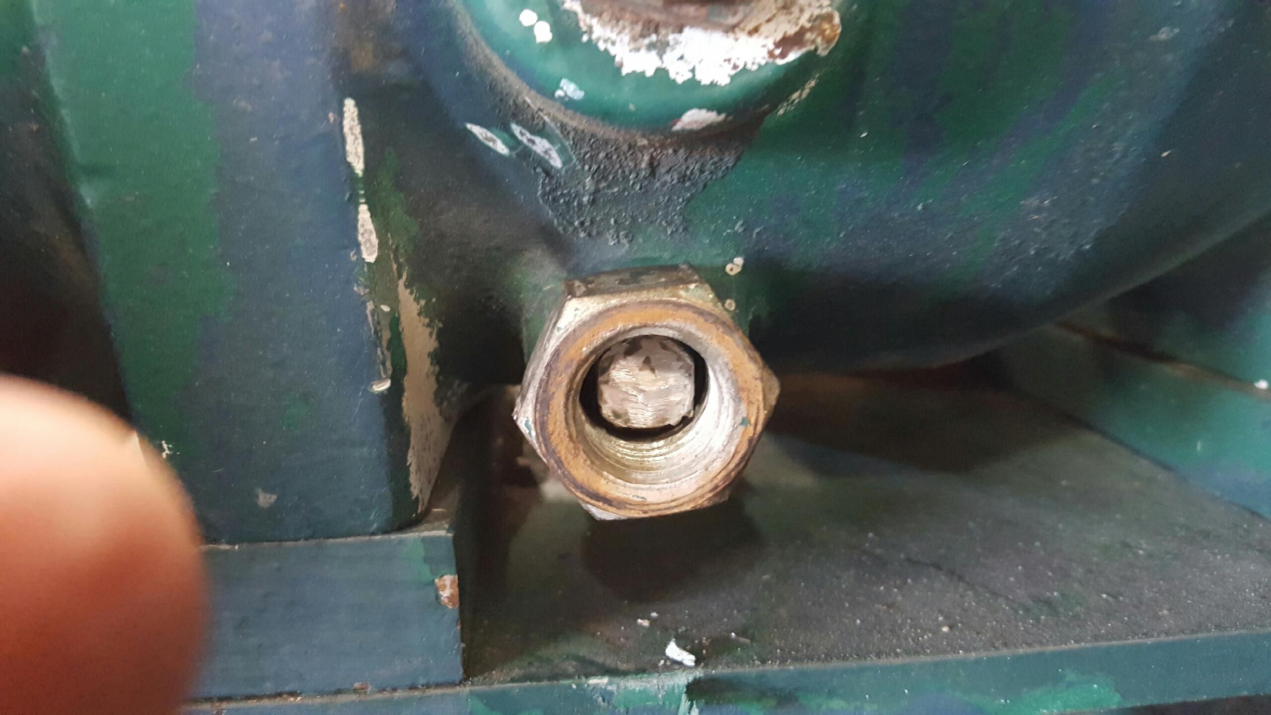

Something I should clarify, the plug isn't seized, it was over-tightened, massively. Malicious family members. Shed has been chained and locked to prevent further issue there. Head of the plug was stripped a bit as a result of the over-tightening and further torn up from me trying to remove it.
has me a little puzzled.
If someone wanted to sabotage the tractor by messing around with drain plugs, why over-tighten a drain plug that hardly ever needs to be removed? Surely, it would make more sense to sabotage the crankcase, or some other, drain-plug?
It might be prudent at this time to point out to those a bit less experienced with drain plugs that, if one removed the plug while the engine was hot, it is imperative that the engine be allowed to cool completely before replacing the drain plug. This applies mainly to tapered plugs.
When removing the plug from the hot engine, both the hole and the plug are larger than they would be when everything is cool. The removed plug cools quite quickly and shrinks in the process. The hole in the hot engine stays enlarged. This allows the cold, smaller plug to be driven deeper into the larger hole in the hot engine. When their temperatures equalise, the connection between the plug and the engine will be so tight that it can make removal of the plug extremely difficult.
I wonder if this might have happened with Kando's tractor.

It all depends on whether the plug is tapered or has parallel sides. To the best of my knowledge, most modern cars have drain plugs with straight threads, not tapered, and rely on a washer/gasket to ensure the seal.
In the days when I used to service my own cars (circa 1970's and '80's), the drain plugs tended to be tapered. They also had 'female' square heads, into which one fitted a 'male' square wrench - a lot like a grub screw and allen key arrangement, but square. Some cars had straight plugs with gaskets for the sump and tapered plugs with square holes for the gearbox and differential. large202908.jpgDrain plug key.jpg
The plug on Kando's tractor appears to be tapered.
I have never taken my car to a quick-lube place, so I can't comment on how they do things. Might they vacuum the oil out?
Another option, other than letting the engine cool, is to insert the tapered plug just tight enough to allow it to be in contact with the sump to allow heat to transfer from the sump to the plug. Once the plug has reached the same temperature as the sump, torque the plug to specs.
Do most tractor owners tend to drain their oils while the engine is hot or cold?
