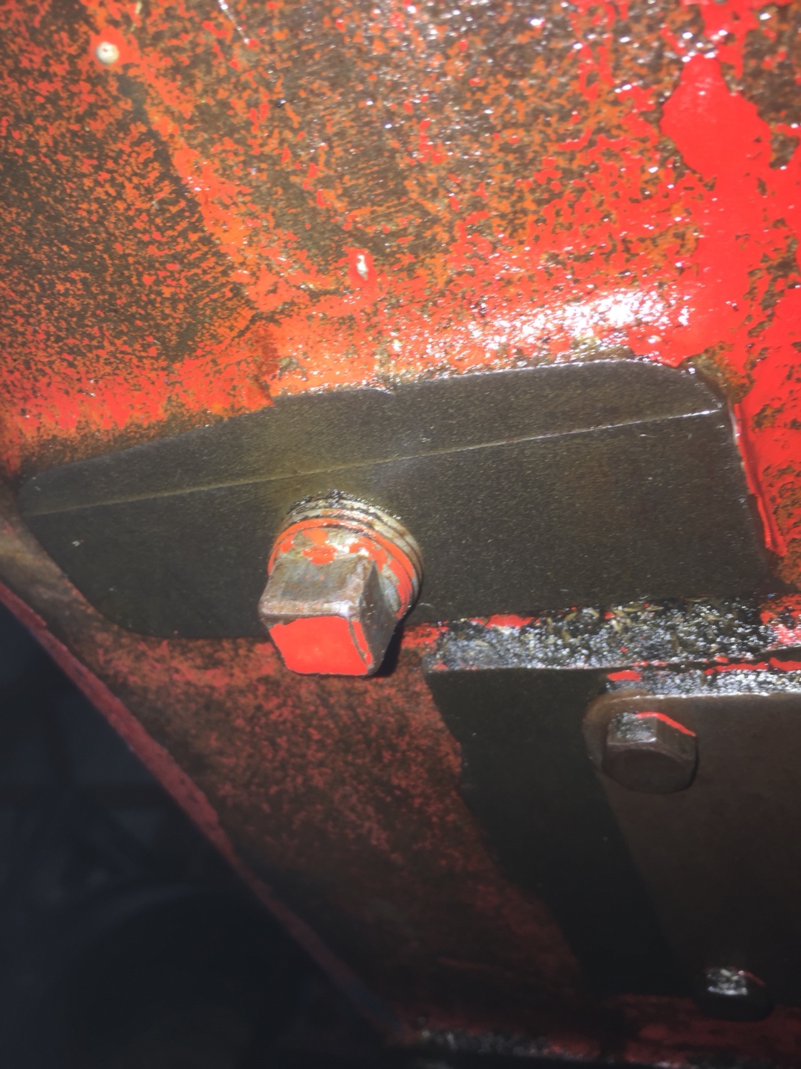

there's another method, spray liquid nitrogen Liquid Nitrogen Spray: Amazon.com on the plug only, that will make the plug shrink, and it may be removable then. being you only have 1.5" clearance to work, if this method don't work, be prepared to have to remove the transmission, you might have to just drill it out dead center, with the proper size drill for the tap, then tap it.. sometimes I drill a hole fairly close to the tap size, then cut very carefully with a reciprocating saw near the threads making 4 cuts, then, use a hammer and punch to knock those 4 sections toward the center, then they can be removed with needle nose pliers..
Before he removes the transmission, it would probably be easier to remove the crossmember and modify it so that it can be bolted back on.

All he needs to do is stopping his wrench from slipping down and of the plug . There is a crossmember to block the wrench from slipping down .

I think all it needs is to grab the plug by the threads with a good pipe wrench and it will come out.....but lets see how many pages we can get out of this first!

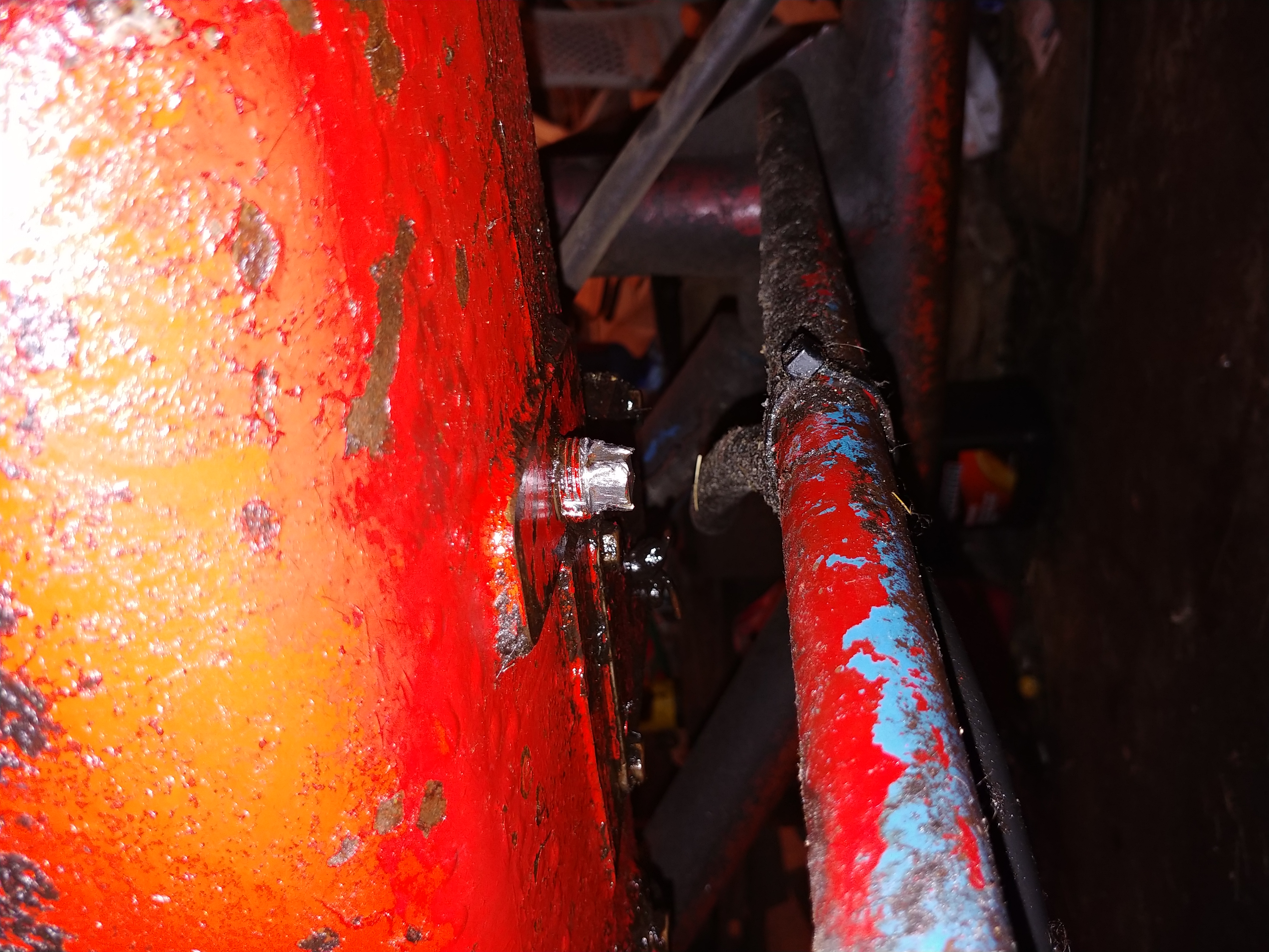

Here's the current state of the plug. That bar should be removable, bolt on each end. The loader mounts to the frame on the front under the engine and to axle on the rear, just a support bar I suppose. Johnkn, I've tried those extractors as well, although the one I tried was the one that fit in it's current state. Once I remove the bar I'll look into using the next size down, 1/2". Bolt head would normally be 9/16"
Lisle Corporation
With the bar removed would this tool be an option perhaps?
I have seen it used on tight studs that had not be removed in over 50 years with success.

I can't imagine why that didn't work, as a test, in a vise, I was able to snap a 1/2 bolt off with a 4 foot pipe wrench.. so... anyway, a drain plug just needs to be made snug, making it this tight is just not right, and not needed.. a bit of Teflon tape, or pipe dope could have been used if he had a leak.. or just spend a buck for a new pipe plug!..

It's all entertaining except to the OP who has to actually solve the problem. Dealing with a steel plug in an alum pan with only a couple inches of clearance because of loader mount hardware.

Then if it is so stuck and inaccessible, would it not be better to drill and tap a new plug?
