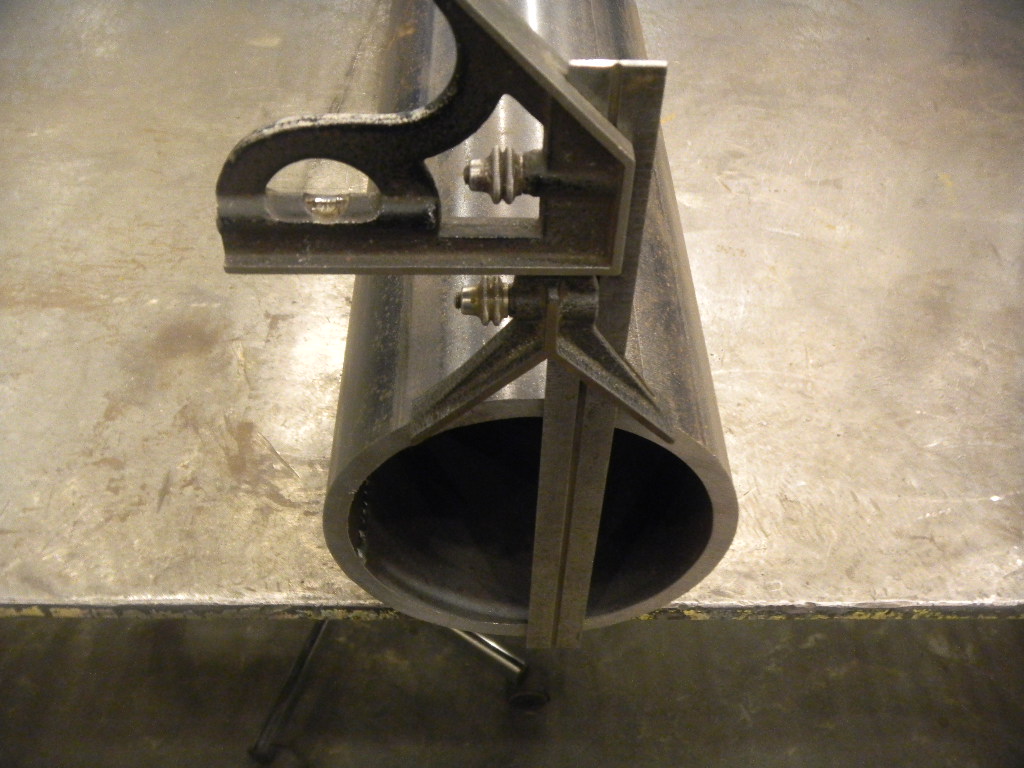

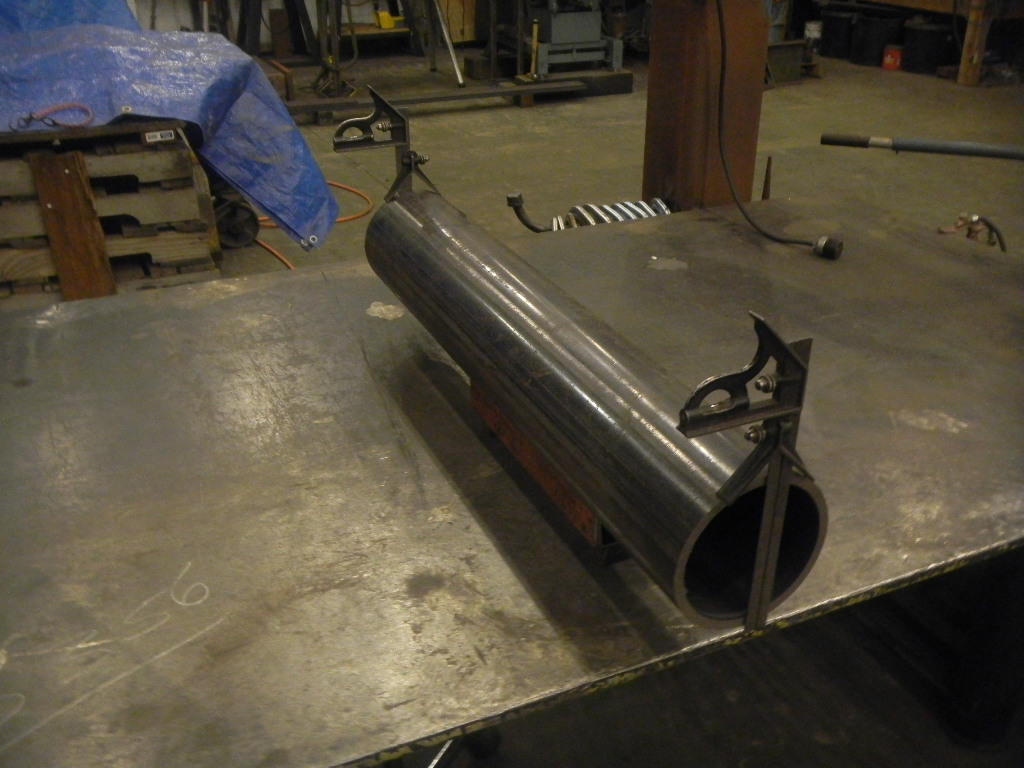

Here's how you do it when you don't have a big enough hole saw. ;)
