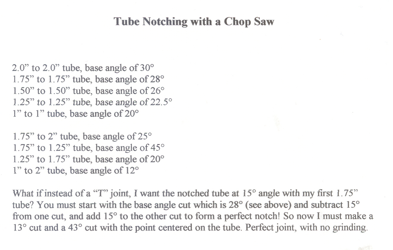

Since I welded up my trailer with round tubing, I spoke with someone (online or in person, not sure) and they told me about how to easily "notch" tubing with a cutoff saw, by setting it at "?" degree and cutting both side, and it's a near perfect fit. This is for a 90 deg angle only. Anyone know this trick and what the setting should be? I realize this is not a perfect deal but it has to be better than my last endeavor. I do not want to buy a tubing notcher, too slow.

try 45 degrees on some scrap and see how it goes.

I've never done it with a chop saw myself. A guy posted this.

Unless you think you'll never want to notch another tube get the Harbor Freight notcher. I think they do up to a 2" pipe. I've used mine for building roll cages and other pipe projects. I just clamp the notcher in a vise and use a 1/2" drill. It can do angles past 45 degrees. I've tried pretty much every other way, from using a cutoff saw to a 4 1/2" grinder and they always left me trying to fill a gap. The first weld I did after using a notcher was a "why the f&*# did I wait so long" moment.
