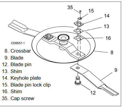

hi folks..gravelman here..im thinking of buying a Kodiak 5' HD rotary cutter... any advice or info out there. I need an easy to change blade cutter...getting too old to be climbing under stuff. thanks
Kodiak, or any of them, do not require you to go underneath? How's it work?
The Frontier I have is MUCH better than the LX-4 was. The stump jumper stays in place. You access the nuts like on the LX-4: through a hole in the top after the tail wheel support is removed. Still gotta go underneath to put the bolts and blade back in place.
Torque on most of these is 450 ft lb. I just use a 6' piece of pipe over a 3/4" wrench handle and push as hard as I can. Figure it's pretty close to that, e.g. probably around 80 # on 6'.
