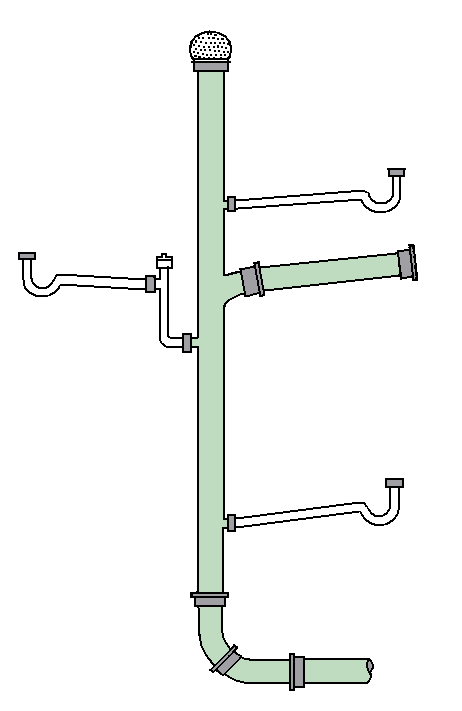

My question is re the gasses. if you refer to the humidity i agree but again, the nasty gasses from the kitchen or bathroom are trapped by the.....P trap? No?
No, the P trap stops the gases from getting into the house, but the vent lines are clear all the way to the septic tank, or in town, all the way to the manhole.
A quick search of images found this picture. You can see how the trap is close to the sink, or whatever you are using. Then it flows into the main line. The main line is open from under the house, to above the house.

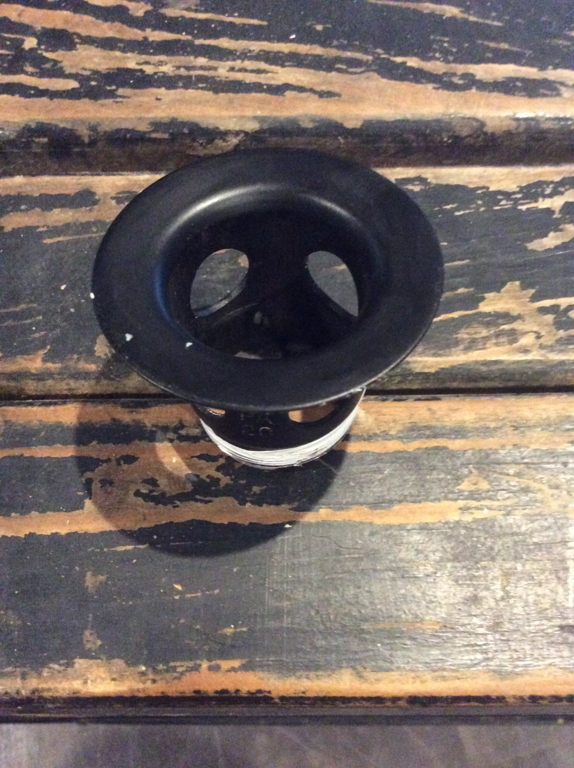

Now, if someone can tell me how to keep the flange in the sink from leaking. I've tried everything except what the instructions suggest! Plumbers putty, various o rings and flat washers, even caulk. All 3 of my bathroom sinks leak down past the edge of the flange.
The pro plumber installed 1 sink about 1 month ago. I checked yesterday. His install does the same, sink won't hold water, leaks around the edge of the flange.
Today i buy what the DELTA instructions suggest, silicone.
Man do i
hate plumbing!
/ Roofing discussion!!! #120
When I put in a flange in a sink, I use 100% silicone caulk/sealant. It's the only thing I use 100% silicone for. Also, keep in mind that if you ever have to re-caulk something with 100% silicone, all the old stuff has to be removed mechanically (i.e. sandpaper) it does not stick to itself. I do not reuse anything that's had silicone caulk on it unless I have to.
When you put the flange in, once the sealant is in contact with both the flange and sink, twist it a little to be sure the caulk does not have any gaps in it. (just like you do with PVC pipe fittings)
