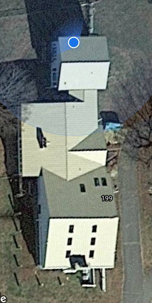

We went with standing seam steel for our hill top home. Got tired of losing shingles to the wind. The old roof had been patched multiple times by the previous owner. Got a quote for $50k for 70sq of roofing and jumped on it.
As in, $50,000 for a roofing job?
Jesus Christ. I could have a "normal" roof redone 10 times for that, which is enough to cover 150-200 years worth of time. How long are you planning on living?
/ Roofing discussion!!! #68
Went with standing seam metal for many reasons. Insurance quote for asphalt shingles was $25k. I seriously doubt you could do 70sq of asphalt roof including 9 skylights and 900' of gutter for $5k.

Pic of my roof
