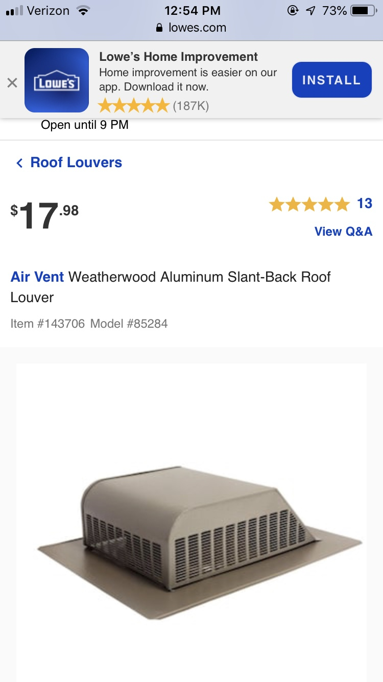

I’ve had better luck with these boxes vs rubber boots. I’m wondering if tge inspectors would allow the pipe to be cut short and put one of these over it .

I’ve had better luck with these boxes vs rubber boots. I’m wondering if tge inspectors would allow the pipe to be cut short and put one of these over it . View attachment 707731
For a plumbing vent, that would NOT meet code anywhere!
I agree it probably wouldn’t but I don’t see any good reason why you couldn’t put the pipe through the roof a couple inches and stick that over it.
/ Roofing discussion!!! #92
Perhaps not in TN, but in many areas of the USA, winter snow would seal off that vent.
