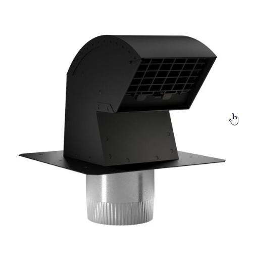

attach is one example, I like the length from the exhaust to the roof on this one but see your hardware store look at your options as long as they have a back draft damper, a screen so nothings goes in and a decent pipe diameter. (at least 4'' diameter) Use hard line pipe and not flex pipe as flex increase resistance.
I don't know your house configuration here but if its a finish house the roof might be easier to install you simply have to cut the hole through the sealing to the addict then through the roof and shingles and you just slip that in. for the wall you might have to deal with fitting it under the siding which can be lots of work … but you also could bring it to the addict and pipe it to a gable which could be easier then the wall … but again the major components for resistance are diameter, distance and corners. Resistance = less airflow...
This option is too complicated. You can do it much faster and easier, as the guys advised.
