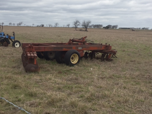

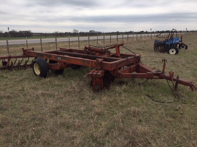

Does anyone have any experience towing a Miller SJ1 disc behind a 3/4 ton pick-up? It is too wide to fit on a trailer with out a permit. The gangs are 10 ft. wide, and the overall length is about 18ft. I have read about attaching a chain to the tongue of the disc, and then attaching the other end to the side of the frame. Attaching a chain like this does not sound like it will help much, but I have not tried it. I would think max speed would be 25 mph. Any other advise? thanks, Carr

I pulled the trailer to my ranch on Friday. I bought two new tires, had the wheel bearings and races replaced and reassembled. Toungue weight is very heavy. Overall, the disc pulled pretty well. Thanks for all of the help. Carr
