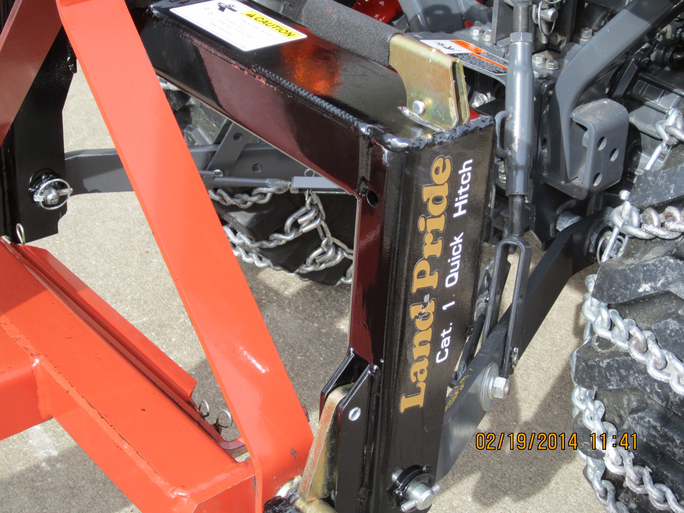

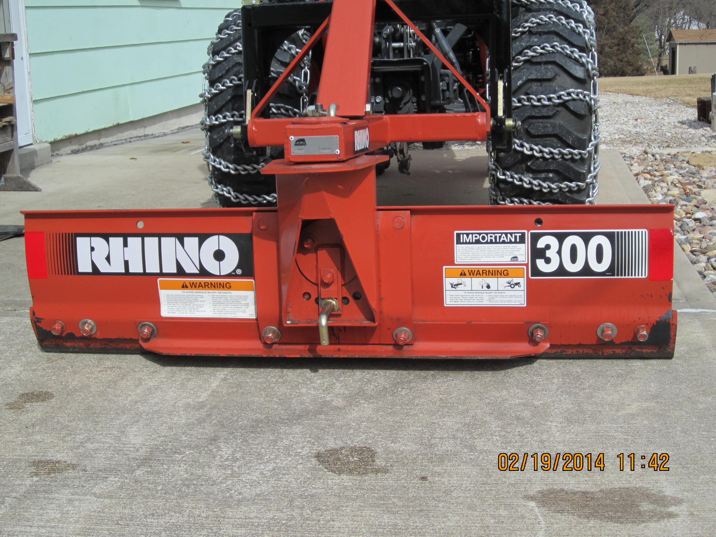

oosik, Big tasks require big machines.....I'd love to sit in that tractor/setup and work it.
Here's what my little Rhino looks like...........and Yes, "Hydraulics" would make it all go better I suppose.
Cheers,
Mike

I got the Model 850 (8') version.
For me having 2 hydraulics (tilt and angle) was a must. Though I realize that for snow, and some soil scrapping jobs, letting the 'tilt' float (when not on flat pavement) lets the blade do a much better job following the contours of the ground at the blade rather than pitching with the tractor (and the ground ahead of the blade).
The other handy thing about having the hydraulics is when hooking it up, You only have to get one tractor link arm close, and then plug the hydraulic hoses in. Then I can align the blade's frame up/down or left/right with the hydraulics (i.e. with it unconnected to the tractor, the hydraulics move the blade's frame, not the blade itself. No man-handling required). - Or you can just get a quick connect system.

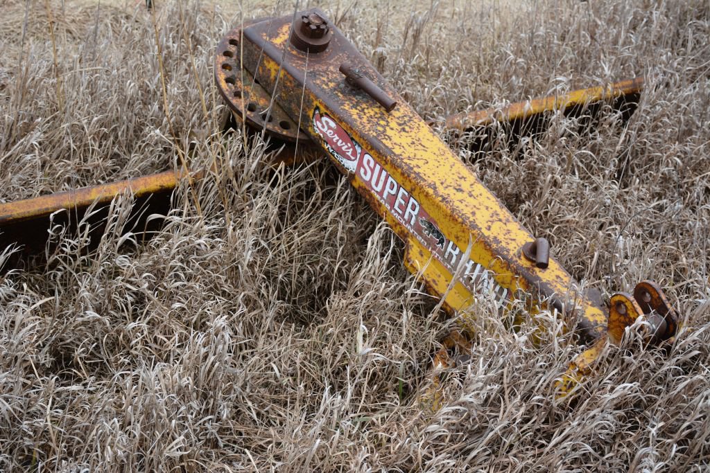

Very nice scrape blade oosik...
I took the liberty of lifting a picture of an older Servis Rhino Utility Blade...
My dad bought one of these years ago back when he sold tractors and implements...
I think that he got it in the late 60's or early to mid 70's...
It is 8 foot and has cat 1 & 2 hook up...
At the time we used it on our old D17's...
It works well with my Workmaster...
I've had numerous opportunities to sell it but I have no reason to let it go...
You will get many years of service out of that blade...
Excellent units...
