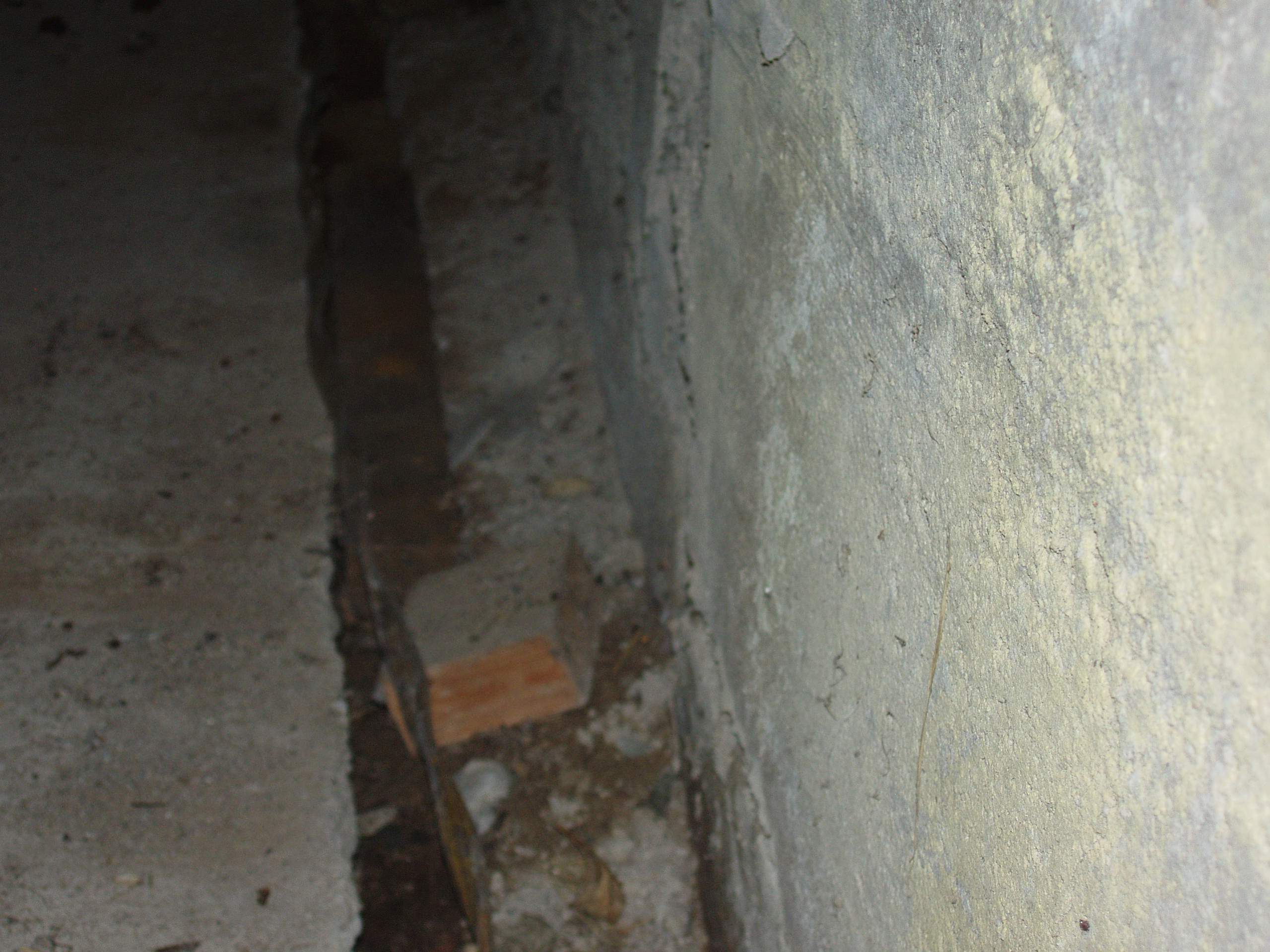

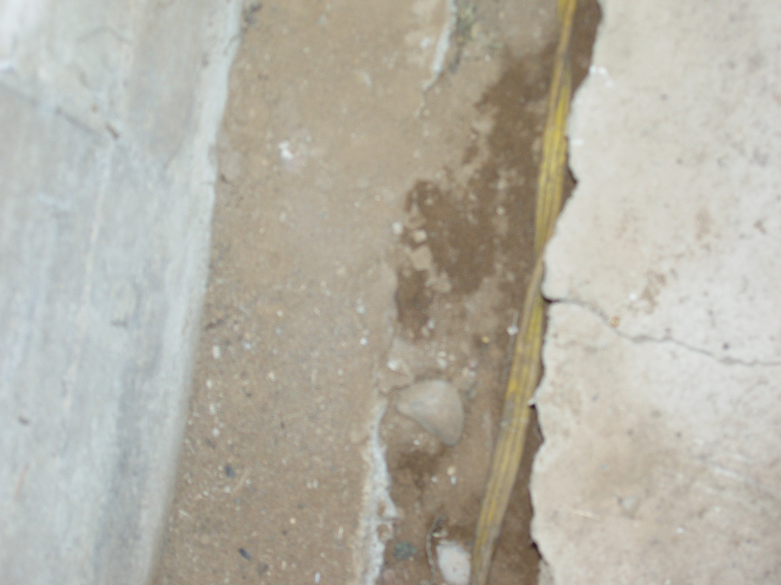

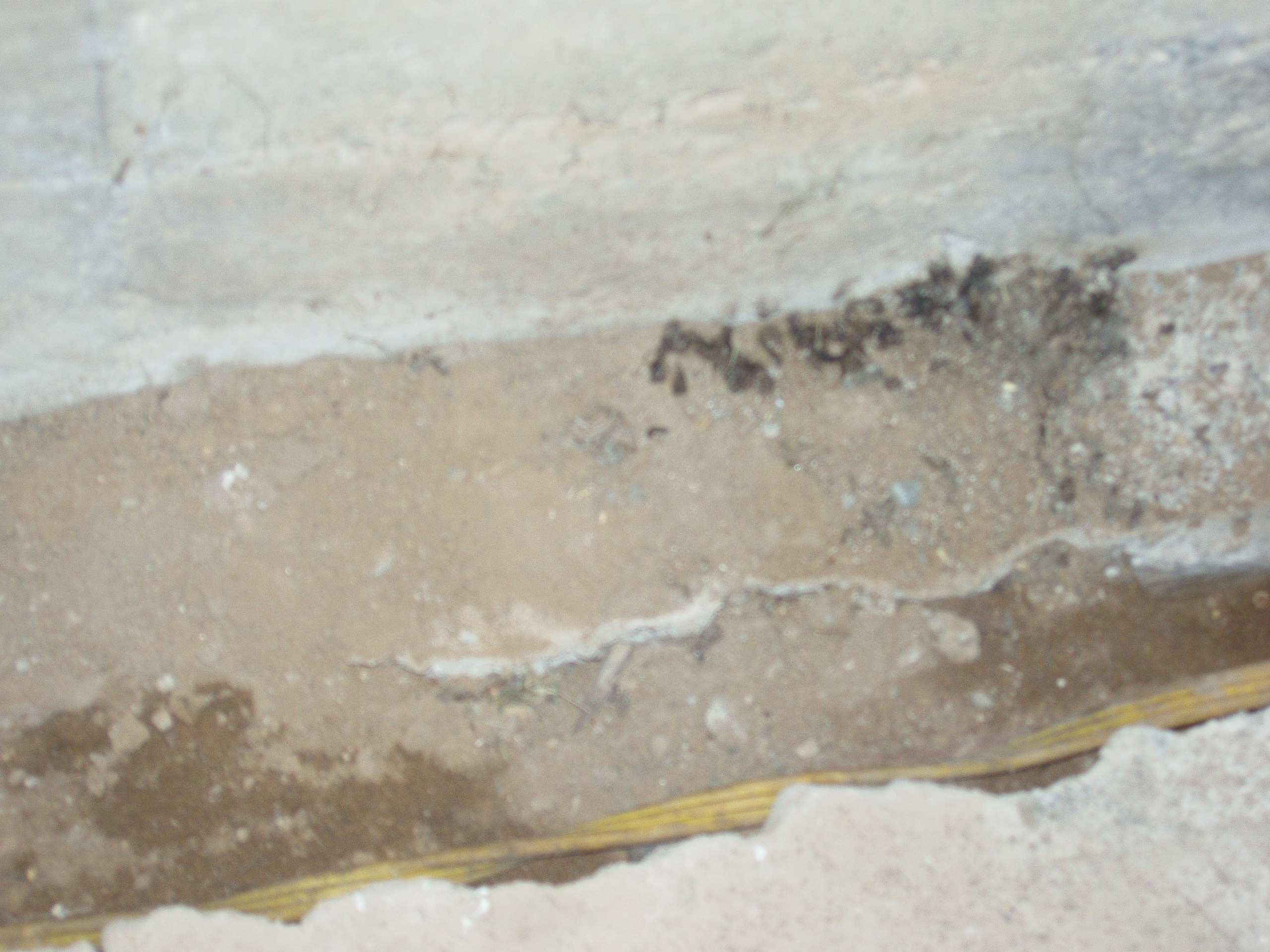

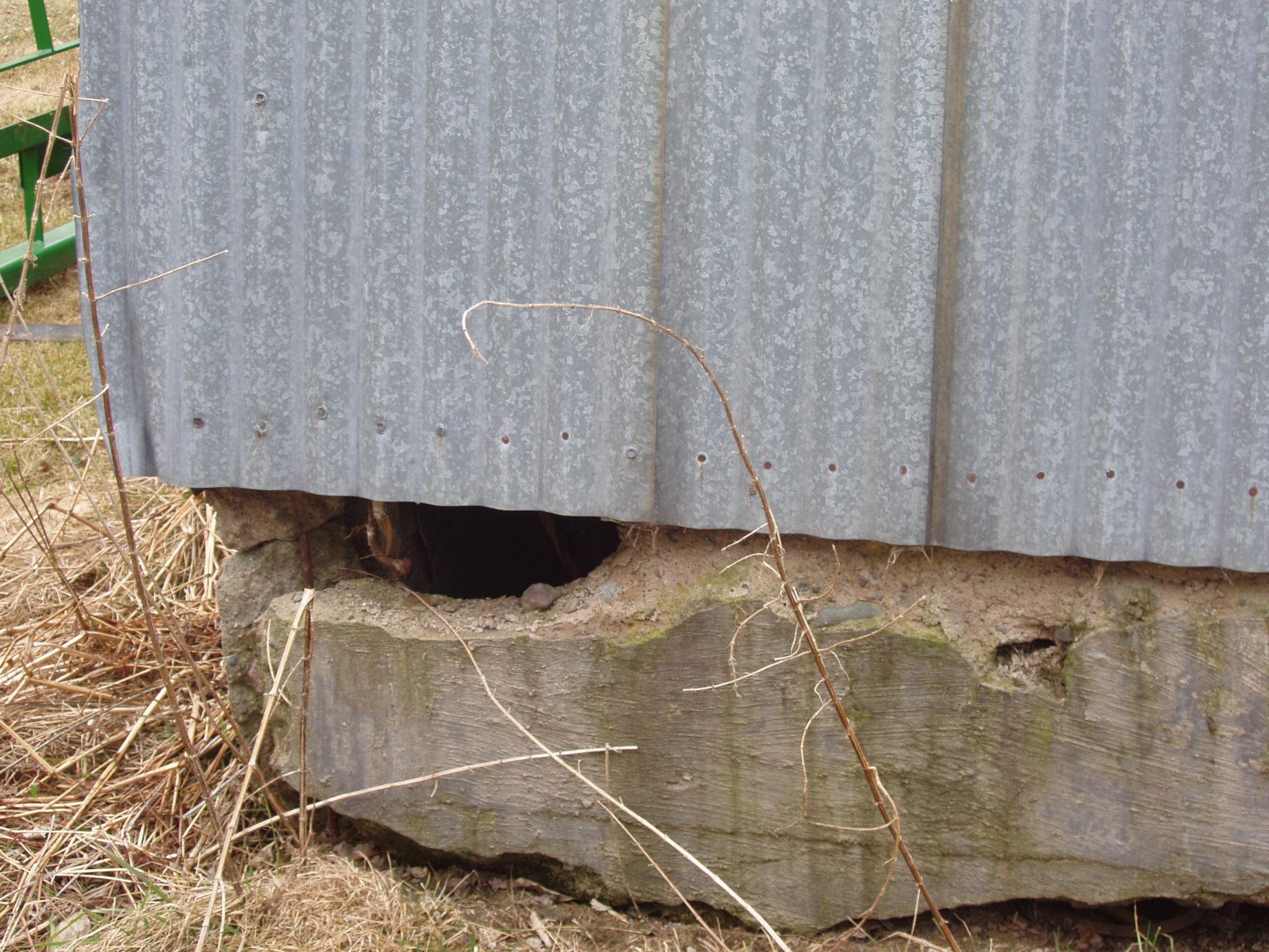

Here are a few pictures to help show it. The picture of the corner is the worst. the rest of the wall is for the most part not crumbling just vertical cracks.

Looking at the first picture of the corner of the building, the concrete itself looks like it is weathering away. Is the concrete solid or do you think it will break up pretty quickly with a demo hammer?
Then you get into the question of what it costs to pour all new concrete to the proper width and height versus putting up a pole barn that doesn't use as much concrete. Then if you can re-sell the hut to recapture part of your expense, then that maybe points to a new pole barn. Would a new pole barn be more functional to your use?
/ Repair foundation or replace building
#16
I think it will break up pretty quickly. I will just need to cut off the J hooks and either pull it out or break open a crack. I'm not too worried about getting the old concrete out.
