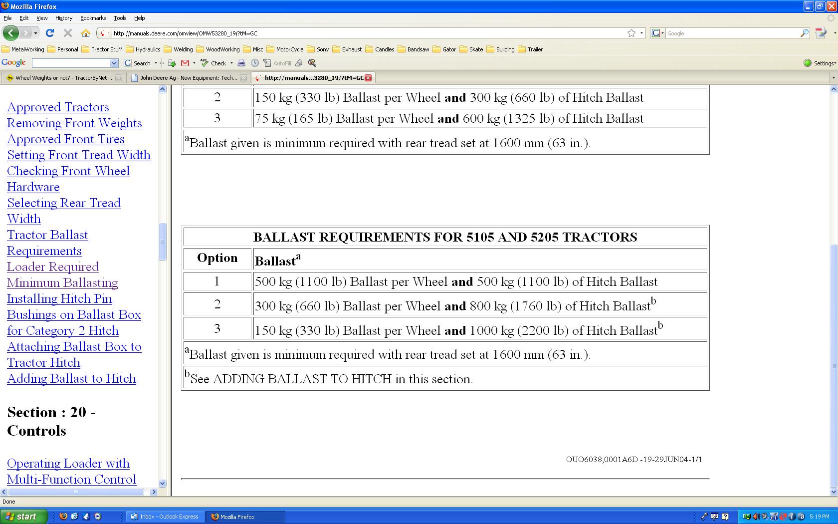

I live in South MS where the temperature seldom gets below freezing for very long. I have recently added a FEL and was pondering the idea of adding more rear ballast. I have had no problems when using with my MX6 attached, but expect a drastic decrease in traction with it removed. By way of the internet, I have determined that my 14.9-28 tires filled with straight water weigh about 442 lbs and filled with Rimguard would be 567 lbs. Looks like it would take 53 gallons per tire. I have had some spinning/loss of traction when pulling a heavy disk too. Thought about adding wheel weights, but the only source I have found so far is the dealer and they are pretty costly. The difference in Rimguard is about equal to one set of wheel weights. Two questions: #1 wheel weights or Rimguard, #2 is either one worth the cost...will I see a noticeable improvement in traction?
