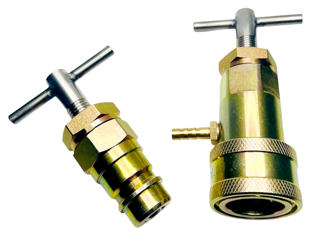

I had similar issues last year when taking the grapple and FEL cutter off in cool temps and trying to reconnect then in the afternoon when it was 90°+
I tried most of the above mentioned tricks, but most of the time I was either having to crack open fittings a bit or use the hammer method to relieve pressure.
I finally broke down and bought these pressure relief tools, no issues since (not for everyone and I know this is a love/hate topic, but I'm lazy) 😎

Even though I don’t have the same issue, this with no doubt would work. This will drain most of the oil out of the cylinders so it can’t build pressure.

Got a set of those, myself. I would recommend them.
