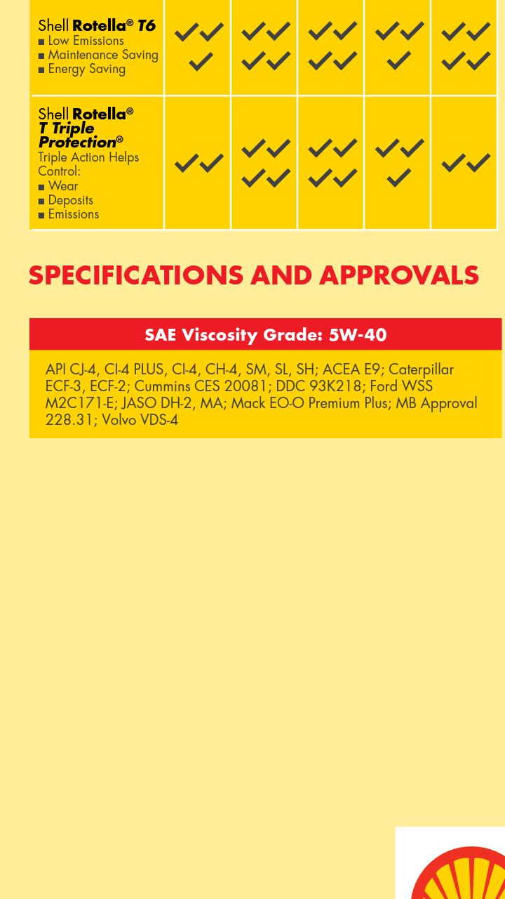

Rotella T6 5W40 is JASO spec oil, makes it wet clutch friendly.
JASO is all you need to look for on the bottle.
