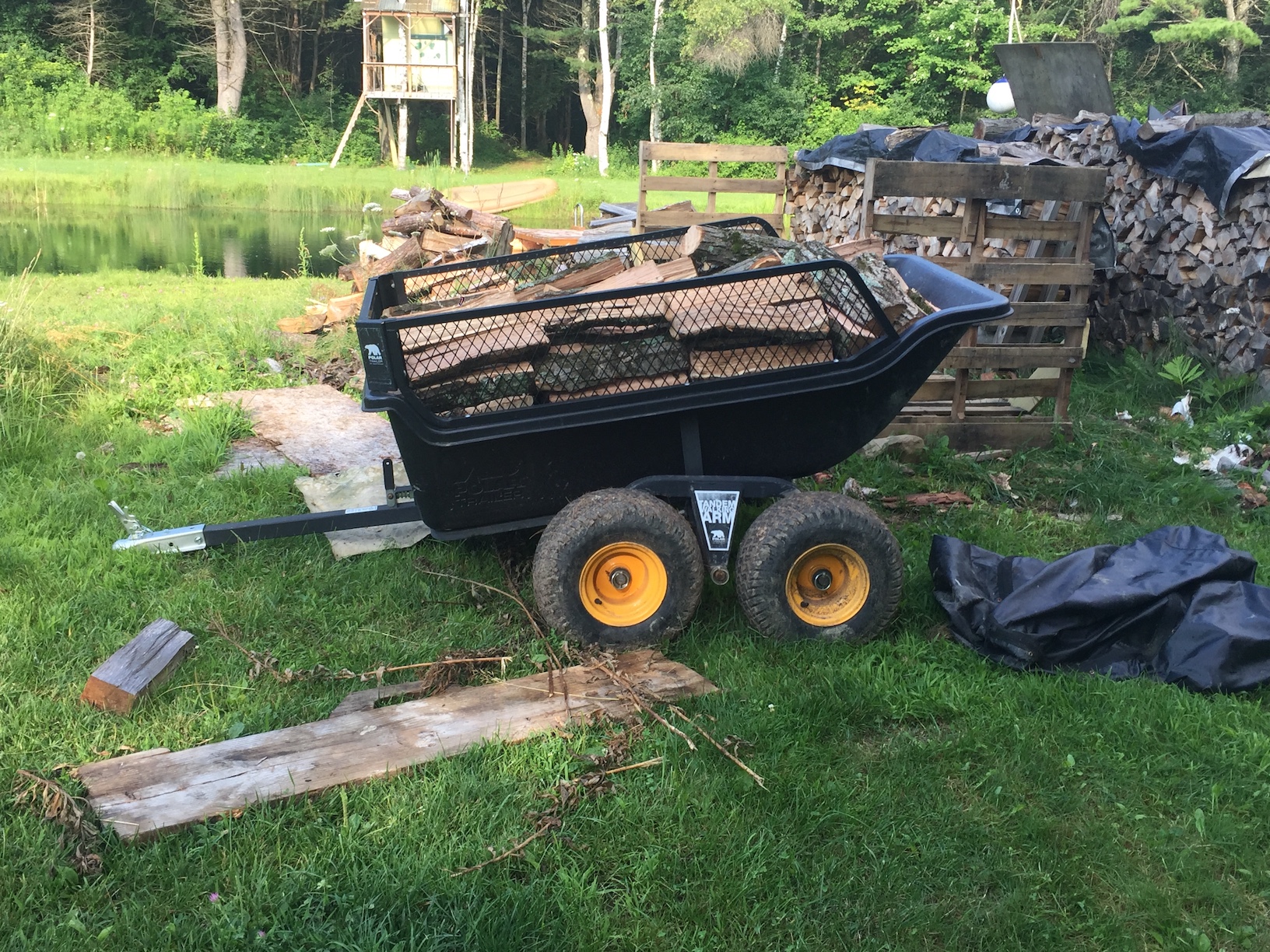

Your recent posts have been interesting because I've never seen the tandem Polar units except on video or website - the stores all carry the single axle choices.
1. What I knew when I purchased 2 years ago - was that I could upgrade to the tandem option which as yet is not needed at this time. But better understanding how it works is often great fertilizer for new thoughts :)
2. That I needed to create some better method of switching hitch methods - when I flip flop from scut to lawn tractor use with the trailer. Looking at the Bannon and then looking at your unit pictured - has now given me that concept I could create.
3. I've now come up with an idea to enhance the one flaw I hadn't considered when first buying - the desire to have the unit as a stand alone unit for various purposes (like with my scut and bucket or grapple or forks.
4. I'm also now thinking how I can adapt a method of "quick attach" for the optional side rails I got for the unit originally.
Its funny how inventing or creating ideas sometimes is often a process of "distracted dreaming" LOL. I find lawn mowing has always been a very healthy and fertile method of creating new ideas and perspectives. :)
And I don't even have an atv or utv yet LOL.

Non-welders are in the majority of the worlds population so that's not a problem Joe.
I looked at the vid - The tandem wheeler looks 'flimsy' to me. And the thing you need for a Log-Splitter is a strong chassis.
The dual wheels concept is a budget way of increasing load capacity on the axles.
Yes, you will tear your turf when turning the tandem and carrying a load.
Try looking at your local Agricultural supplier (Farm shop) for ATV Farm Trailers. These are often galvanised steel with wide tyres (I can only describe them as similar to a Golf cart size).
I ended up switching my Polar from the pin hitch to the optional 2" ball hitch. The pin did not work well with the draw bar on my tractor. I don't use it behind my tractor much, since it's too small to be a good match, but it's nice to have that option when you need to. The ball hitch just bolted on, and is easily removable if you want to go back to the pin hitch. It would be great to have something that could be switched with no tools, however. I've added a 2" receiver to my logging winch, and will probably add one to my box blade so I'll have hitch capability without removing my commonly used implements.
I've wondered about change my side extensions to be easily removed - possibly held on by pins. However, I think they'd lose a lot of rigidity if they were just pinned on. The other thing I had thought of was something like a piano hinge, so I could fold the sides down for easier loading and unloading. Then I thought about a pin hinge, so I could fold down or remove completely without tools. That one still has me thinking - I'd need to put some sort of keeper on the pins, or knowing me I'd be losing them daily.

I have to apologize for an omission in the descriptions I gave on the polar trailer.
Everything I stated on capabilities and capacities of the 1200 and 1500 pound capacity models was correct and accurate.
Built I forgot to mention a feature many may find useful as I have. The Steel frame structure has one other feature that is especially useful when moving the cart into dumping position when backing up. The frame has a built in pivoting side-to-side joint that allows you to back at angles to your atv/tractor/mower. In other words . . . It's double jointed. 1 joint is the normal pivot point where trailer meets atv/tractor/mower. But the 2d joint is about half way in the middle of the trailer.

I bought the 1500 Polar trailer 8 years ago and it has held up well with a lot of abuse. The original tires were terrible but, as they are golf cart sizes, better tubeless replacements were easy. Switched to a 2" hitch right off to be compatible with everything else around here.
As for the dump feature, the geometry isn't right for unloading stuff but works well for loading stuff with wheels.
I've used mine alot for hauling firewood, tools, and construction stuff but not so much for brush & cleanup work as it quickly fills.
For cleaning up deadfall, limbs, and brush, I use a 5x9 tilt trailer (all welded with expanded metal floor). That thing you can really load to 8 feet high and wide, strap down the load, and waddle off to the brush pile.
So that justifies keeping both...
