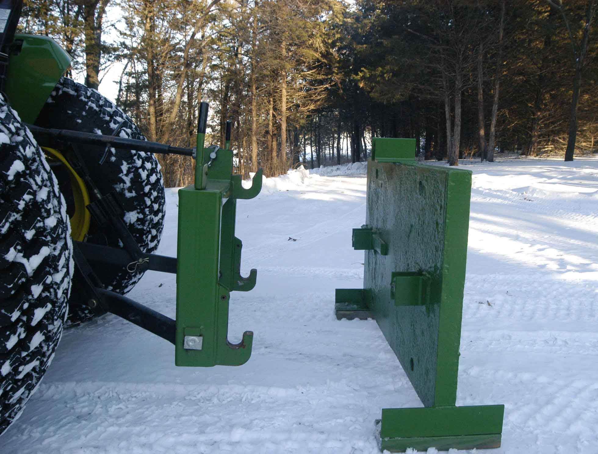

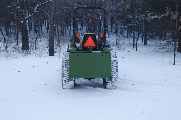

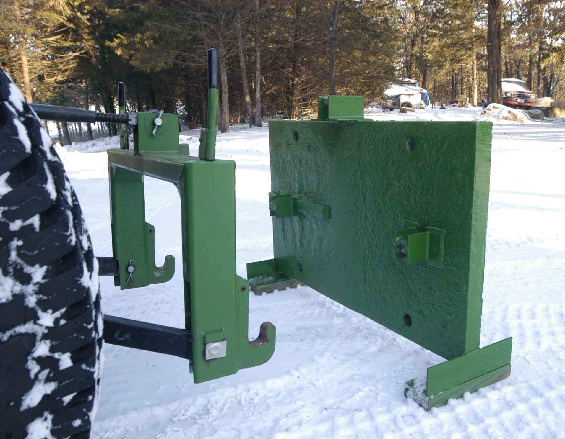

I'm going to be making another weight tub soon, for my ford 951/loader.. and i think I will add in some pvc sleaves for shovel handles, as well as a metal plate onthe rear that i can slap a trailer ball on.
