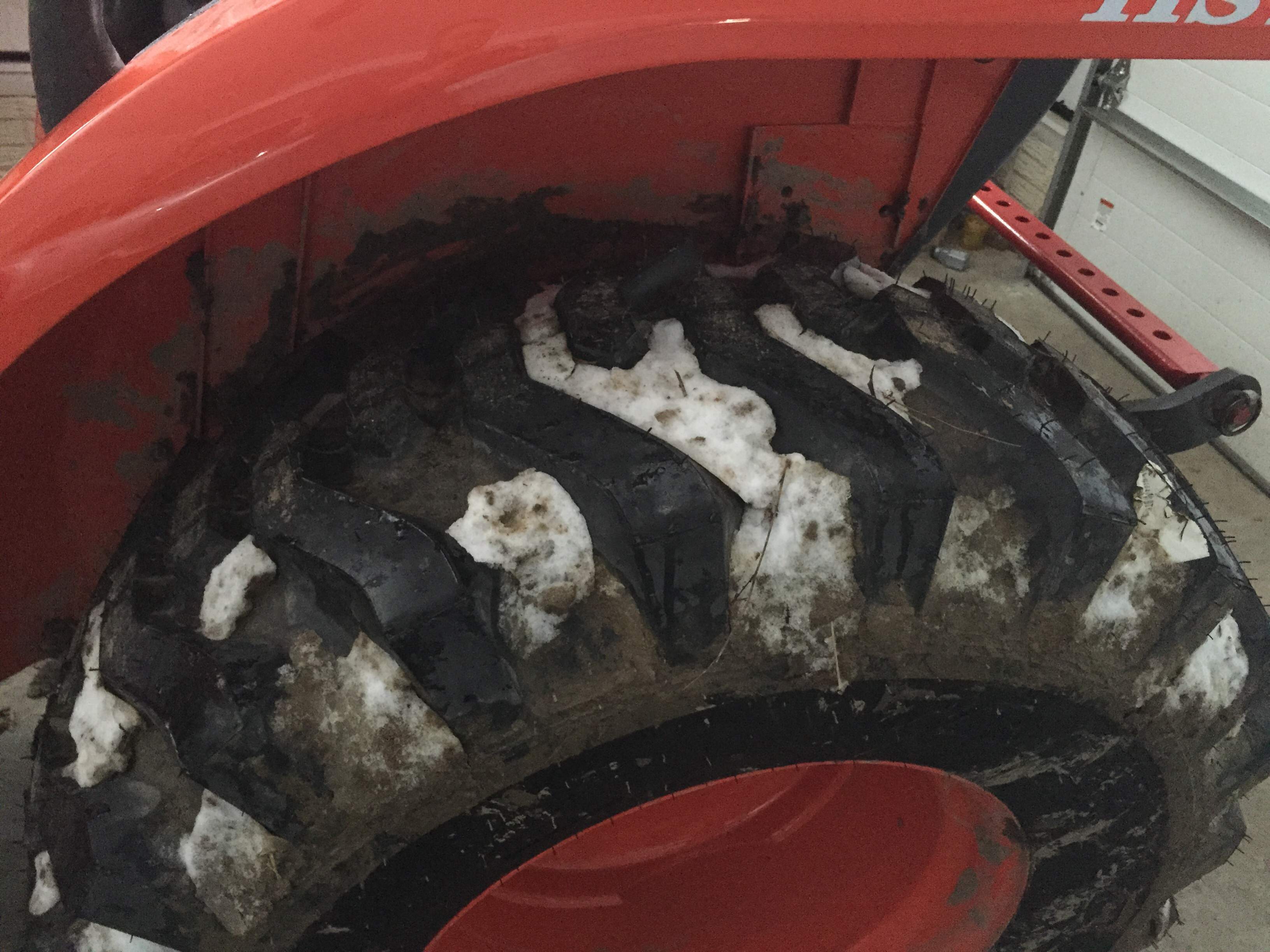

vtwinhd, do you have ag tires (R1)? If you have a photo that you can post, might help. If you have the industrial (R4) tires or turf tires (I think) you are out of luck and need to buy wheel spacer that go between the wheel and the tractor. (~$380+/-)
/ Rear tire stance adjustment
/ Rear tire stance adjustment #7
Those are R4, industrial, tires. For a wider stance, you'll have to buy spacers. The Grand "L" have R4 rims that are adjustable but not the basic "economy" tractors. You can look up some of those threads... spacers usually tied with tire chains.

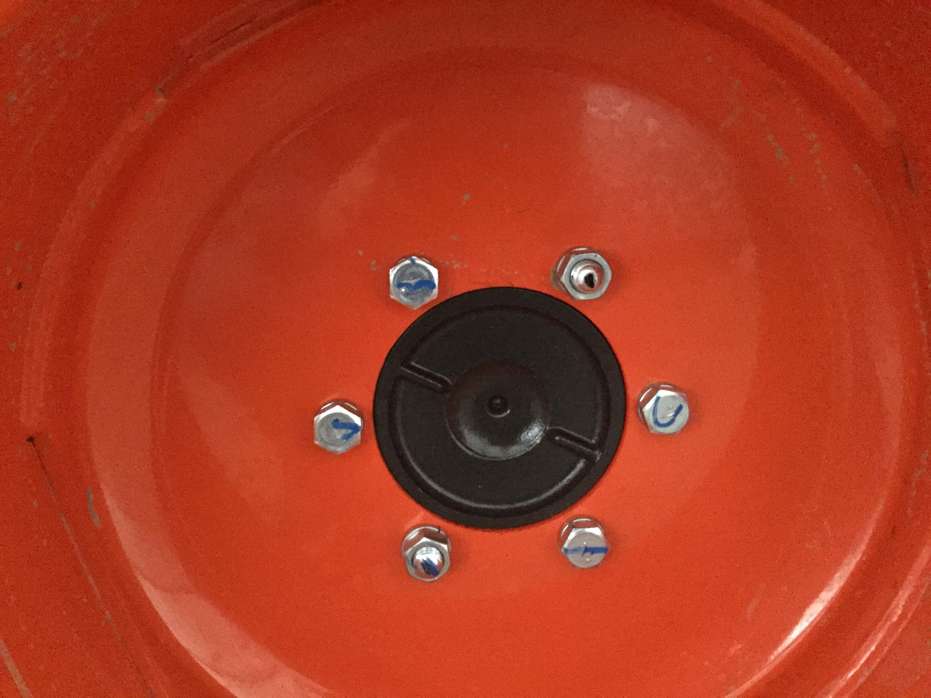

/ Rear tire stance adjustment #12
teg - what are you saying? That the rims used for R4 tires(industrial) do not have the provision to reverse the inner dish?? Or that R4 rims do not have separate inner dish and outer rim??
/ Rear tire stance adjustment #13
For his (and my L2800) "economy" tractors!!! It's one unit, look at his first photo, the "inner dish" is welded to the outer section. It's a solid wheel. My friend has R4 on a Grand L and his wheel is two sections, inner and outer parts that can be adjusted.
EDIT: you can see the welds in both photos...
/ Rear tire stance adjustment #14
Yes, now I see what you mean. I've been told my rims (R1 rims???) are not the correct design to support the outer bead on a R4 tire. If I wanted to go to R4 tires I would also have to get new rims. I thought about at one time but after checking the R1's are best for my needs.
/ Rear tire stance adjustment #15
Those welded rims are same as on my B26. They are at their widest and ONLY position. If you tried reversing them, the tires would hit the fenders. Only way to widen is with spacers OR replacement of the rims with two piece rims. I don't know if something like that is even available for these tractors.
