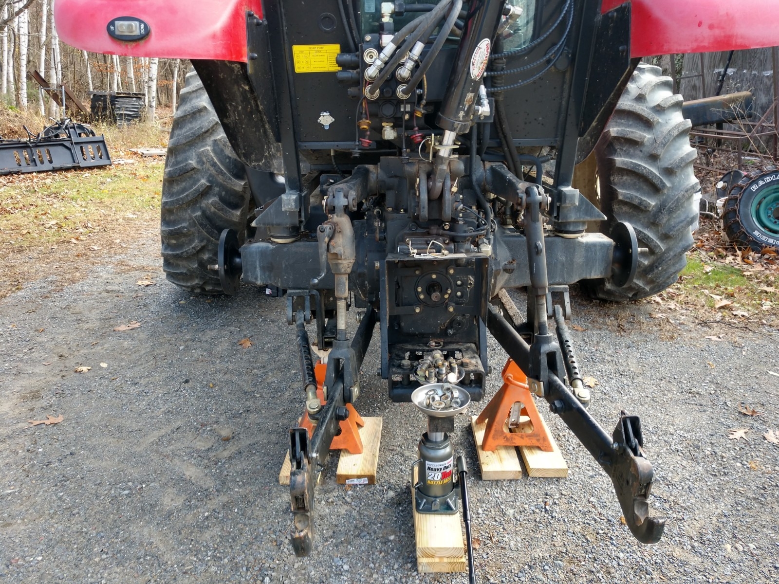

I like the jack stands, and use mine always, but it is sort of scary to have the back end supported by a single bottle jack while knowing the front axle is on a pivot pin
The jack stands are under the loader sub frame which is fastened to the rear axle. The jack is just sitting there waiting to be used.
/ Adjusting Wheel WIdth? #22
I could tell you did it right, 'just making comment.
I also use the front wheels to support the rears when they are off.

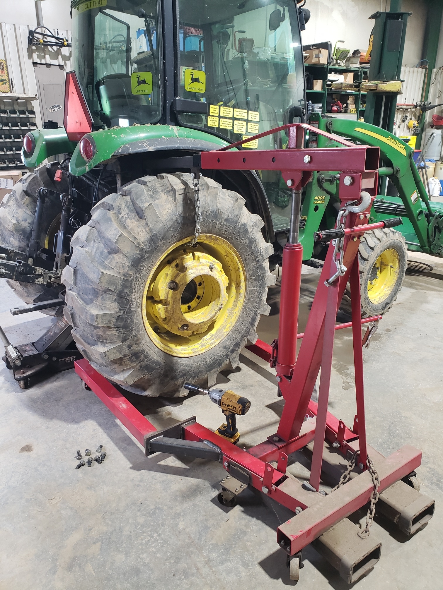

I'm 82 I moved my rears out 3" on each side with only my CC. It took one young man (My guess is he weighed 130#) 20 minutes using his truck-mounted crane. Bill_$100, as he was already here to fill the tires with WW fluid.
