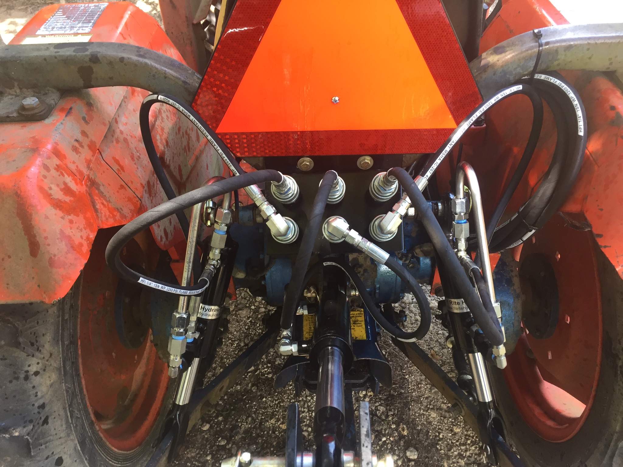

It's very frustrating. I went thru it a few years ago. I never found a solution. I've had my hydraulic top link for 7 years I think. It operates today exactly like it did 7 years ago. Acts exactly like yours.
If I want precision control I extend/retract a couple times and then it's solid for awhile with short movements. Then for no apparent reason the air is back. Both of my tractors act the same way.
I tried switching rear remotes. 3 on the Kubota, 2 on the Ford. No difference.
There are several members here with the same problem. Most, like me, just deal with it. Some give up and go back to a mechanical top link. I won't ever go that route.

I cycled it again a few more times. Then connected up the top link to the 3 point. Lowered the 3 point onto the ground with the top link ram nearly fully extended. The top link ram only moved in about 1/4 of the way in so I thought I was winning but realised I had not lowered the rake onto the dolly and the tines were digging into the concrete so raised it and put the dolly under and lowered it again. This time it went about 1/2 way which was the best so far. I then decided to try bleeding so I removed the hose from the tractor going to the “ blind side” ( opposite to rod end ) Because this type of coupling caps both ends when removed I then released the pressure on the ram by pushing in the ball bearing on the hose and allowing the fluid to run into a container ( after the initial high pressure squirt) . There were signs of air . Refit hose and I cycled a few more times with the rake attached. Lowered again and ram this time was worse, about 3/4 in so bled again same as above. There was plenty of air so expected good results but after another few cycles lowered it slowly and the ram still went in 3/4. After being spayed with oil and all over the floor decided to leave it overnight with the rake down on a dolly and pressure left on the ram. I took a measurement of 90mm of ram out and will measure again in morning.

This is my opinion on what happened. When you connected the hose back after test a little air was introduced. Then when you cycled the cylinder with the rake connect, the weight of the rake caused system to pull more air each time you extended the cylinder. It appears to me that extending the cylinder with weight allows the system to pull air.
When you tried to bleed the hose by pushing in on the ball more air was introduced. The bubbling was from air going in, not out. Then more cycling with weight pulled more air.
Leaving the cylinder under pressure over night you will certainly see it goes in a good bit because of internal leakage of the remote valve. This is normal on most valves and some are worse than others.
Do you have a front loader? If so, have you had any issues with it?
Again, just my opinion, but I think something is going on with your remote valve. If you have a friend with a tractor that would not mind trying the top link I think you would see it perform differently.
My procedure using what you have would be cycle the cylinder before attaching the rake. Then don't touch the remote valve. Attach and lift the rake with 3pt and go to the area I was going to be working. I would then lower the rake to the ground by lower the 3pt and then adjust my top link. As long as the adjustments made on the top link were with the implement on the ground, I think it would work.

I use a Land Pride rear blade on the Ford with three circuits ran off two tractor circuits. The top link being one of those. I've tried it on both of the tractor circuits with same result.
On the Kubota I've swapped the top link to each of the tractor's three circuits with the same result.
In my efforts to resolve my issue, your statement above is my conclusion.
If it's valve failure, I have 5 bad valves on 2 tractors. I struggle to believe that.
