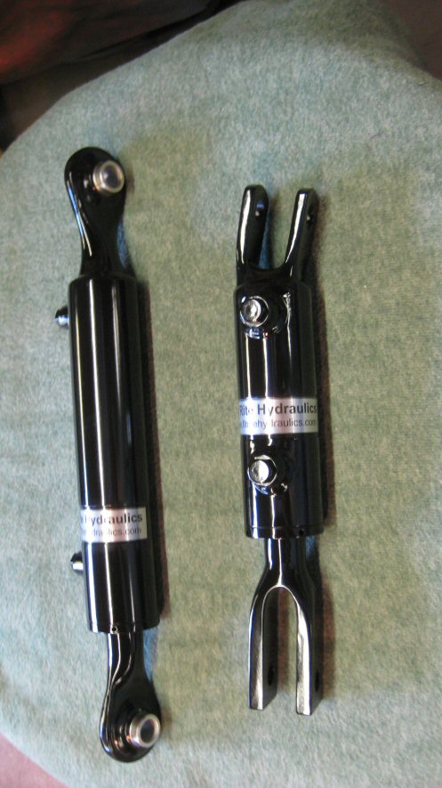

In my efforts to resolve my issue, your statement above is my conclusion.
If it's valve failure, I have 5 bad valves on 2 tractors. I struggle to believe that.
I have to agree with you. Highly unlikely all you valves are bad. If they are, you should buy a lottery ticket! Also, being one of the smartest guys on this forum, if have not found a solution, likely one doesn't exist. The solution is going to be the best work around.
The question we don't know the answer is if the OP situation is worse than you and others are experiencing? Seems like he is getting more air than most.
With respect to your other implements, the more I think about it very few applications are like the top links.
I am not sure if I have adjusted top link with the implement off the ground. Probably more of habit than anything because all the years of manual top link adjustments. I always did those on the ground because it is easier. I guess I could try it to see if I get a similar result.

This is my opinion on what happened. When you connected the hose back after test a little air was introduced. Then when you cycled the cylinder with the rake connect, the weight of the rake caused system to pull more air each time you extended the cylinder. It appears to me that extending the cylinder with weight allows the system to pull air.
When you tried to bleed the hose by pushing in on the ball more air was introduced. The bubbling was from air going in, not out. Then more cycling with weight pulled more air.
Leaving the cylinder under pressure over night you will certainly see it goes in a good bit because of internal leakage of the remote valve. This is normal on most valves and some are worse than others.
Do you have a front loader? If so, have you had any issues with it?
Again, just my opinion, but I think something is going on with your remote valve. If you have a friend with a tractor that would not mind trying the top link I think you would see it perform differently.
My procedure using what you have would be cycle the cylinder before attaching the rake. Then don't touch the remote valve. Attach and lift the rake with 3pt and go to the area I was going to be working. I would then lower the rake to the ground by lower the 3pt and then adjust my top link. As long as the adjustments made on the top link were with the implement on the ground, I think it would work.
Sorry you are having troubles and hope you stay with it so we can all learn from this issue.
Well overnight the ram went in 20mm with rake resting on ground( dolly ) so that it moves which I consider to be ok. This morning I cycled the top link after disconnected rake about 10 times slowly. I refitted the top link without operating the the ram, using a trolley jack to line up the top link pin. Then used 3 point to lift, at this point the top link was about 50/50 in/out and travelled 500m to test area. Ram did not move during this time. Dropped rake gently and ram moves in to about 1/4 out. Did a few runs with the rake and top link did not seem to be moving a great deal. The best results so far. Lift rake with 3 point and fully retract top link . Travel back with no movement in ram. Back in shed adjust top link to 85mm extended and lower 3 point rake onto dolly and ram moves in to 55mm extended. Leaving overnight. While the results today are an improvement I worry what it’s like with a box blade or slasher extra weight. Hope all makes sense to you.

It makes perfect sense. I would say we are on the way to a usable tool. A couple suggestions.
1. With the rake off and you are cycling the cylinder, going slow doesn't help. You can do this as fast as you want.
2. When hooking to an implement you can make adjustments to the top link and it should not get air.
3. Make all adjustments to the top link with the implement on the ground. Weight pulling on the cylinder seems to be the trigger. If you want to have the cylinder fully retracted for transport, do it before lifting the 3pt. When you set it on the dolly, lower it with 3pt then adjust the top link. Now, if when you lower the 3pt and the rake is not touching the ground or dolly, and the only way to set it down is by extending the top link, try to only retract the cylinder that much before lifting for transport. In other words, don't retract all the way for transport.
I do not understand why your set up so easily introduces air, but you will have to work around that to enjoy the benefits of hydraulic top link. So the thing to remember, no weight on top link, adjust all you want. Weight on top link, don't adjust at all.
If when the 3pt is all the way down and the rake doesn't touch the ground with cylinder fully retracted, consider setting your lift arms to the lowest setting. You may already have it set that way. As you learn the best practices for your situation, it will become second nature and you will not even notice. I have never paid attention to what I do, but believe I have always adjust mine with weight off.
Hope that makes sense to you and hopefully the smarter guys will invent a solution to fix this problem. :thumbsup:

Well, we know what the fix is, it's easily available and it's called a double pilot check valve with the advantage of losing float if that's a problem.
I think we need to figure out what causes the issue. I remembered reading threads that Kubota's remotes are prone to drift a lot, which would cause this symptom. But on a Ford or Kioti, I don't recall reading about this issue.
I agree that will fix it if air doesn't get introduced. I am not convinced that it will help keeping air out in the first place. It might, just have never used one for that purpose. If a person wanted float, they could add a electric over hydraulic valve tying the two hoses together using tees. Want float, flip the switch. It would be a expensive addition and might be very difficult because of the limited space we have on smaller tractors.
/ Rear hydraulic remote . #109
In my mind, I can't see how air gets in without a visible leak on the cylinder but it might be possible. I keep thinking the air comes from the valve somehow.

Could there be a pin hole in one of the hoses that lets air in during a vacuum but seals when the hose is under pressure? Just a wild thought.

I previously carried a 10ft 3pt brush cutter which loaded the top link heavily. I've since sold that. So now the only time I load it and move it is with my BB. It's a 7ft LP hydraulic scarifier unit. Very heavy. I "think" anytime I extend my top link while carrying the BB I risk sucking air.
I need to order a DPCV and put it on my top link in hopes of stopping the issue. I never use float.

I've thought about that. I've also thought about air being sucked in at the rod gland. Both are highly unlikely, but possible.

One of the things I thought of that others may have already realize is it takes far less air to see a negative impact in a top link cylinder because of the smaller volume. In a standard loader, you normally have larger cylinders and two tied together. That being said, even a small leak or depending how a system returns to tank could create these symptoms.

Good point! Seems like there could be a siphoning action involved because of the downhill course in return to tank. The DPOC (Double Pilot Operated Check valve) would eliminate most of this but might still be a bit of air introduced between the DPOC and the valve.
/ Rear hydraulic remote . #118
The problem I see, is once the DPOC is open, it is no different then just a straight hose. It still can pull air. Once air is in the system, the DPOC won't hold because the air can compress. No different than when you tried with the hoses disconnected. I hate to see you spend more money and get the same results.
It is all about keeping the air out in the first place.
If a valve is leaking bad internally, then a DPOC will work great! JMO
/ Rear hydraulic remote . #119
The DPOC will only open with a certain pressure from the valve, it will open both check valves. So unless the air is being introduced through the cylinder, there is no way for air to get into the cylinder, after it gets cycled a couple of times after install of course.
And if the weight takes over, like it's happening here, the way the DPCV work, won't let that happen because it will then lose pressure on the remote side and will close the check valves.
