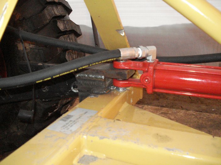

rear blades can be made far more efficient by adding a hydraulic cylinder,such as I did. preventing the need to get off to angle the blade by hand.
My blade is 7' wide and angles 45 degrees left or right and still covers my tracks.
blade is set up to work in reverse but I can add another mount and turn it around and use it going forward. Ican still use it to back drag as is, but with the FEL I just use that instead.
the only problem I have encountered is deep snow will roll over the top of the blade.I plan on solving this by adding a 6'' to 8'' piece of steel to the top edge. it will be bolted on and used for pushing snow only.

I built something like this for my FEL (I don't have a back blade, but the idea would be the same).
I used 2" steel tube and expanded metal. I wanted the screen since the lights shine through, and I can see through it unless it's solid full of snow.
