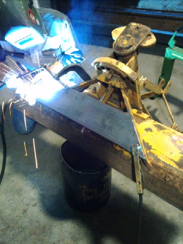

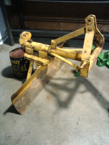

picked up this blade from a Guy in LaCenter for 75$ I plan on adding ripper teeth that are removable because I don't have a box blade. three teeth about six or eight inches apart. I started welding the tooth bracket tonight. I'd also like to add a bracket for my suitcase weights to add some weight. any ideas?

Good deal for $75.
I would get some box blade scarifier teeth as they are only 20 - bucks each or so. Then some 4" angle and make a box for the teeth like a box blade has. Then you can raise and lower them as needed. See if you can mount it on the back side of the blade. That way it will both strengthen the blade and add more weight where it will do the most good.

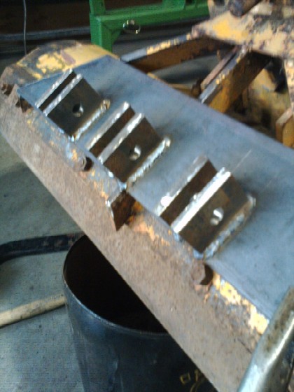

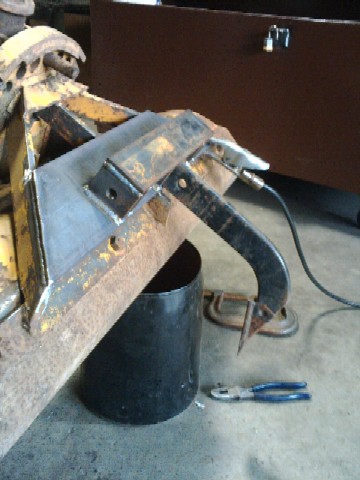

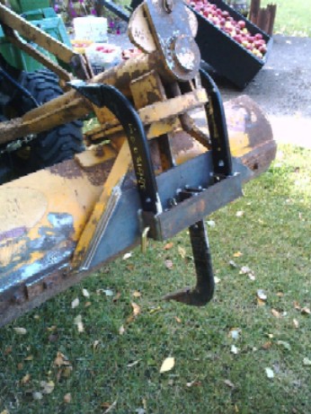

one step ahead of you guys! got welded up today! thanks everyone for your ideas!

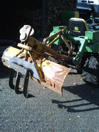

now all you gotta do is envision it green. after winter, off to blasting and painting!

Wow, you work fast! 1 min from a mock up to full paint.
Nice job. I would have wanted the back bar to go full length, but that is ok as is. With the teeth close like that, you will be able to pull up rocks pretty easy.
One caution, be sure to pull the blade up when you turn or those unsupported teeth will twist up like nothing and quick too!

Can you raise the teeth up so that they are just about 2" lower than the bottom of the blade? That would be a good depth for most things. Typically, you don't want to have them way down unless you are really agressively breaking up the soil. I am concerned that the teeth may bend as they are sticking down a ways, but if you are in rock free soil it may not be a problem. Best way to find out is to try it out!

yes, when the teeth are all the way up, they are about 2 1/2 inches from bottom of blade. i will mostly be using it to prep the garden before tilling (clay soil = hard on the old craftsman tiller.) normally i get a truckload of sand and compost, then turn it over with my loader before tilling it in. the soils getting better, but three years later i still have lots o' clay. i can bury the teeth, and get deeper than my tiller can, add more sand, till, add more sand, till again, and hopefully be done! when we moved in, you couldn't even shovel it, would have been great for pottery though. the soil is ten times better now.

One thing, don't have them engaged in the ground if (when) you make a turn.
They could bend that way, especially the deeper you have them. (Don't ask how I know.:))

Nice design and fabrication, FATTYF.
I don't think you will bend the ripper shanks with your 2305. Now a heavier
tractor sure could bend them (ask 3RRL).
