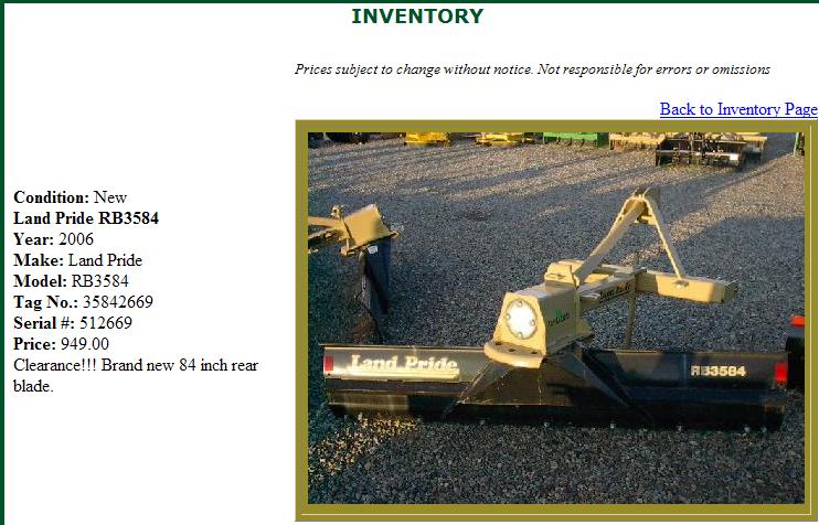

I've been looking around town and found a land pride for 949 and saw on the web a KK for about the same. Are these not Heavy Duty? I'd like to make sure before I spend that much. :confused:
Also, if you look at the one add, its a 2006 model so its been sitting out for a while.
Width(Blade) 84" Weight(Approximate) 484 lbs. Angle(Position)
9 Forward up to 60 degrees right or left
5 Reverse up to 60 degrees right or left Height(Blade) 17 1/
Thickness Cutting Edges1/2 x 6 Heat treated Replaceable & Reversible (Double bevel)
Tilt Range5 Positions up to 30 degrees right or left
If you can get the Land Pride for the same price as a KK, I would definitely go with the LP. An example of differences, look at the moldboard. The KK is bent with a series of bends, the LP is rolled and is much smoother. What series of blade is the Land Pride? For your tractor I would get an RB3584. This blade has angle, tilt and offset, and is built tough enough to take what ever your size tractor can do.

I have a John Deere #47 7' rear blade for about 10 years now with no problems but from what you have shown in the pics I would go for the Landpride 3584. That is definately a better designed blade than the others shown.
