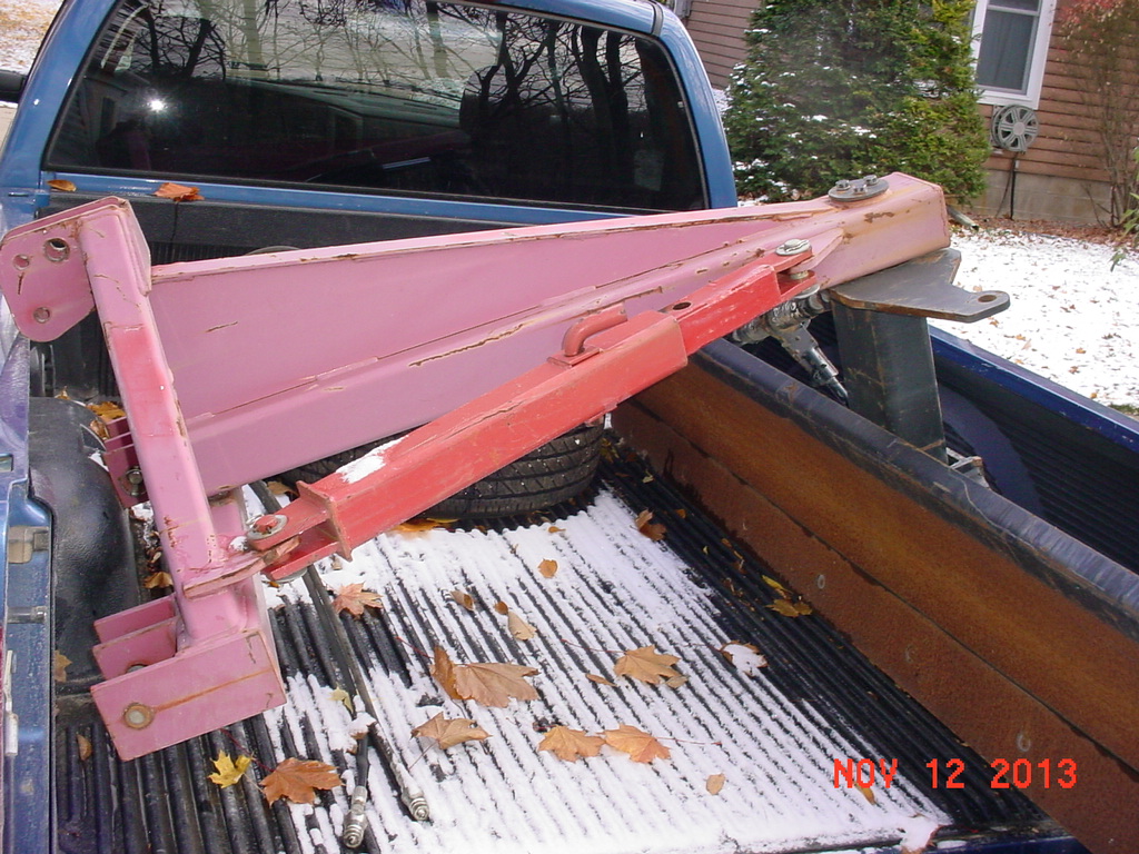

I have had my jd 110 for about a year now. I had some concerns about traction with r4 tires but with the 4-wheel drive and the concrete driveway. I have not had a problem with snow.
I bought the blade used its a 6-way blade made by Bush Hog model 91-08 (same as Dirt Dog 91-08 & Rhino 850), (I also have a fel for the heavy snow).
The blade is 8 ft and weights about 850 lbs. It has hydraulics for the angle. I plan on adding a hydraulic cylinder for the right or left offset.
The photos below are from last year, before I added the blade
I will try to add some more photos of the tractor & the blade next time we get some snow
