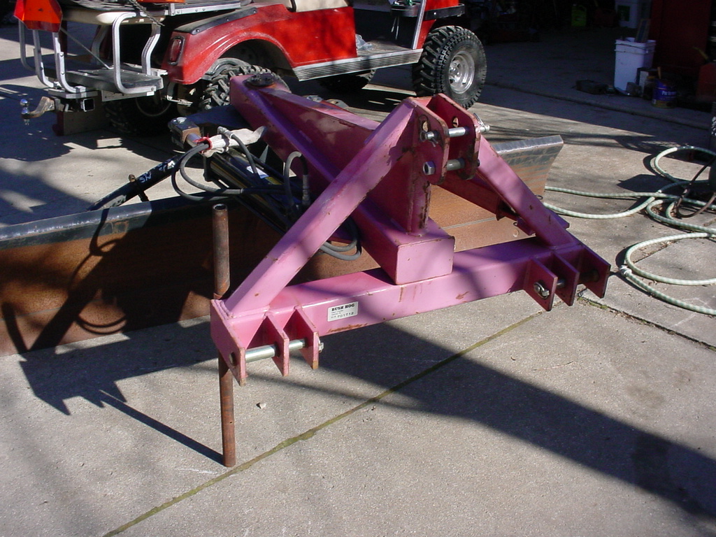

I welded some pipe to the back edge of my moldboard and made some skid feet to adjust the cutting height of the blade. Adding or removing washers raises or lowers the edge.
Sean
