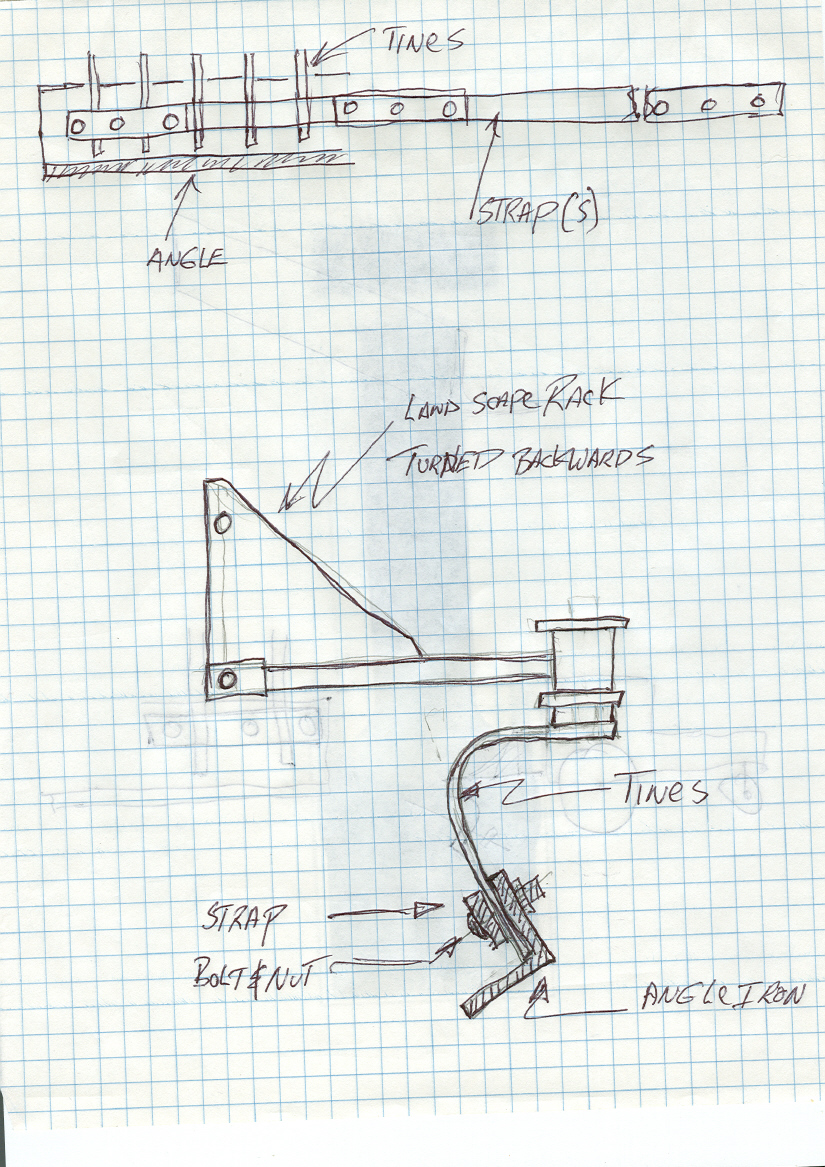

If you want to pull loose gravel back on to the road and you have a rake get your self a piece of angle iron. Set the tines in it so one edge is in front of the tines and the other is on the ground. Drill some hole and get some large washers or short straps and bolt the angle to the tines. Now you have a very non-aggressive blade. You could use a piece of plywood above the angle if you want it to hold more gravel. May not last long but cheap.
I use my rear blade turned backwards to do the same thing.
Edit: I have heard the best tool is on of those power brooms.
Do you have a picture you could post?
   / Rear blade+box blade +landscape rake is there any additionla beneift to a landplane? #20
No picture available because my clever brother is the one who made this thing and he lives 200 miles from here. But here is a drawing from my memory. I am no artist as you can see. If you turn the rake backwards you get a scraper. If you turn it normal you get a drag. It is for lightish work depending on the size angle you use.
