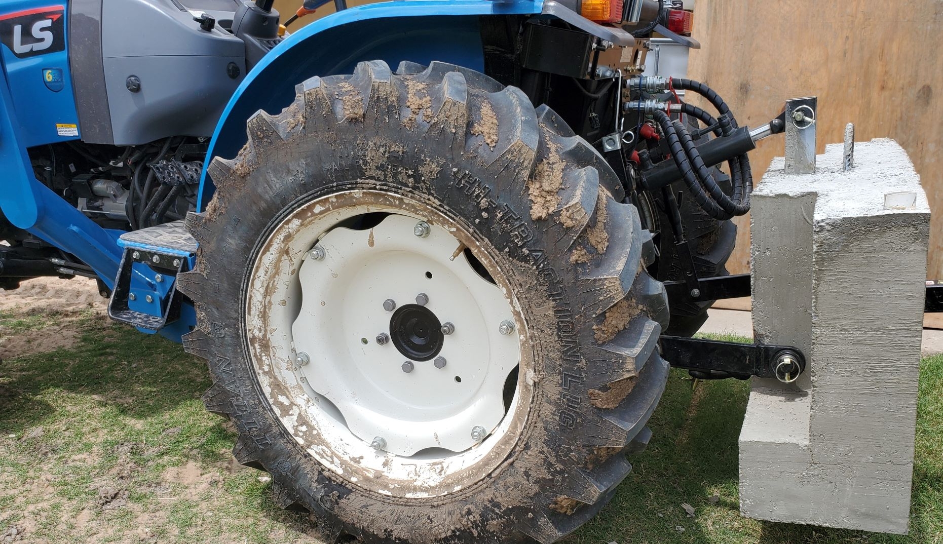

The best tip I can give is to not spend a lot on a ballast box, use something inexpensive as a form to make a concrete block of a suitable size and weight. A 55 gallon drum would be fine, so would a homemade plywood box. All the box really has to do is hold the concrete until it cures as you can use a 3 point drawbar stuck through the box/barrel/form to actually carry the weight.
A 3 point implement can work, like oosik's blade or a bush hog, but they can stick out a ways depending on what it is. Putting something heavy a carry-all or 3 point forks can work too, casting a concrete block that has a center section that fits down below the forks/carryall angles so you can set it down and pull away, and then back up to it and pick it up with the forks/carryall is a great idea. Even something like a round bale on a 3 point spear or bale forks is also a good counterweight as they are decently heavy and not obnoxiously bulky. The only thing about bales are that they aren't real durable.

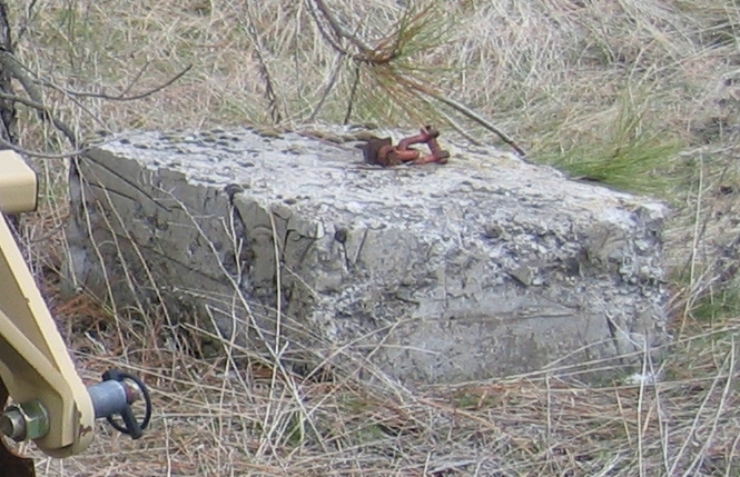

mo1 is right about a cast concrete block. I have one with a center loop. Molded with scrap lumber. It's 22" x 22" by 14" tall. Weighs around 400#. The few times I use my disk harrow - set this block in the dead center. Added weight really improves performance.
Unfortunately - I just checked and I've deleted the pic of the concrete block. Wasn't a very good pic anyway. Kind of hard to see as it was sitting in/amongst a large weed patch.
Hey - I found a pic of the concrete block. Must be a newer pic. You can actually see it.

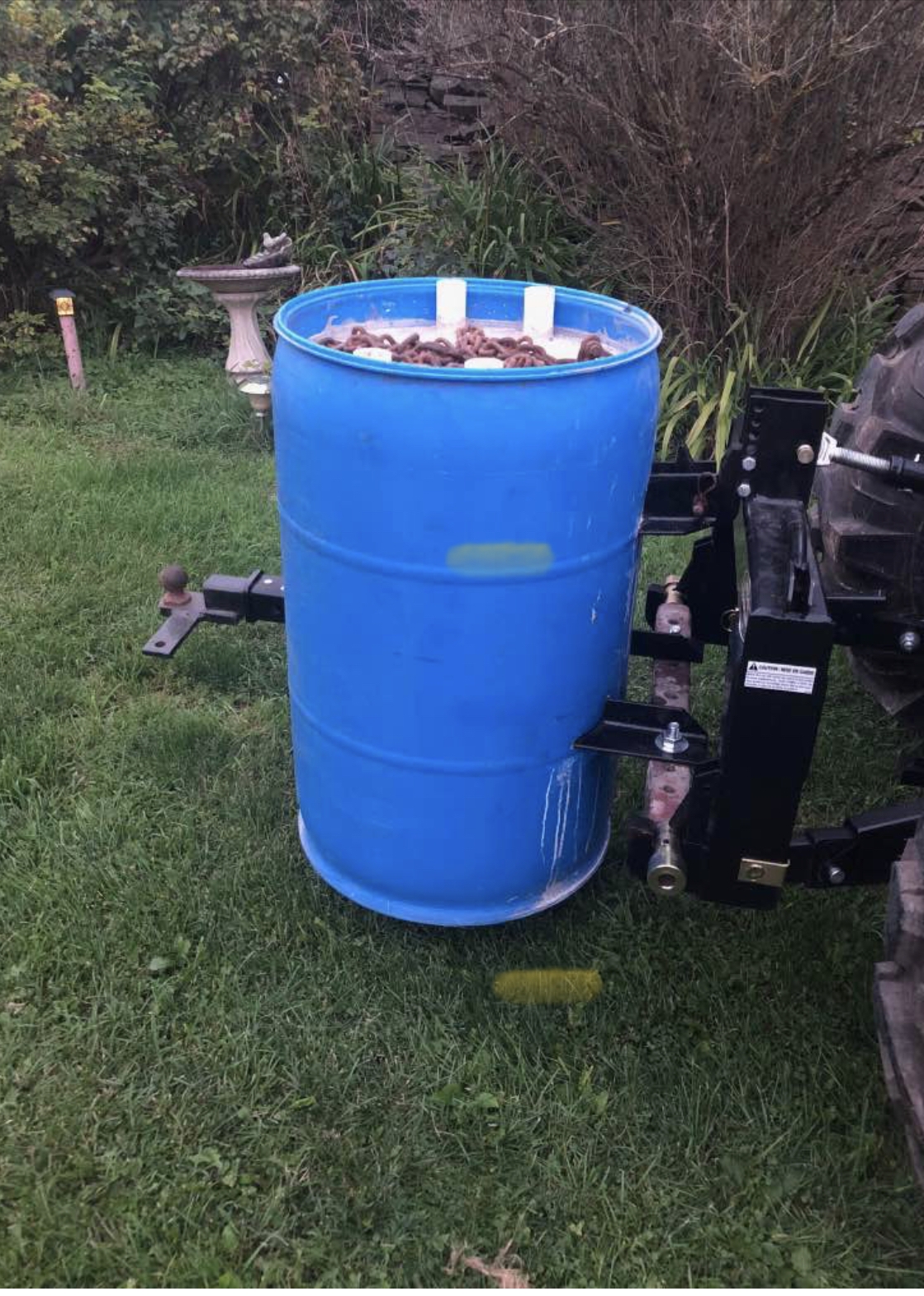

I made mine out of a plastic 55 gallon drum. Made so I can use it with my 3 point quick hitch and also added a 2” hitch receiver on the back. I use the receiver all the time for moving trailers around. I should have used larger tubes.

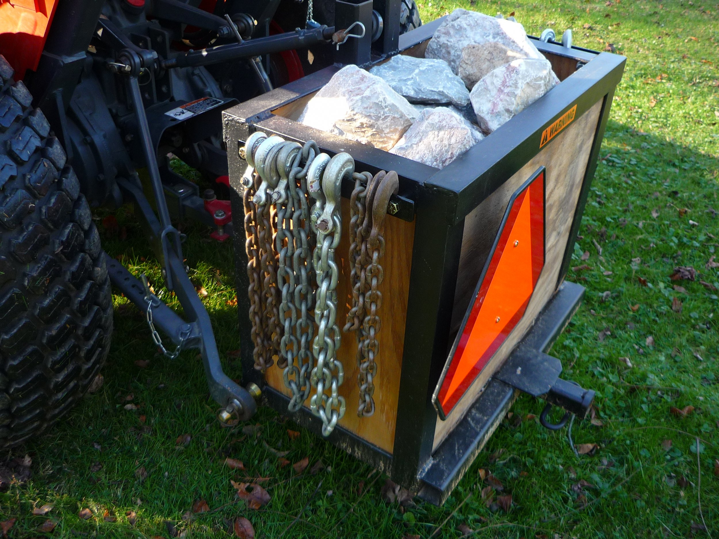

I made a ballast box out of 2x2x1/4 angle iron, welded into a box frame, with part of an old trailer hitch frame/receiver for the backside bottom, which gives me a nice place to pull trailers from. I used ext. 1/2" plywood for the sides and bottom, and fill the box with dense stones, which I can add to or remove, if desired. I have some bars on each side which work well for hanging chains. I used to just have a back blade for ballast, but having to be wary of a weapon/obstacle back there got old fast. The weight is about right for my L3400 tractor- I'm not pulling any ground engaging equipment, and my loader maxes out at 1000 lbs or less.

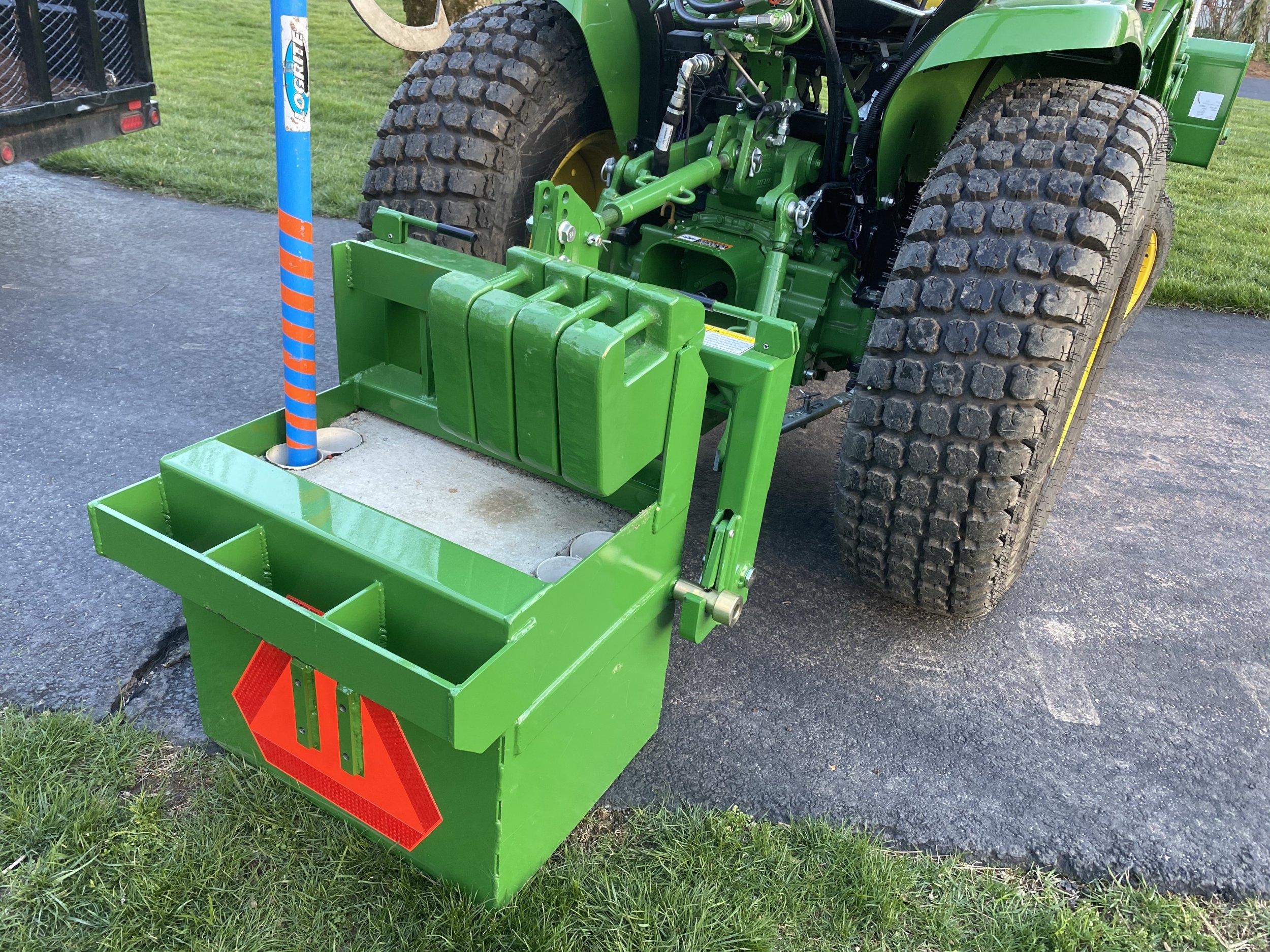

/ Rear ballast box #9

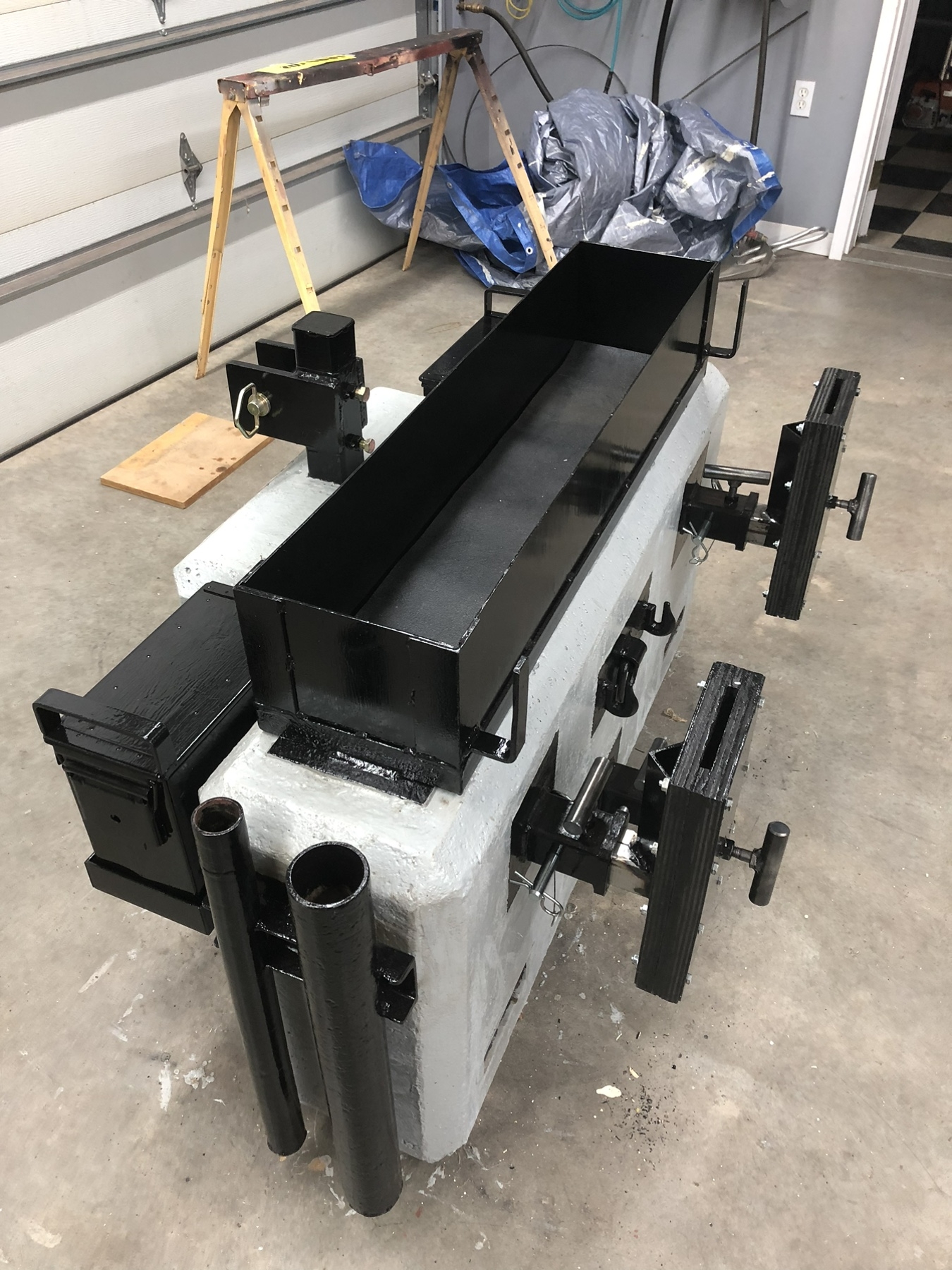

I made mine using concrete with attachments to carry my chainsaws and other tools. It was sized to weigh 1600 lbs.
That's too heavy for a 37 or 45hp tractor, maybe even a 60hp one! What made you want it that heavy?
I do like all the attachments and provisions though, Nice work!
This one weighs ~980lbs and is all the ballast my tractor needs.

How much ballast is needed depends on the tractor and loader and varies widely. For example, a 60 HP cabbed MFWD Deere 5055E/5060E with the 520M self-leveling loader is recommended to have at least 3087 pounds on the 3 point as ballast if there is no rear axle weight. This decreases to "only" 2867 pounds on the 3 point if there is at least 441 lbs on the rear axle. If the tractor was an open station instead of cabbed, the recommendation is a minimum of almost two tons of ballast- 2867 pounds on the 3 point and 1213 pounds on the rear axle.
/ Rear ballast box #11
Well, I would agree that it seems like a lot of weight but it’s really not. Remember that it is not just the weight of the ballast but how far back it is ( the center of gravity)from the attachment pins. My 1600lbs ballast block with a center of gravity at 12” from the pins is no different than a 533lbs bush hog that has a center of gravity 36” from the pins.
My New Holland TC45D has a 3pt rating of 3275lbs at the pins and 2330lbs at 24” behind the pins. As previously mentioned, the ballast weighs 1600 lbs with a center of gravity at 12” behind the pins. Well within the tractor’s 3pt capacity. Equally important for me is that it had to be within the capacity of tractor’s loader (NH 16LA) so it can be moved around with pallet forks (and it is with no ballast on the back of the tractor).
So, when you have a 700lbs grapple and a 1000lbs log hanging off the front loader your expensive front axle will be glad you loaded up the 3pt with enough ballast to remove that load on the front axle and keep things from breaking.

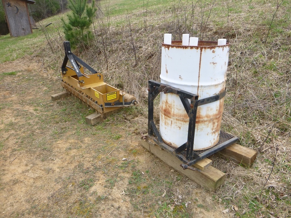

I used a 55 gallon drum, Set it away from your tractor will give you more counter balance to the FEL. Friend had several bags of harden concrete bags that he wanted to get rid of. Broke them up and dumped them in... Old photo but I've since removed the pipes (or rain collectors as I called them and filled it to the top and placed a Manhole cover on top of it. Fit like a glove.
About 800 to 900 pounds, Manhole cover felt like 100 by itself!!
