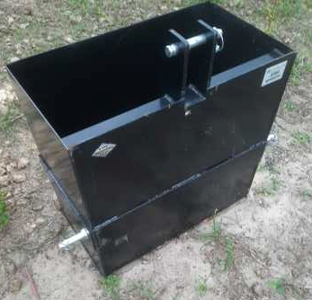

I finally decided to purchase a 3pt ballast box for my RK37. After watching numerous YouTube videos seeing what others have liked and not liked I decided to purchase one from Rural King, Most of the dislikes on the videos was the fact that the tabs the lift pins mount to had questionable welds and to be safe they re-welded them. As I was searching information on the different brands I noticed that Rural King sells two different sizes. One is by King Kutter with something like 800lb capacity and one by Top Dog Industries that make the RK grapples. It only has a capacity just over 400lbs but with loaded tires I figure that would suffice since about the heaviest thing I lift is round hay bales averaging 800 - 900lbs. Also what kind of drove me that direction is the fact that the lift pins are mounted directly to the box rather than on tabs.
I was planning on filling the box with concrete but since the mounting nuts for the pins are on the inside that would make them non-accessible if I ever needed to change one for some reason.
I was thinking about blocking an area off on each back corner to prevent the concrete from filling in those areas. Then I thought about just buying the bags of concrete and wetting them done so they would be hard when dried so that I could just load then in there and they could be removed if I needed to access that area. But then I wounder if I would ever need to change one of those pins and am I just thinking too far out of the box.
Anybody have opinions here?
Thanks........Don

If I were you I'd dump some gravel in it and see how it works. Then decide if you want to change things. Also would drill drain holes in the bottom.
If you decide to fill it with concrete, I would definitely make the ends of the pins accessible somehow.
As far as filling with bags of concrete, I believe I'd just get solid concrete blocks and set them inside. Much easier to handle and remove if you choose to.

George2615, not having tabs for the pins is what drew me to this make. I think this is much stronger than having a tab that the weld could break or an accident could break it off. The sides of the box where the pin holes are drilled is the thickness of the box plus there is a 4" strip of 3/16 or 1/4" steel welded on each side that the pins holes are drilled through. Very sturdy built.
CH4Ohio, this box was $269 and the 800lb ones by King Kutter are on sale for $299. I had thought of using blocks but with the holes in them and not being solid you'd lose about 50% of the weight.

You can get solid blocks. They're half as thick but solid -- no holes. Very heavy. 16"x8"x4". Sometimes called cap blocks. Readily available. Weighs almost the same as the 8" thick block in half the size.
Check out Home Depot "Solid Concrete Block" ... Can get them anyplace that sells the larger block. Cheap weight.

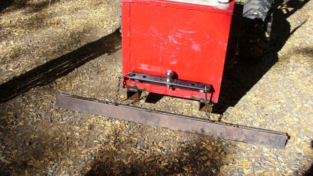

I drilled through lower section of my ballast box (both walls), wedged in a section of 1 inch PVC pipe to form tunnel from hole to hole, run a 3/4 inch threaded rod through tunnel and bolted on a flat draw bar....Then filled box with concrete.... Concrete weighs in at about 150 pound per cubic foot and my box measures 24x24x12 inches so it is about 4 cubic feet, or about a roughly 600 pounds...
The through bolt also allowed me to add a 2inch angle iron for trailer ball and other things like a "drag" (section of rr track) hooked onto holes...

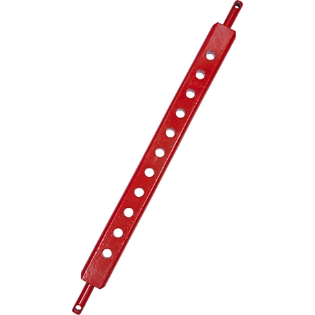

Not really answering the OP's question, but when I need ballast I'll use a drawbar like you pictured and hang a bunch of old brake rotors on it. Maybe wrap a chain around them to keep 'em from shifting. You can fit quite a few on there.

Thanks for all the suggestions. Went to Lowes and looked at both the solid concrete blocks and gravel. Have kind of made up my mind to go with gravel. I plan on covering the lift pin threads with PVC end caps to protect them from the gravel being dumped in. Thanks again for all the responses.
I knew there was some reason that I was hanging on to all those old brake rotors . . . Great idea! Thanks!!
