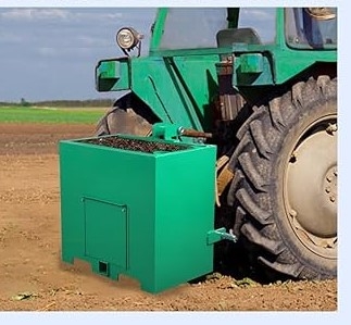

I bought one of these boxes from Amazon a few weeks ago. $210. Shipped free from California via FedEx. (If I wanted to ship 90 pounds across the country it would cost nearly the price of the ballast box . . .)
I haven't really used it yet, but I'm happy with it so far. Looks good and solid. Welds look good. Tubes in each corner for long-handled tools. Arrived packed well in a sturdy box and the box even survived the trip. Wasn't skinned up at all -- as I expected. Don't think you can beat it for a couple hundred dollars.
I'll probably fill it with gravel for starters. Maybe solid concrete blocks later. I have quite a few brake rotors in my scrap pile at the barn. Might drop some of those over a hickory shovel handle in the corner-tubes.
These sell under several different brand names but they look alike and seem to all ship from the same locations (CA or GA). Probably all made at the same factory. I did drill out the hole in the end of the pins so I could use regular snap-rings instead of the hairpins that came with it.
