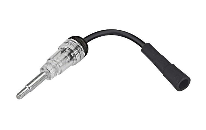

It's a 2 cylinder Kawasaki. My mowers have clear gas filters so I can instantly see if fuel stops flowing. As it's dying have her choke it, see if it picks up some.
These in line spark testers are $5 Harbor Freight. Put it in one cylinder, it flashes with spark. Run it...see if it's flashing or not as it dies.
