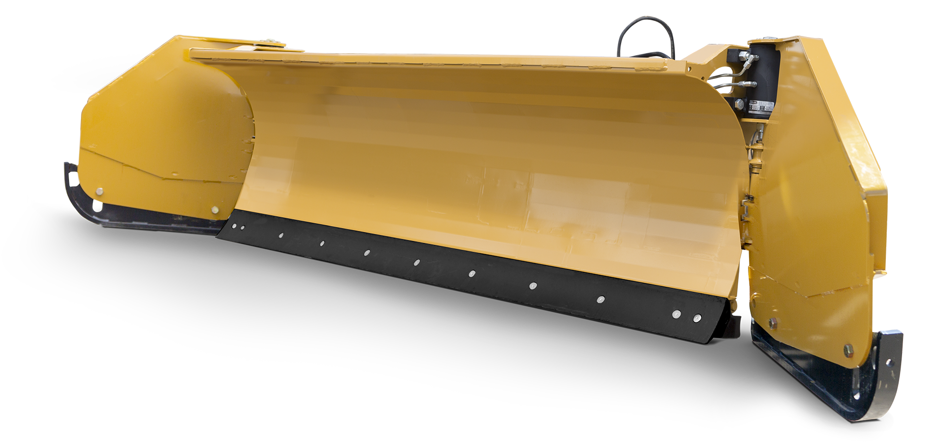

OP, I also upgraded my snow moving equipment this year with a pull-type blower and SSQA snow pusher. I had previously been using a SSQA blade. My clearing needs sound similar to yours, I have a long driveway plus outbuilding yards with alleys between buildings.
For your scenario, I think you could plan on clearing the first 20-30 ft. of your alleys with a pull-type by blowing the snow straight backwards as your drive, but beyond that I think your best bet would be to push the snow out of the alleys, then either stack it with your blade or pusher (depending on your scenario), or blow it away from there.
For pushing the snow out of the alleys, I would recommend a snow pusher over a blade based on my personal experience. As I mentioned above, I've been using a SSQA blade for years, and now that I've started using a snow pusher there's no going back for me. It's much more efficient.
As for the blower, pull-type is the way to go.

Snow pusher eh. I was wanting a hydraulic angle front blade for moving snow off to the side. Snow pusher is straight forward only, at least the ones I have seen online. Thats why I haven’t considered one. I had been dealing with the snow on my B26 with the FEL and a rear manually angled blade. I’m kinda use to that moving to the side idea. But I will consider the pusher. Thanks.

If you can push the snow off to the side (which is what you've been doing?) can you not just eject the snow from the blower chute to the same side? Without knowing your lot layout, I'm not sure what options you have. My rear facing blower has no problem throwing snow angled back towards the front, but just off to the side to miss the cab (and glass).
For pushing snow on long straight sections I think a snow pusher box would be much more efficient than an angled blade. You're driving the snow in front of you as you go with a pusher box. An angled blade can only push a minimal amount of snow and it always sloughs it off to the side. I'm looking at pusher boxes myself for next year, and I think I'm going that route, but I also want the backdragging ability to get snow away from my garage doors.

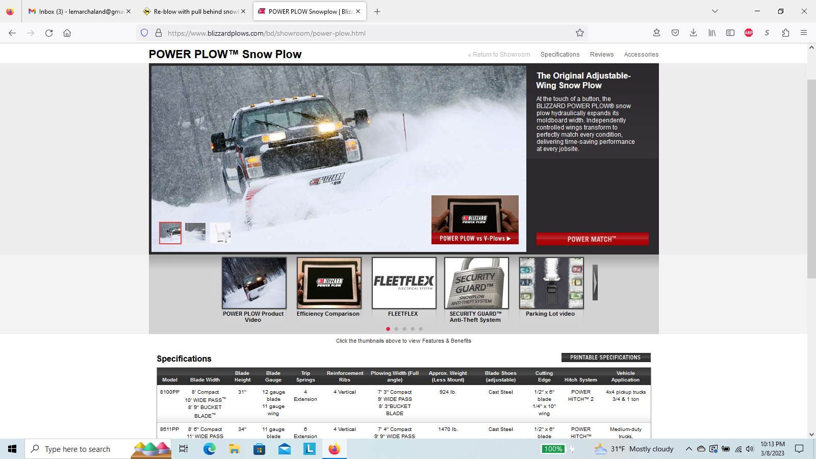

There's always a v-plow- which I personally would love
Not cheap, but a HLA SnowWing will let you push like a box or a plow: HLA Snow | 3230W SnowWing

The Blizzard adjustable plow would be a nice one also able to scoop or angle and wing.

If I had to do it again I would probably use the extra the pxpl costs to fund a ssqa scraper box for the FEL.
