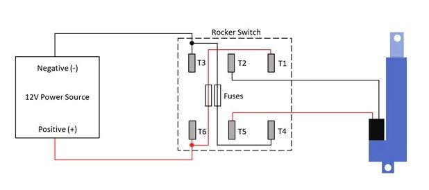

Attached is a typical schematic of how a switch for an actuation reverses polarity to reverse the direction.

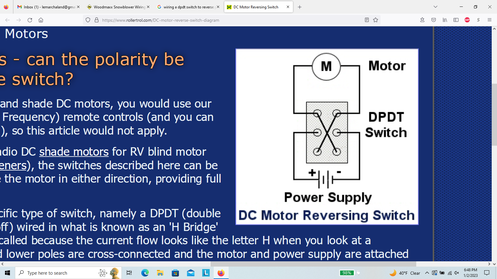

Here's a picture of a DPDT switch, Double Pole Double throw and how it's wired.

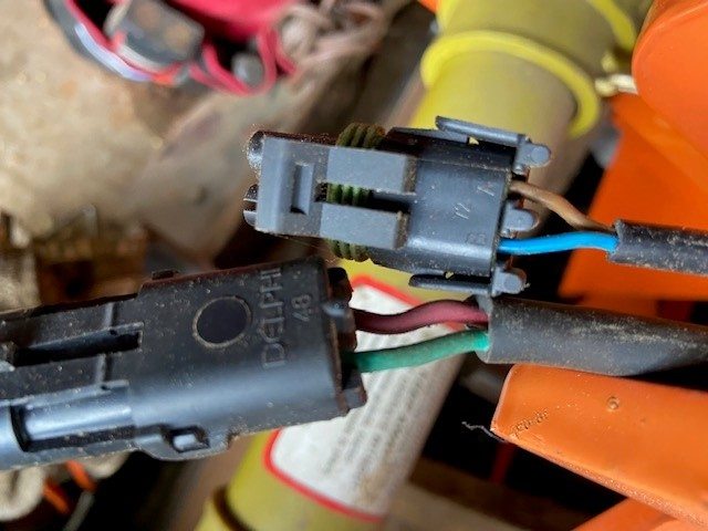

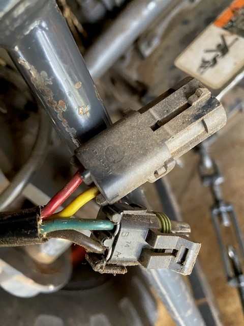

Maybe this will help - I have the SB 60 with electric chute deflector like this (Snow Blower) 12V-Electric Chute Rotator/Deflector Controls
Here are the connections on the tractor and the SB. The Yellow-Red on the tractor connector, go to red green to the rotator motor, and the Green Brown on the tractor side go to the Brown Blue on the deflector.
