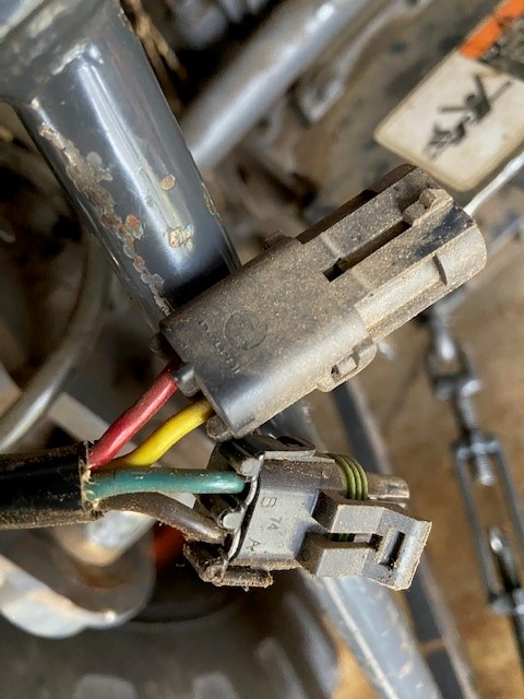

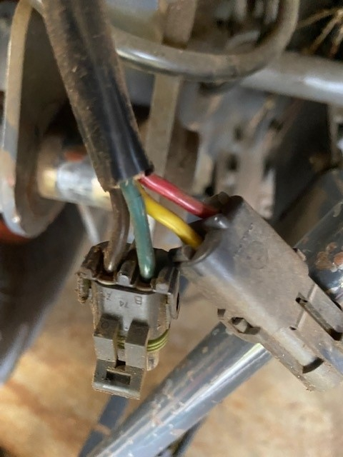

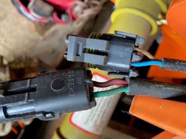

/ Woodmaxx Snowblower Wiring question #24

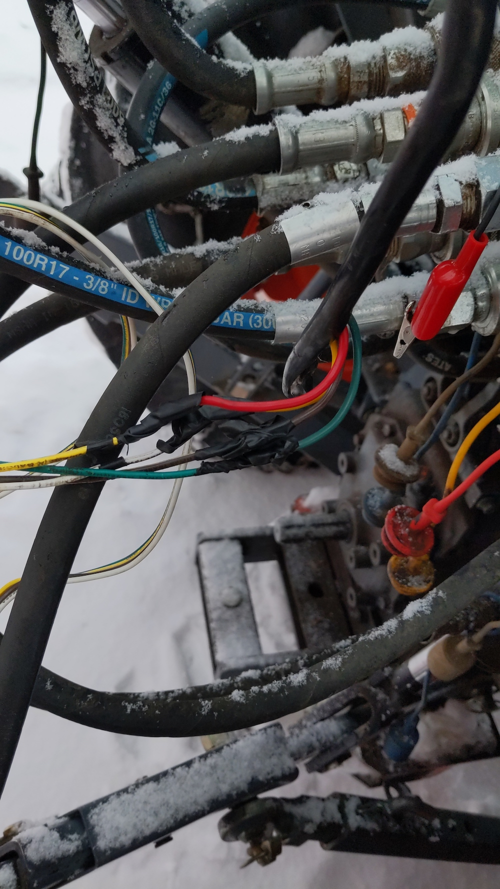

Sorry I was wrong! My blower isn't on the tractor see pics below
I just went out and hooked up the chute rotation motor and brown from the chute goes to green on the tractor, and green on the chute goes to red on the tractor side. The chute works/rotates.
On the deflector Blue from the deflector goes to yellow on the tractor, and brown from the deflector goes to red on the tractor.

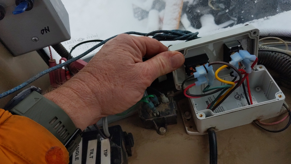

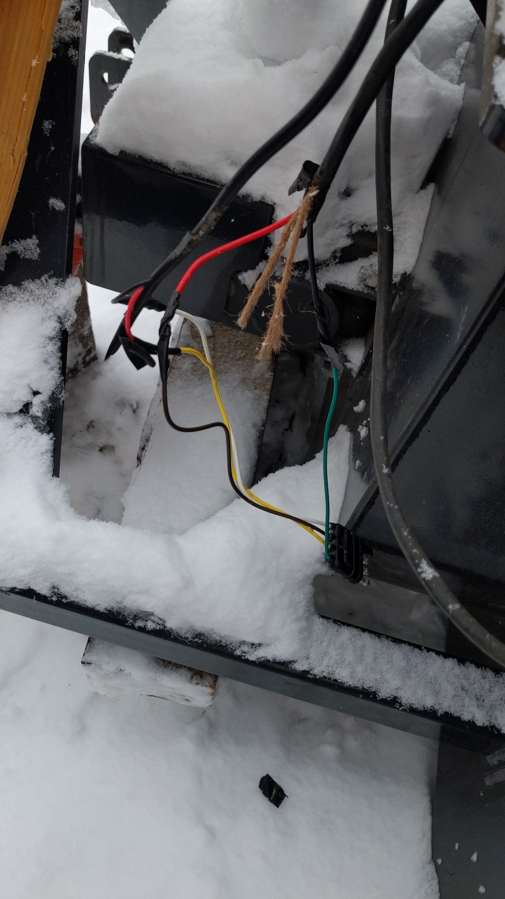

#29
Here are photos of the wiring.

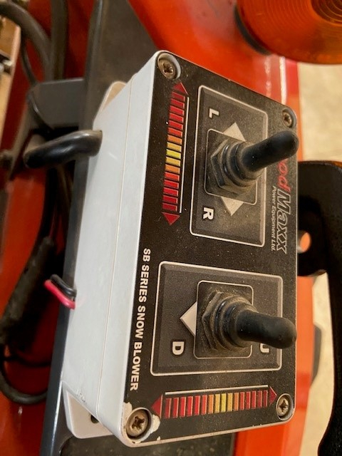

/ Woodmaxx Snowblower Wiring question #33
The switch next to your thumb is the chute rotation correct? It appears it has a brown and green wire correct to the blower correct? Those should connect Green on tractor to red on blower, and brown on tractor to green on the blower.
Then the other switch for deflector you have yellow and red from the switch correct? These Yellow on tractor goes to Blue on the blower deflector. then red goes to brown on the blower.
You might have blown a fuse by arcing the wires too.
/ Woodmaxx Snowblower Wiring question #34
Finally.....we at least get half the pictures we need.
IT shows us that the BROWN and GREEN wires coming out of the switch box goes to ONE motor, and RED and YELLOW are for the OTHER motor.
It doesnt matter HOW you wire it.....but brown and green need to go to the SAME motor. And red and yellow need to go to the SAME motor. If those "pairs" dont go to the SAME motor (IE: you have Brown and red on one motor and green and yellow on the other) ...NOTHING will work.
What you fail to show or tell us is the color of the wires coming out of the motors.....and what color they become when hooked up to the trailer 4-wire pigtail.
You do show that from the switch side......brown and green stay brown and green. And red and yellow become yellowand white.
FOLLOW the wires AFTER your splice all the way to the motor. Do the BROWN and GREEN wires go to the SAME motor.....or is one of those going to the deflector and the other going to the rotate?
