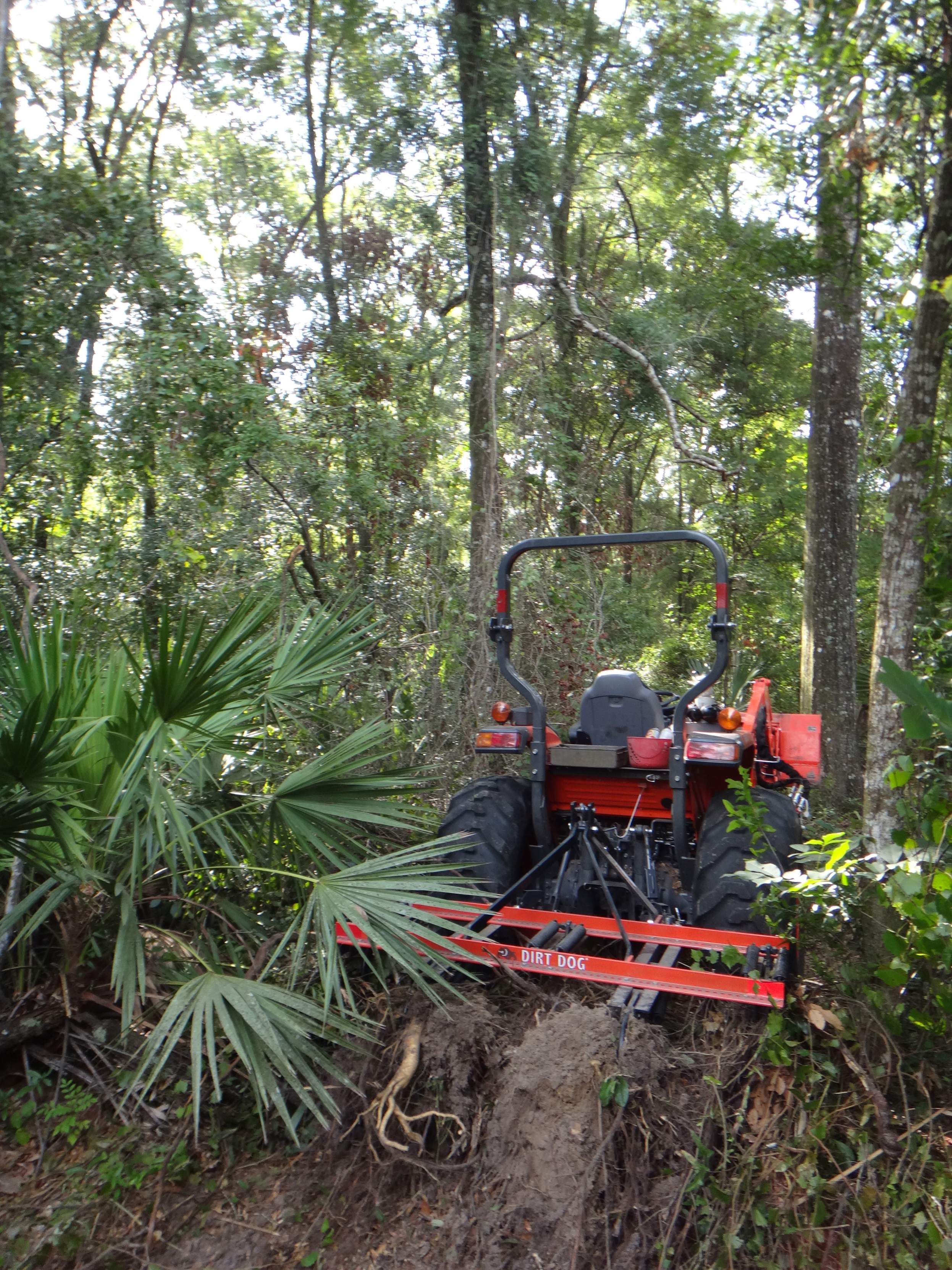

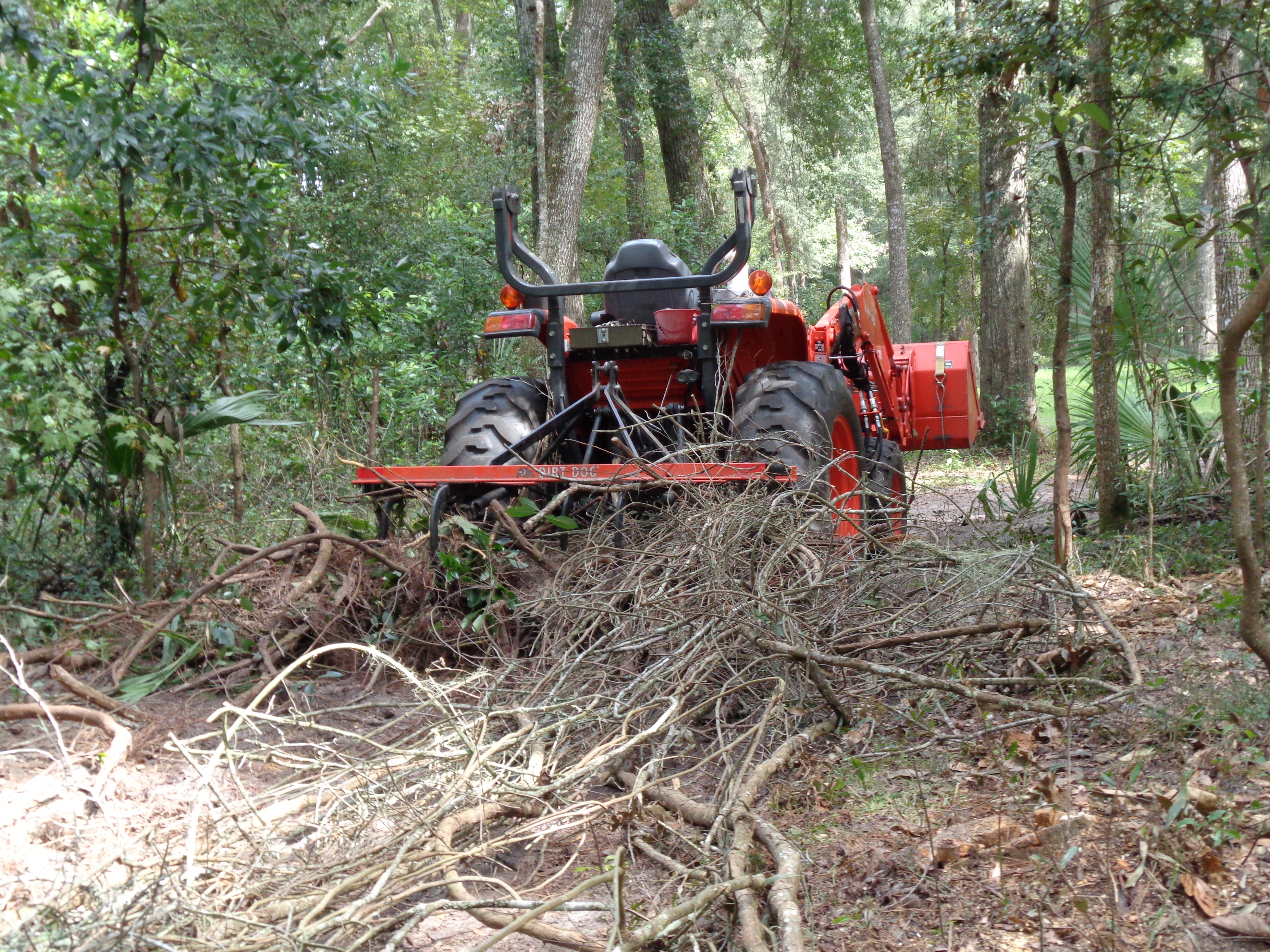

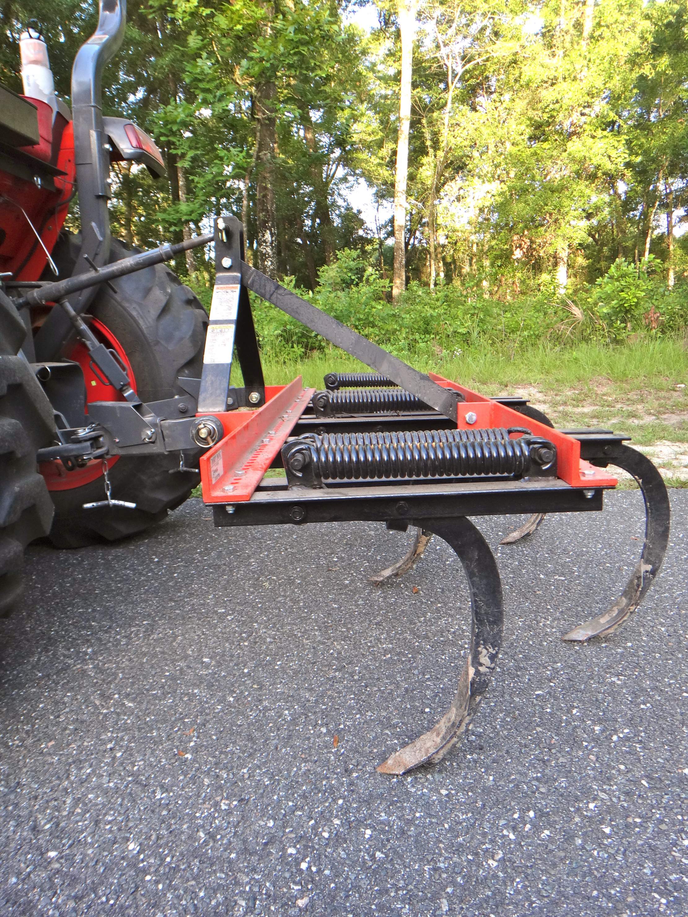

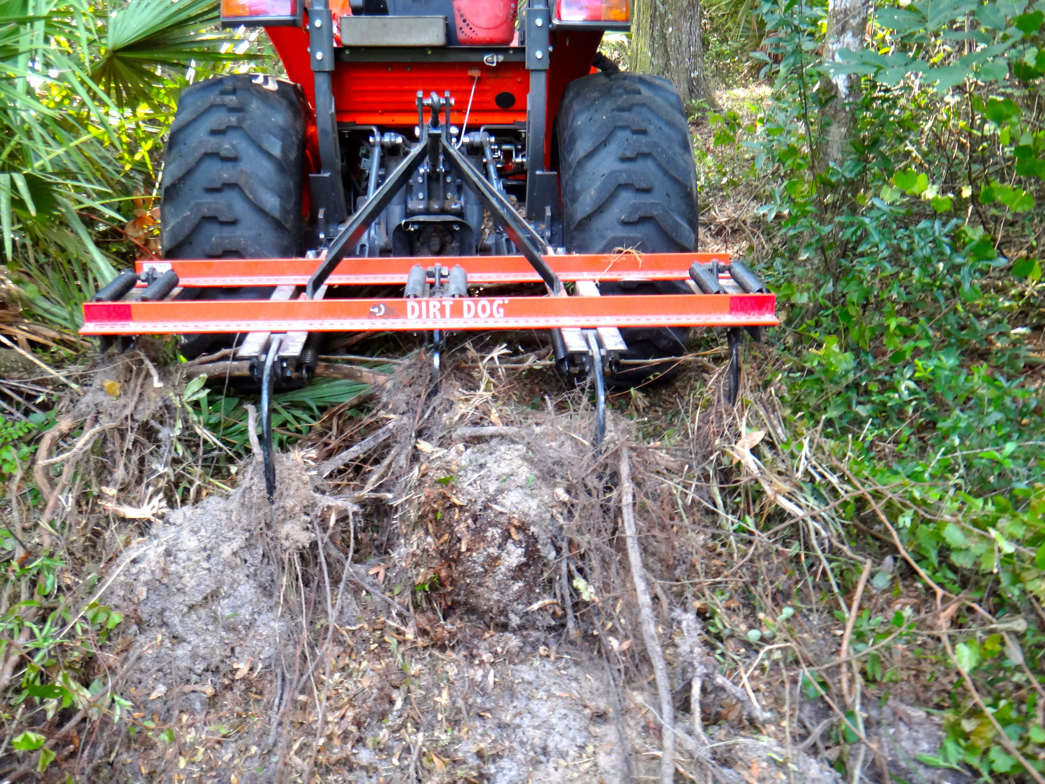

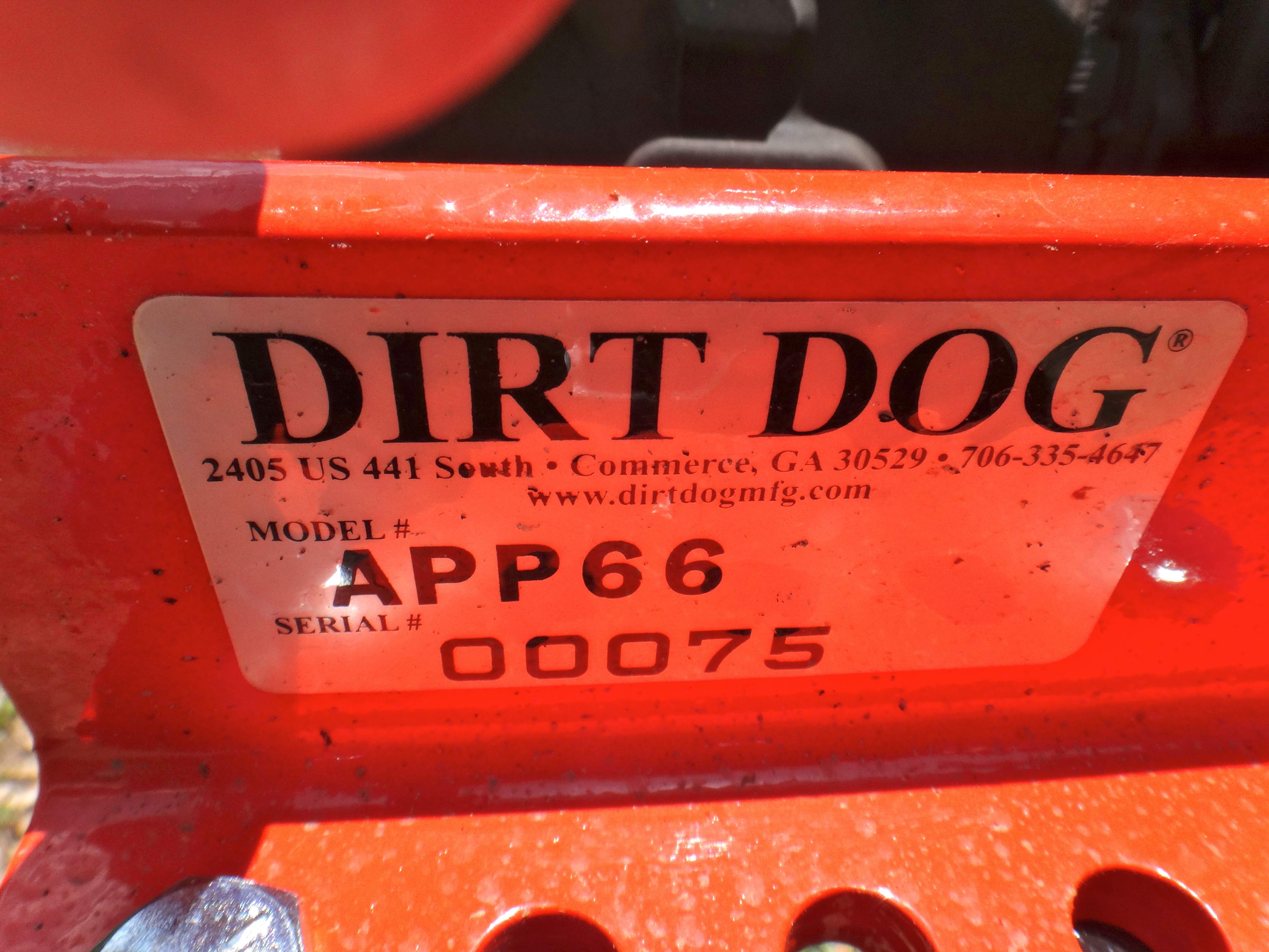

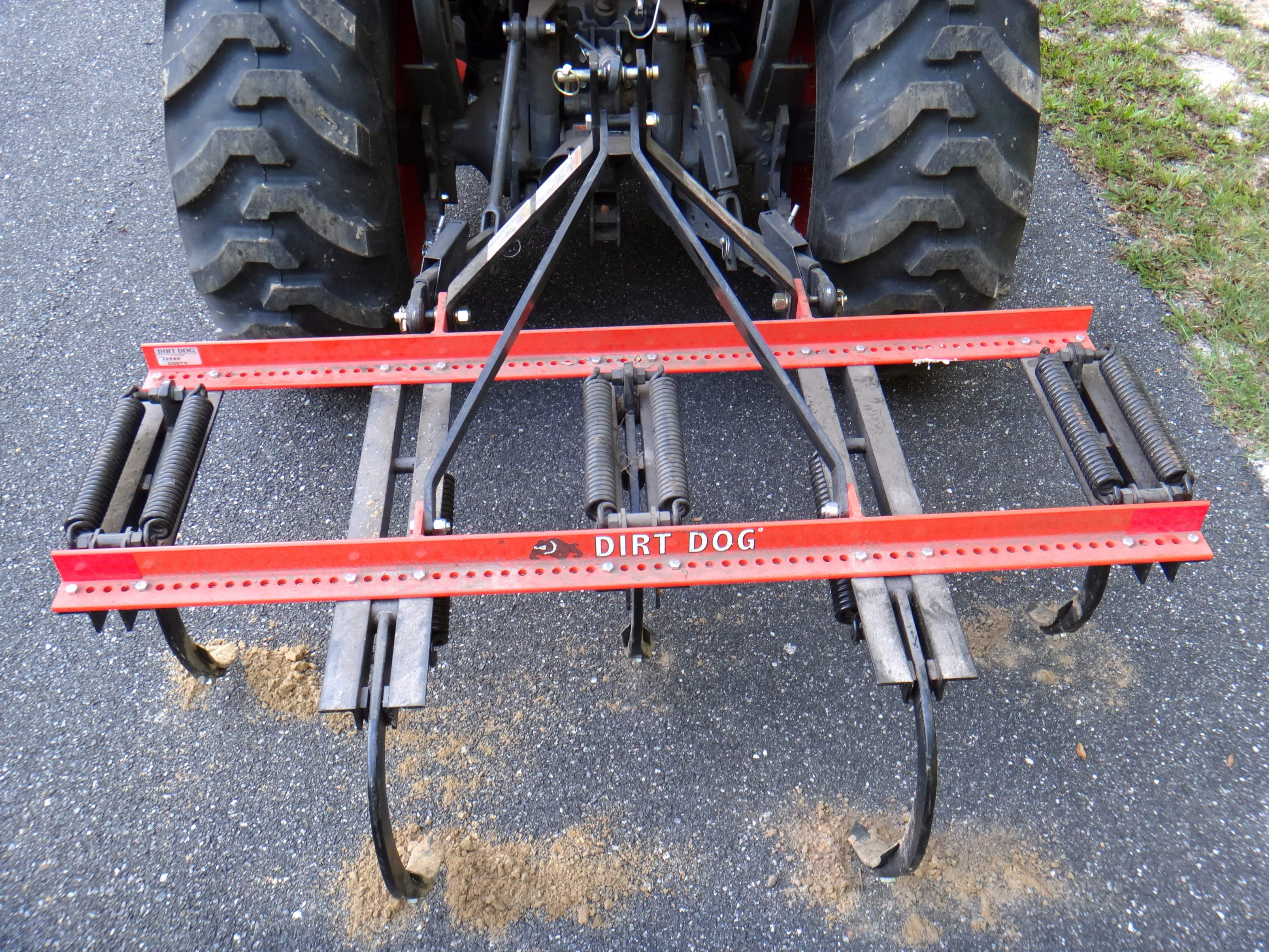

I have years of experience removing subterranean roots. Like HALFTRACK and BRONCO82, i had scarifiers rip out of the Box Blade frame, failing at the attachment hardware. I speculate scarifiers and scarifier hardware is engineered to intentionally fail before stress damages the Three Point Hitch.
A spring-protected Field Cultivator, also known as an All Purpose Plow, works better, holds up and penetrates to 14". Six tractor horsepower required per shank in moist ground. What makes the Field Cultivator prime for ground penetration is the parabolic shape of the tines, so the replaceable tine points are penetrating the soil almost horizontally.
Field Cultivators for compact tractors are made with three to seventeen shanks.
MORE: https://www.tractorbynet.com/forums/attachments/339095-dirt-dog-all-purpose-plow.html?highlight=
