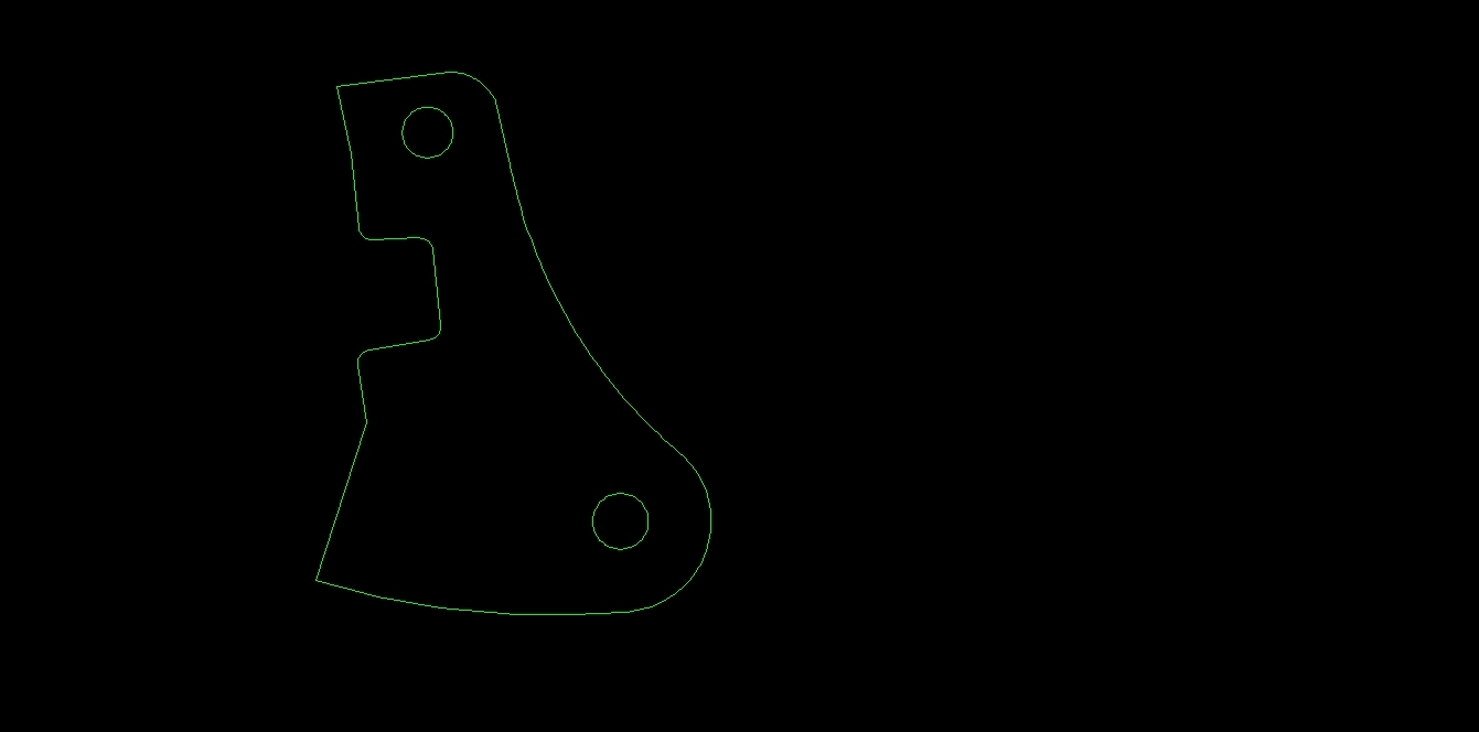

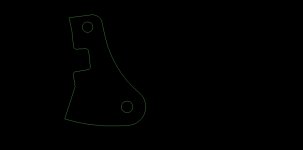

Attached is a quickie Auto CAD drawing of your bracket. With some exact dimensions it could be quickly adjusted for a perfect fit.
Larry

When I drew the template, the first thing that I did was to coply the brackets that are on my loader bucket. I got the pin spacing and angle exact. Then I cut out the amoutn of steel around the pins.
With that drawing, I cut it out on another sheet of paper to fit the angles on the Quick Attachement part. It was pretty simple, but I still had to add paper to an area that I cut too short.

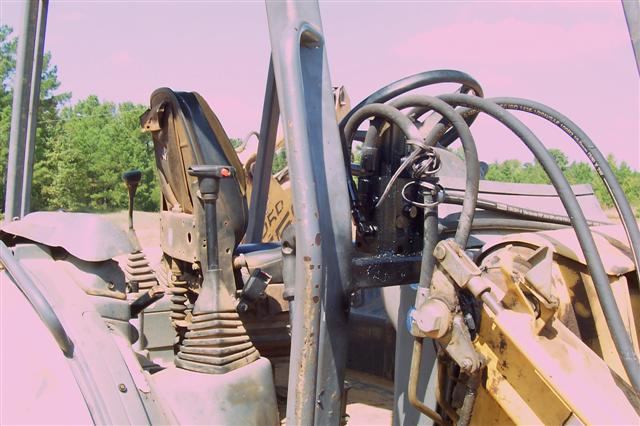

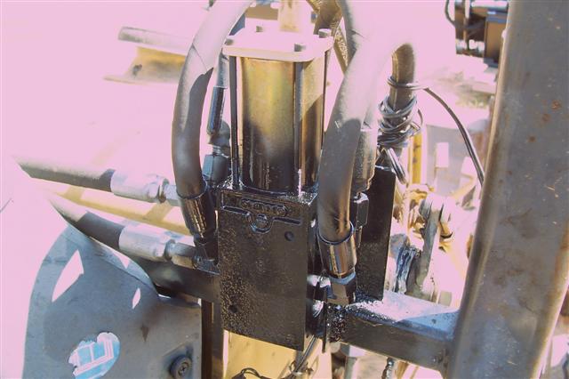

I made a bracket from some angle iron for the valve. I cut two pieces to fit on either side of it so that the hoses would fit and have good access. Then I spray painted it all black. I'm also going to create some sort of cover for it. I'm not sure if it's needed, but I figure it might be a good idea.
Eddie

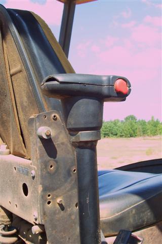

To make operate the valve, I decided to use a button that already exists on my loader controler. The red button puts my transmission in neutral. I've never understood what this was for or where I would use it, so for the last five years, I've never used it.
Now it will switch the hydraulics from tilting the bucket, to operating the grapple. I just push the botton and then the controler will open and close it. I let go of the button, and it goes back to controlling the angle of the bucket.
Eddie
   / Rake Grapple for my 555E #35
Eddie that button is designed to disengage the trans when you run into a large pile of dirt etc. and you disengage the trans to give the hyd pump full power to lift the load quickly without the trans going into stall----sure saves a trans when using the loader for moving alot of piles of dirt into dump trucks etc.---read the op manual for some tips on using the red button---may save you a trans job!!!
