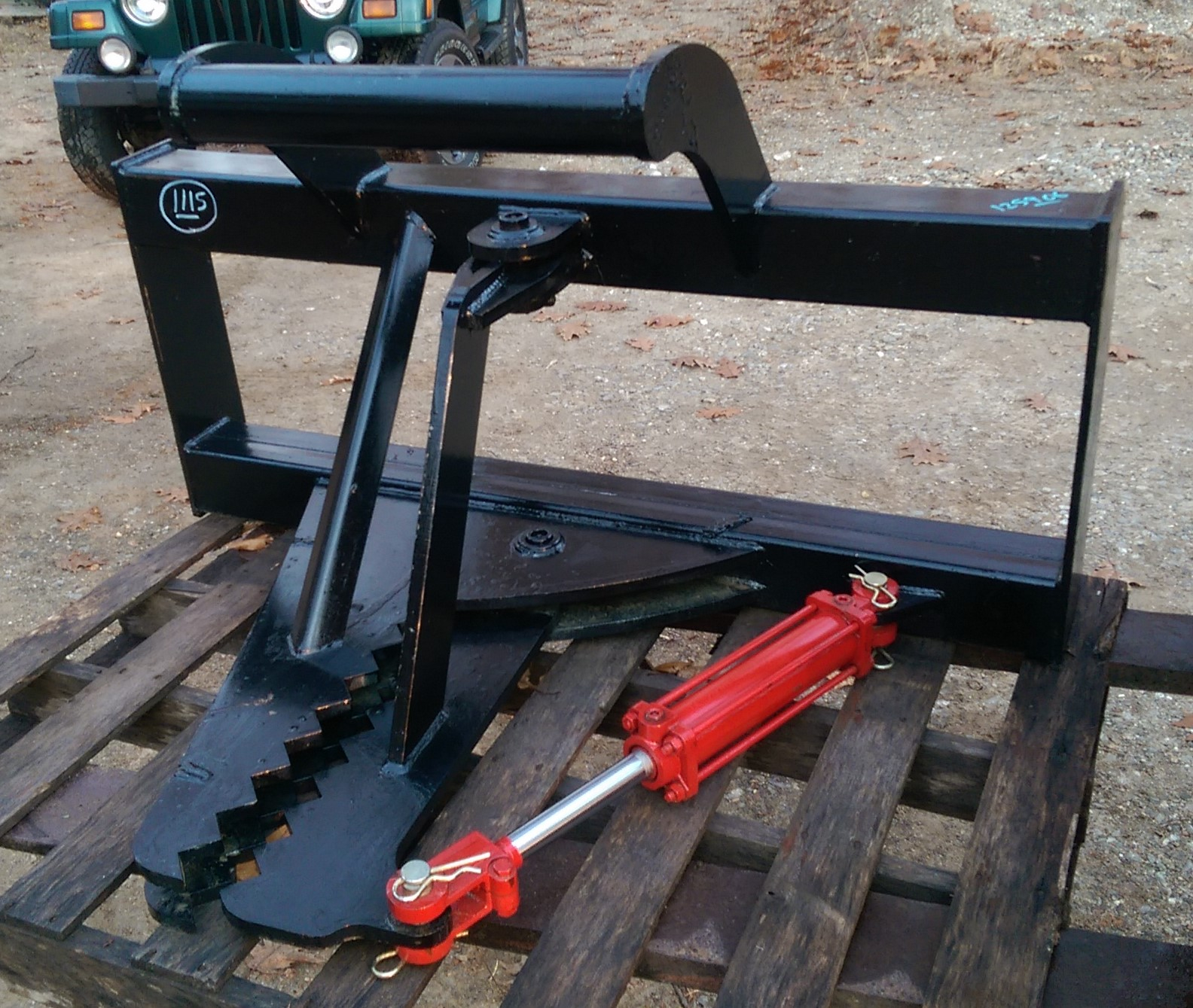

We pull a lot of small brush & saplings & were lucky enough to get an incredible deal on a tree / post puller. What a difference in having it... Ours is definitely a light duty one which is OK for our uses & the size of our tractor. For small stuff we just put it on the FEL & are aware of our limits, for the tuff stuff we have a 3PT to Quick Attach Adapter to be able to use it on the 3PT hitch.

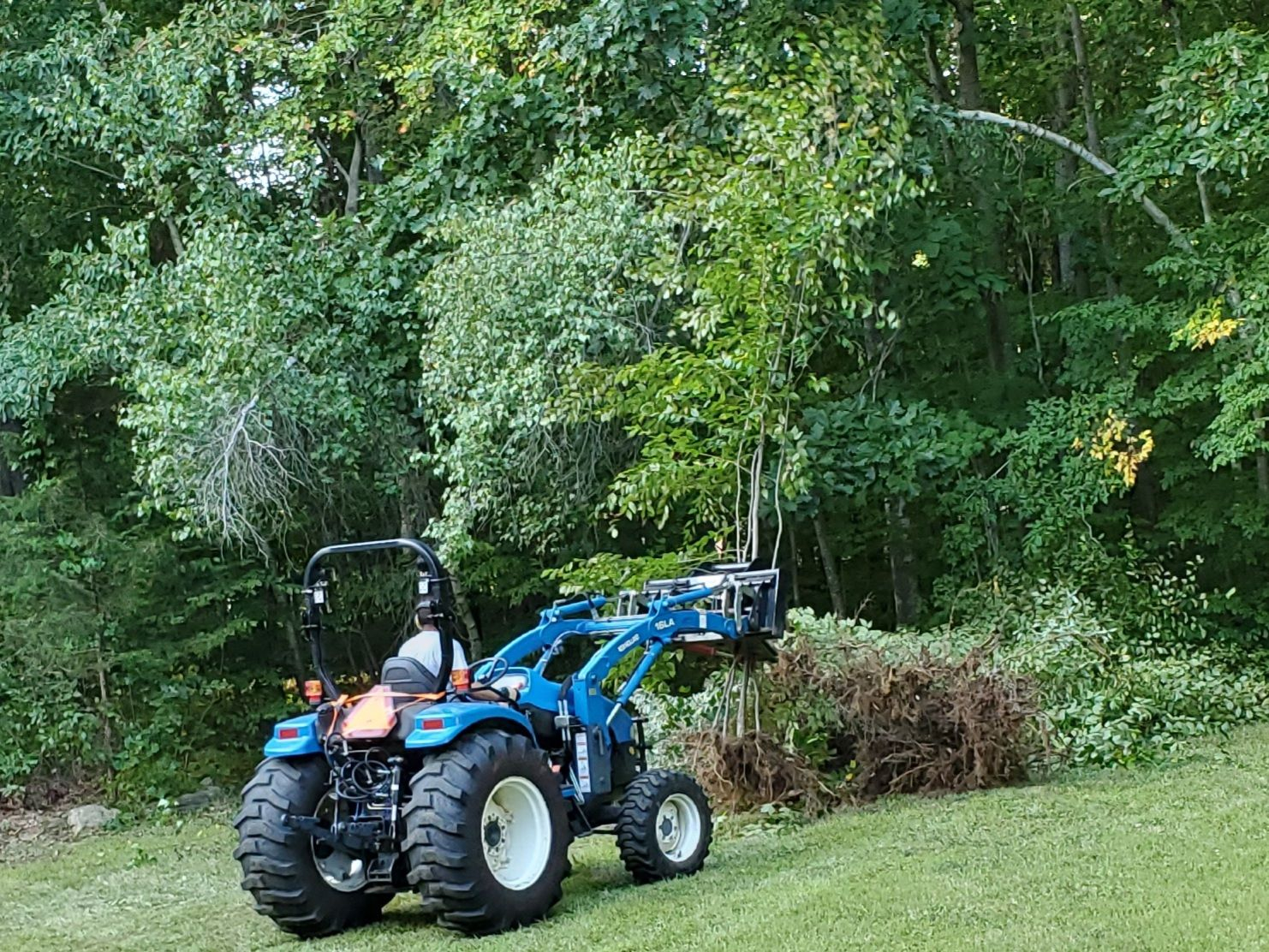

I have a FEL root rake grapple and a rachet rake. The grapple is great for picking up, what I’ve gathered with the racket rake, then drop into the burn pile.
The grapple is too frustrating to try and grab small brunch with. The times are spaced so far apart. I usually use a chain saw disc on my gas weed eater to knock down the small stuff then use the rachet rake on the bucket to drag stuff to a pile then switch to the grapple for picking up and transporting to the burn pile. It does get to be a hassle sometimes, switching out components but I’m only working for myself so….

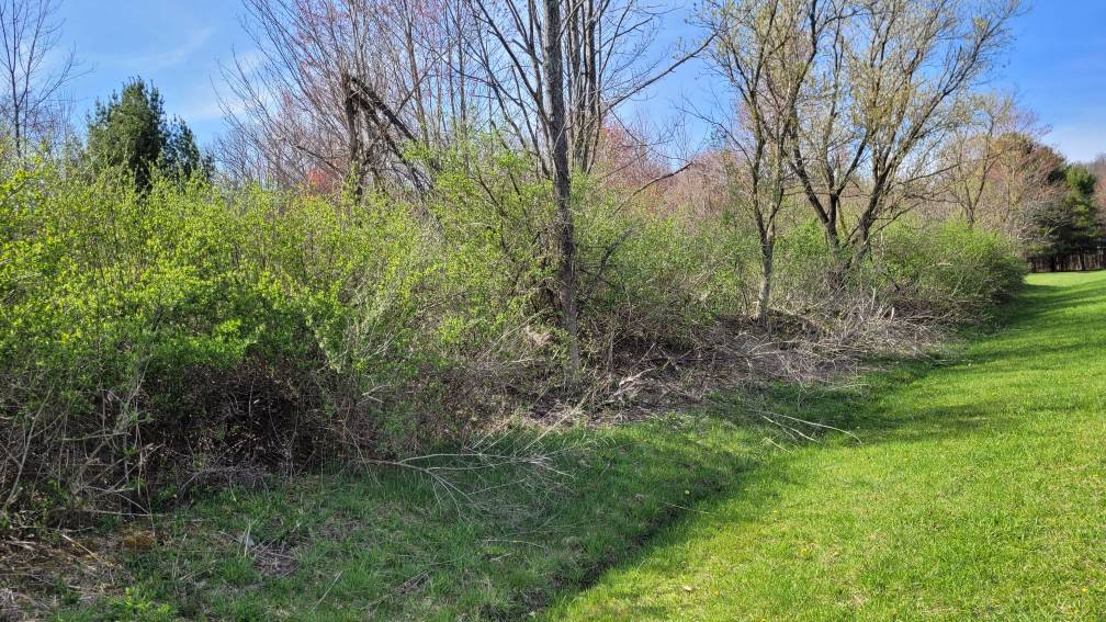

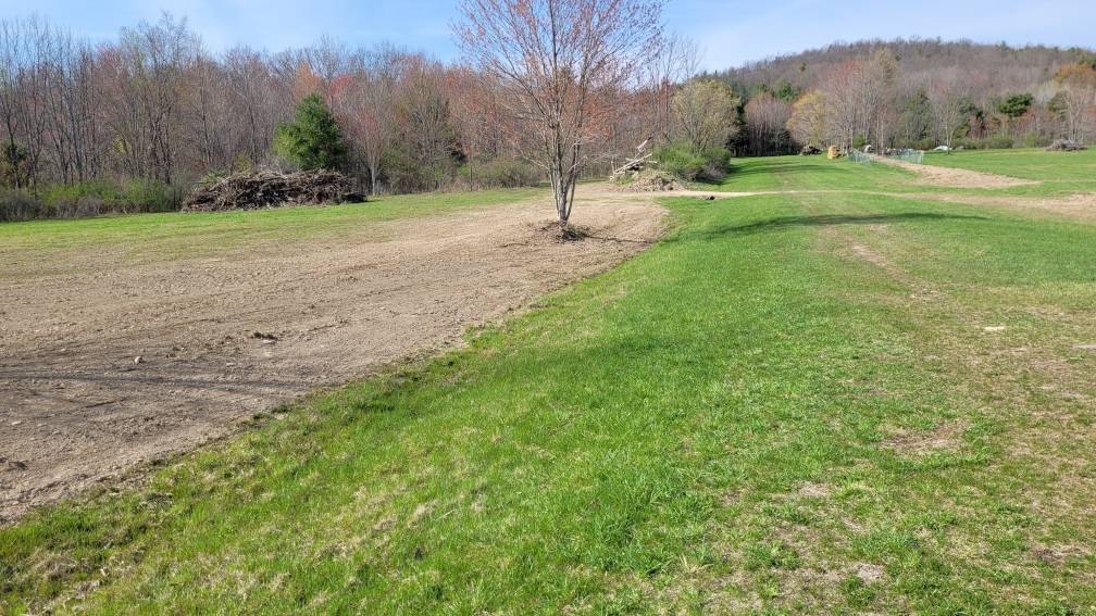

Getting the roots out is an important step to eliminate the need to repeat doing it again next year.
The root grapple works well for digging and disturbing the soil 3 to 4 inches, then grappling the brush and pulling it out...including the roots.
You can also back drag with the top tines to pull brush and rake sticks and debris out of the soil.
Originally this...now looks like this...
