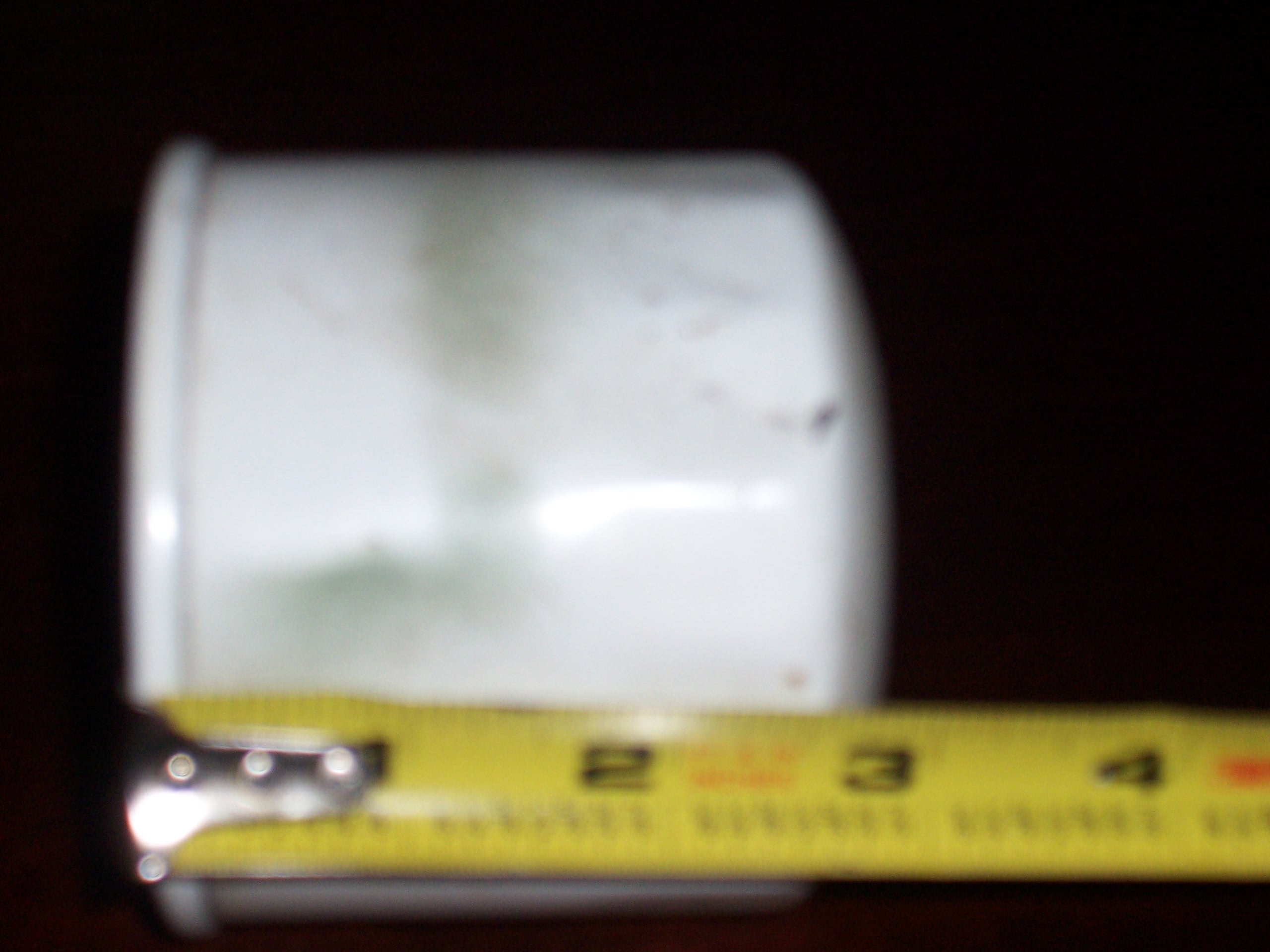

I use a pair of Oil filter Pliers. Harbor Freight 5$ from the bargain bin and Fram 3593-A. Sticks out far enough through the guard that it takes maybe 2Min. to change the Filter on my 2000. Walmart has the Fram 3593-A. Been using them for 10yrs.

I use the Fram 3593-A since that is what was on it when I bought it from Spalding...
/ Radiator Repair Question #26
I used to use the sakuras but Baldwins are cheaper here but longer by about 3/4". They are P/No B227. The longer length doesn't affect my filter changes.
/ Radiator Repair Question #27
The longer filters give a little more media. Most likely better filtration than the smaller filters with a little less media

I bought two OF-1334 when I was at Fredricks. The weight of them after 50 Hrs.of use was extremely heavy so I had Steve give me the Fram # again since I discarded it. After the 3rd. oil change the Fram was noticeably lighter and they are easy to pic. up at Walmart. Been 8-9yrs. using them and looking back in my pics. I found an old pic. of a Fred. filter and they are the same size. I know which one it was from the overspray of the touchup paint from the 2nd. oil change.

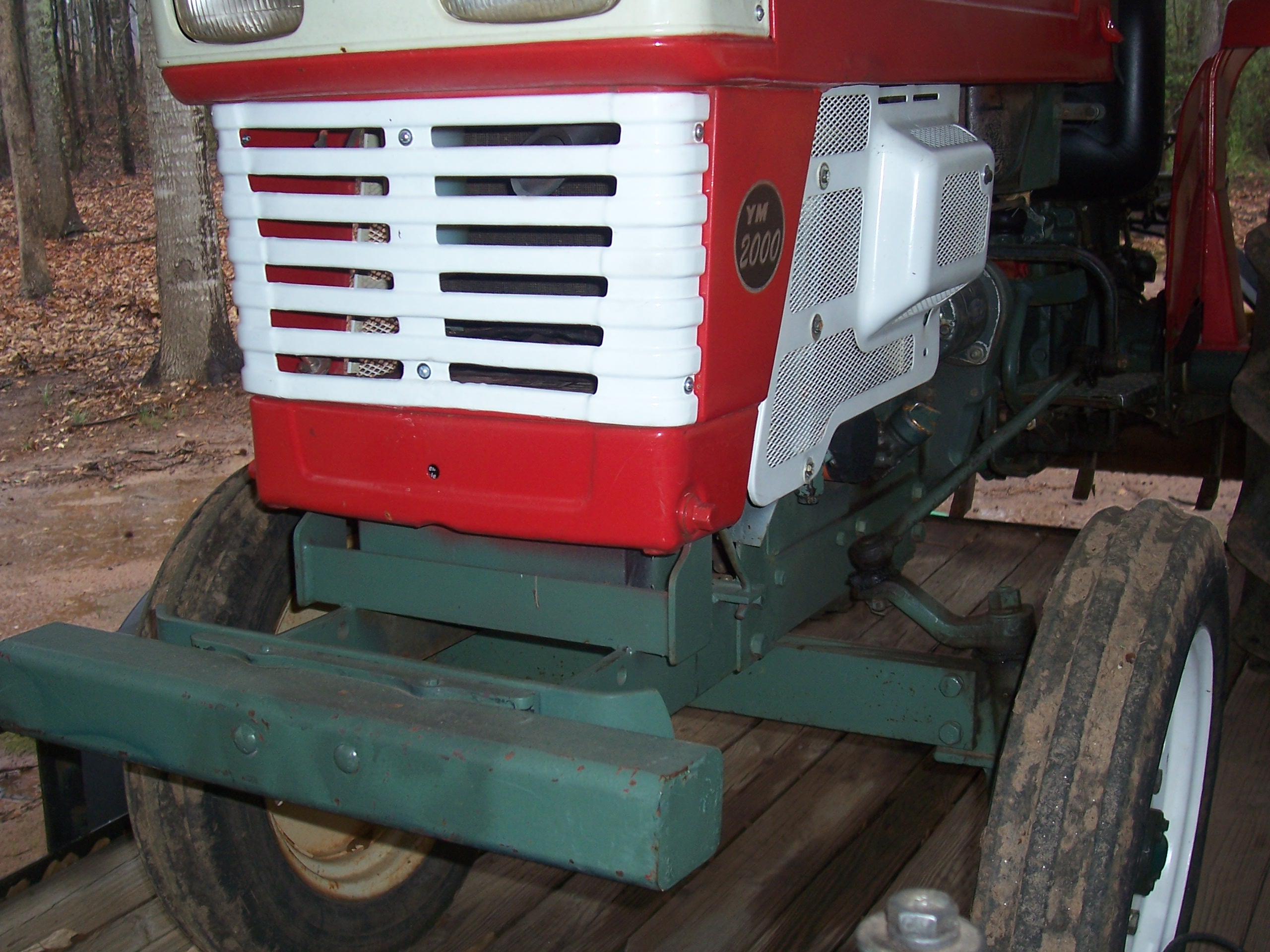

Just ran into this pic. on CL. of a Fredricks supplied 2210BD. It clearly looks like it's setup like my YM2000. Someone may have used a cover from another model? Would be typical for a Frankenstein VNer..... The 2210 & the 2000 uses the same Eng. block.

Nice find, Carey. That 2210D doesn't look like mine at all. That filter looks like it would come out easily; the side panel is much different than mine too.
