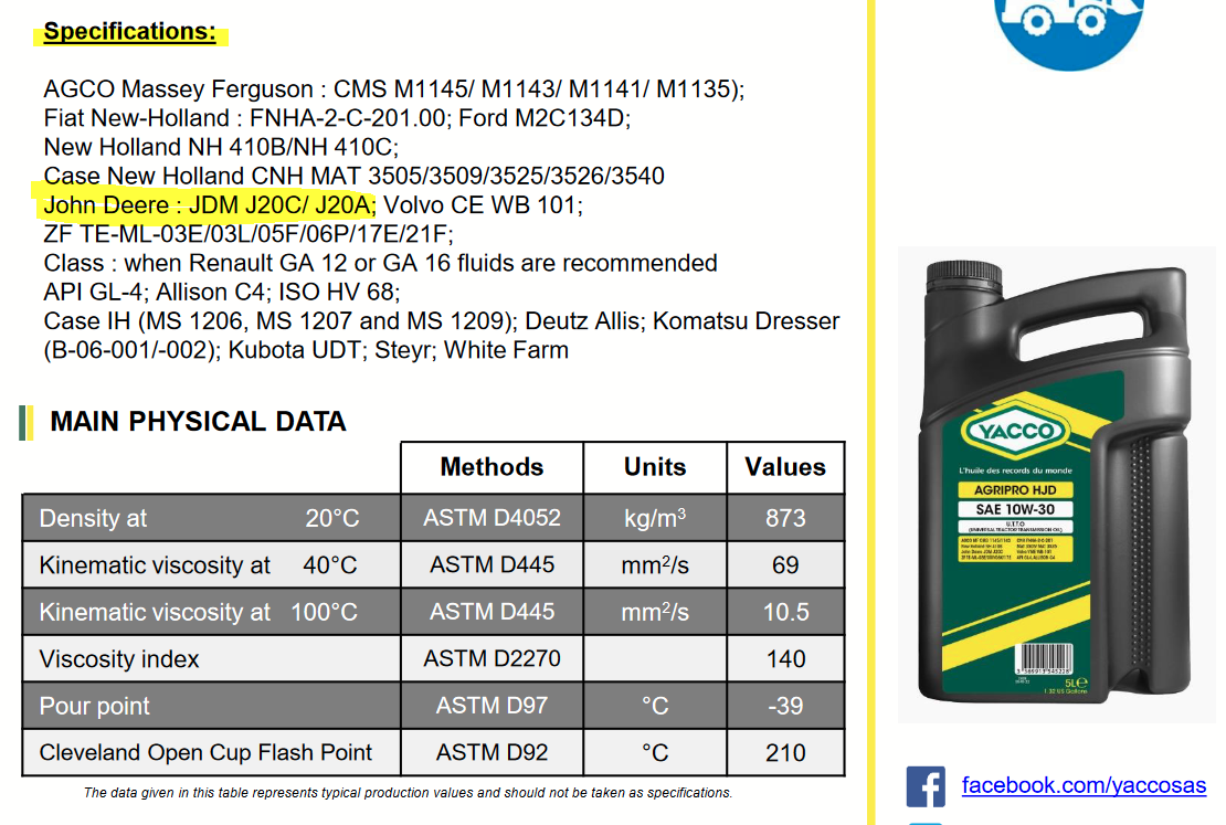

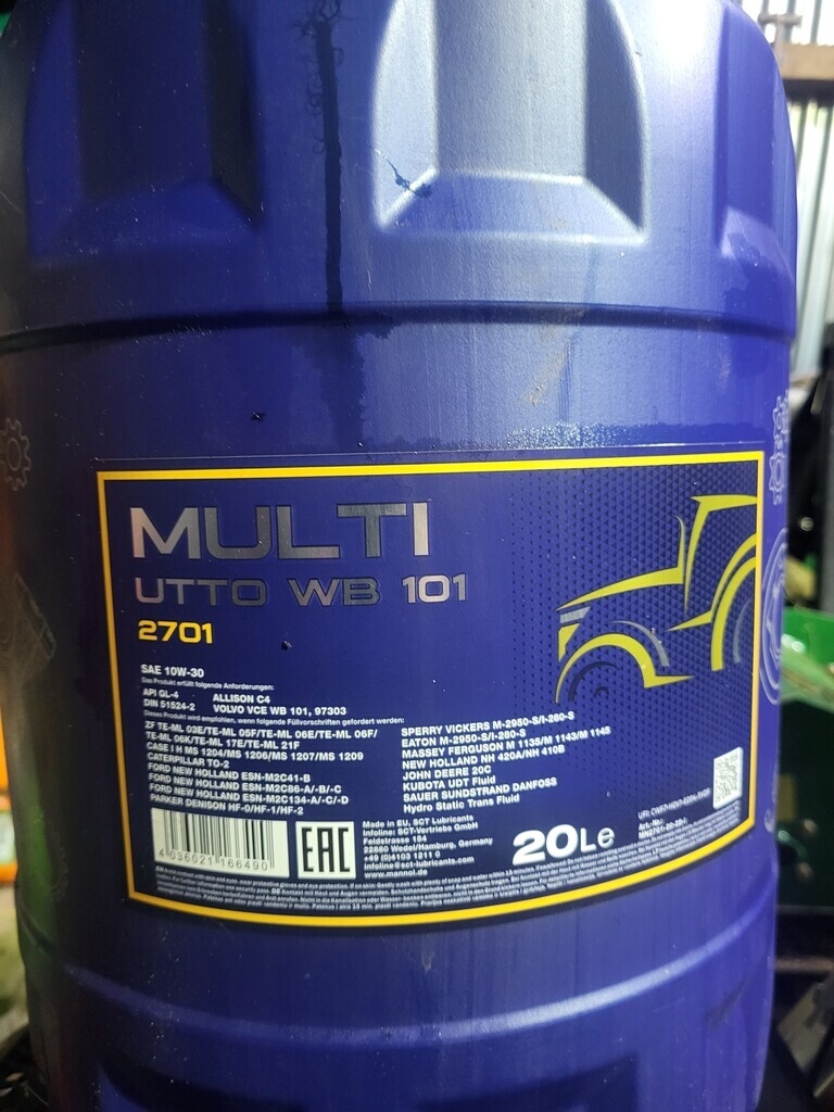

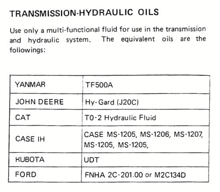

Additionally, the correct hydraulic fluid has to be used, else the system will gunk up.
In Europe,
Mannol UTTO WB 101 meets J20C specifications.
From the testing, Mannol Multi UTTO WB 101 meets J20C and not J20D.
There are not many fluids meeting J20D.
See 3rd party testing and evaluation per claims.
https://ukla-vls.org.uk/wp-content/...-publication-notice-as-at-06-10-2023-v0.2.pdf
Likewise, for many European regions, SCT's Mannol UTTO WB 101 is accessible.
The fluid also meets the strict CATERPILLAR TO-2, the base line for J20C.

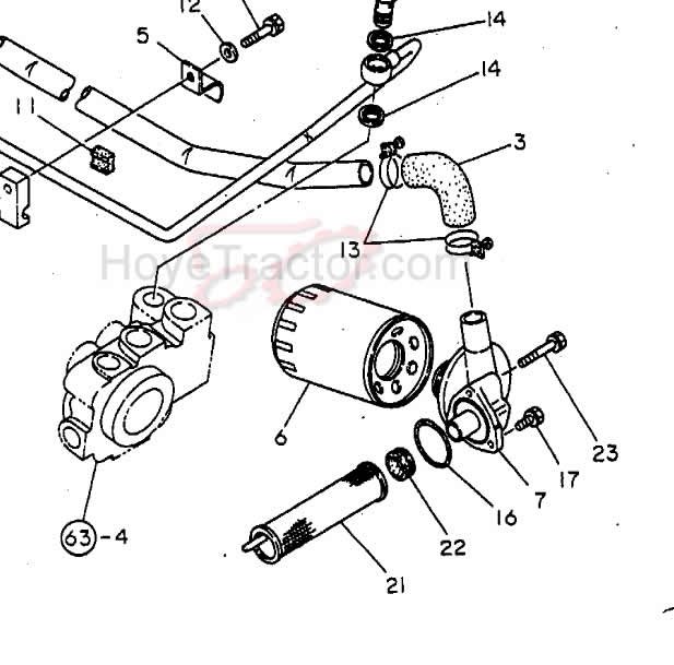

F14 Hyd. screen is showing to be a Spin on Filter! HF-1120.
I do show A filter screen also for the "F-16 only and the ym180-2002". Is there two on the F-14 ? Interesting.

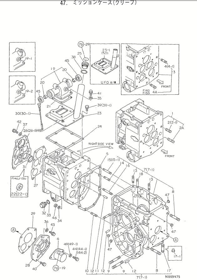

Sorry to be a pain, but I have trawled through the manual and am not sure what you are referring to with regards to section 124 and 125. What pages are these sections on? The only reference I could find to the UFO was on pages 139 to 141 (PDF page numbers).
From what I can tell, my tractor does not have UFO. IT appears to only have the three point draft and three point levers. I'll snap some photos and post them when I get home tonight as there appears to be something on the left side of the seat that looks like it is missing. This appears to be some control for the three point lever but I am not sure.

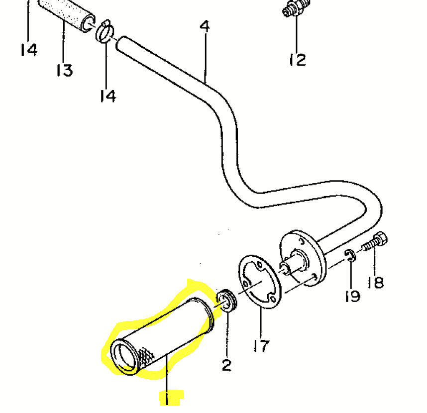

This was the state of the suction filter. I am having trouble locating a part number. Could anyone help me out with that? Thanks in advance.

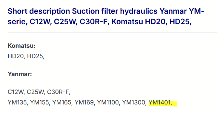

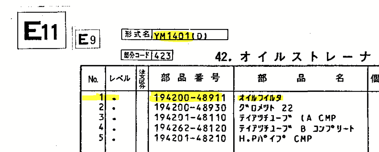

Is the YM1401 the same as the F14D the OP has though?

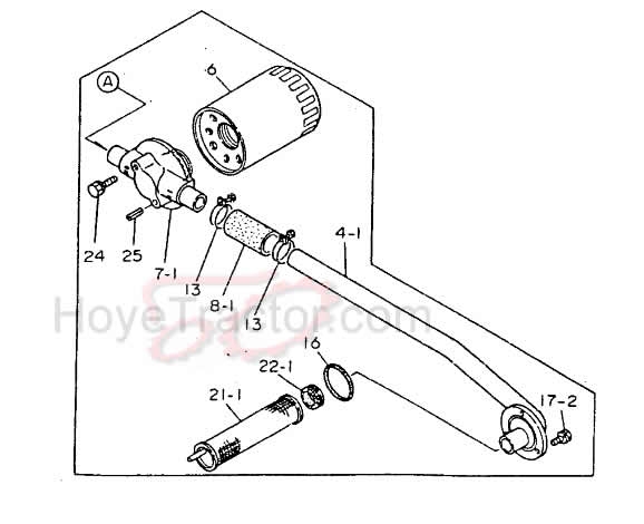

Do you know why that manual illustration shows a filter without a pin?
All the best, Peter
Nope. Some of the odd YM models ending in 01 are strange. Not the typical arrangement of things.
As for the F14/F15, I can find all the filters with the exception of the hydraulic screen in the parts manual.
On the parts page for the suction pump, no filter is listed there.
/ Hydraulic issue on F14D #17
The OP has pulled out a filter screen, yet I can not locate one in the parts manuals for the F14 or F15 model. This is puzzling.
/ Hydraulic issue on F14D #18
It wouldn't be the first manual not to have a key part listed.
The pin looks like some sort of spring index item to me. I asked because this seems atypical in my experience and I was curious how it functioned, and of course, why. Thanks.

Thanks for the replies gents. The part number bmaverick matches this filter:
I will order a filter immediately. I have a mechanic friend working on the tractor as I don't have anywhere clean enough to have it disassembled. He tested the system without the filter but is getting intermittent flow from the pump. It also seems to be making a great deal of noise so I may be in for a new pump too.
