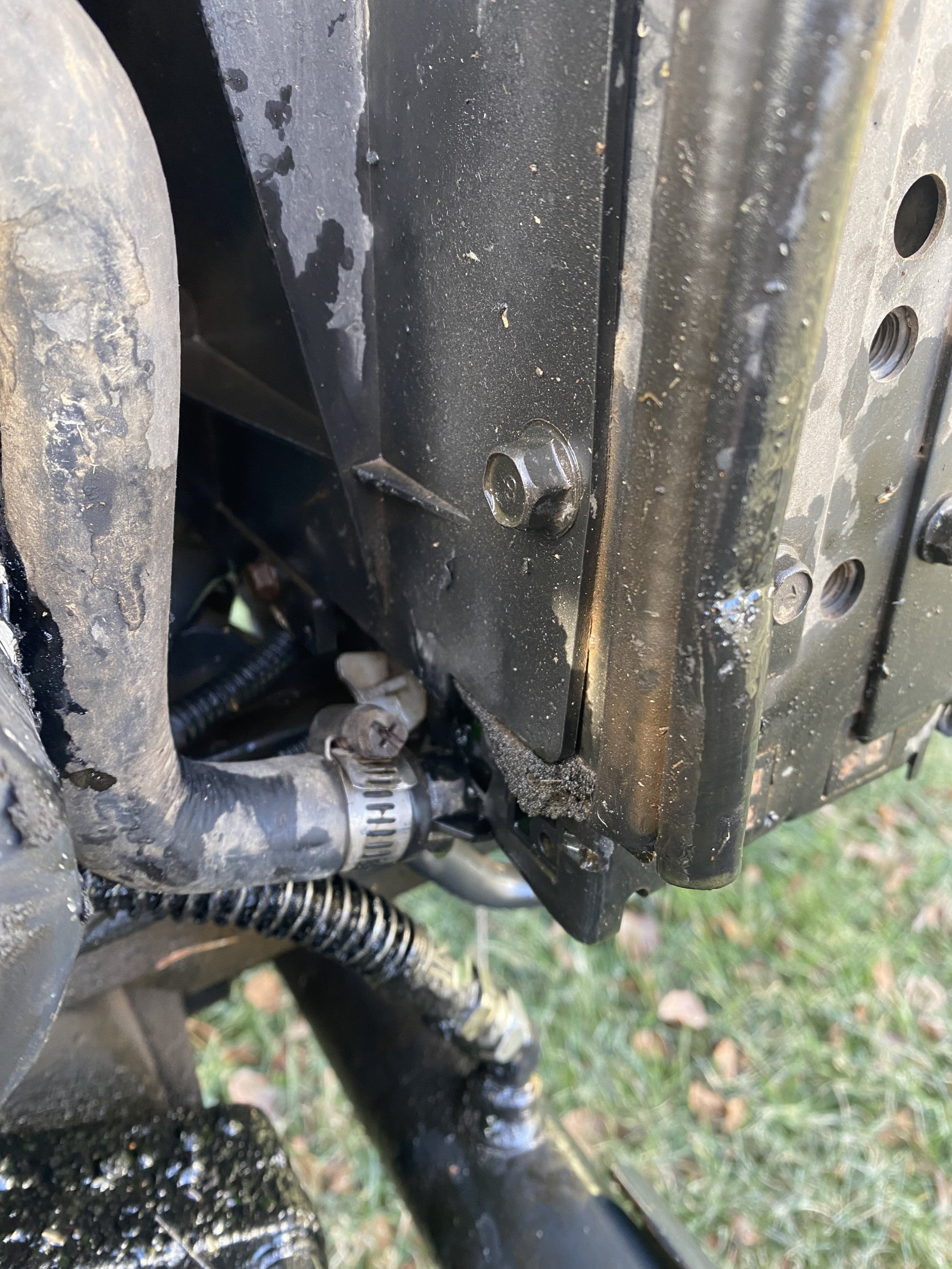

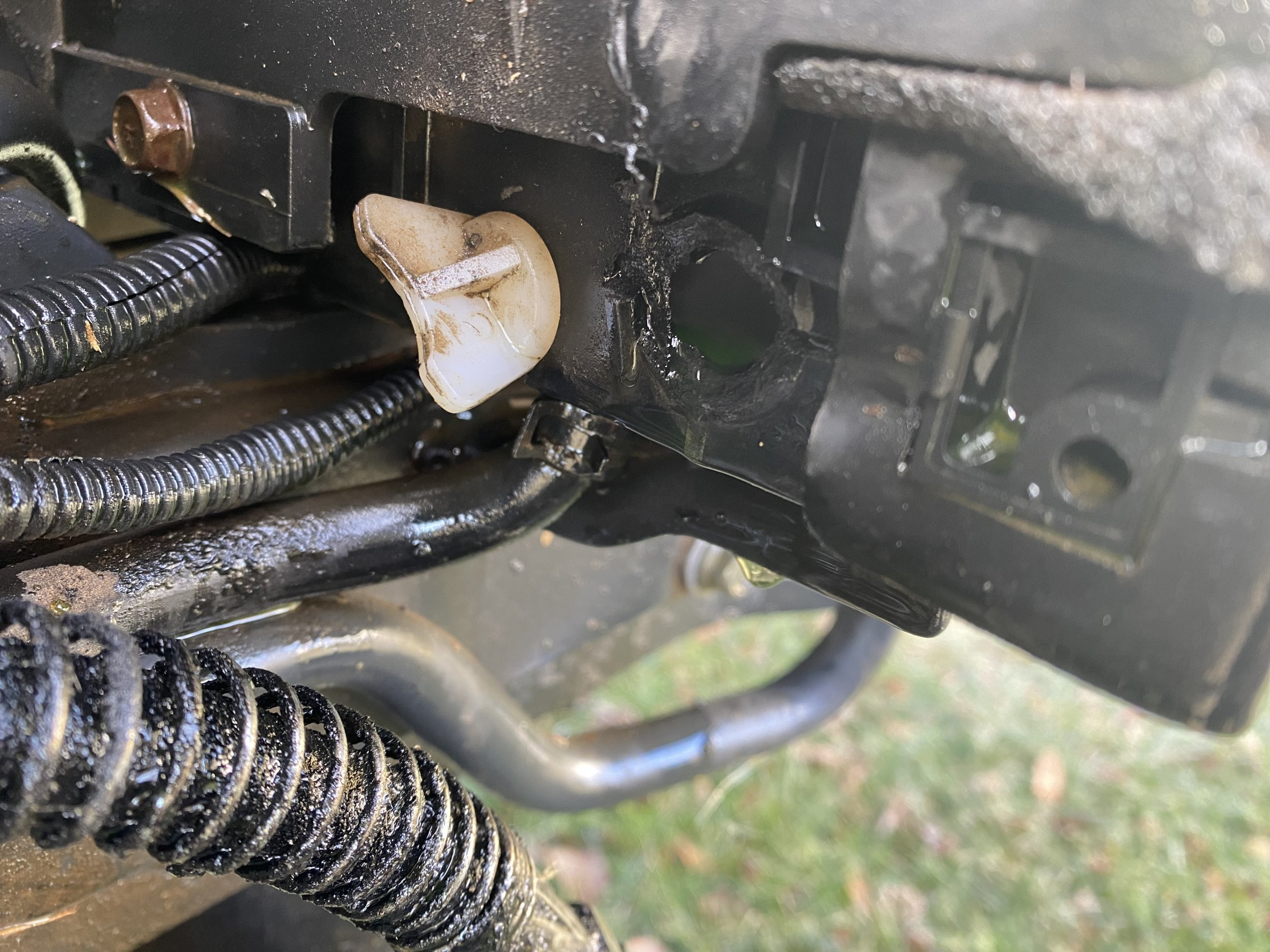

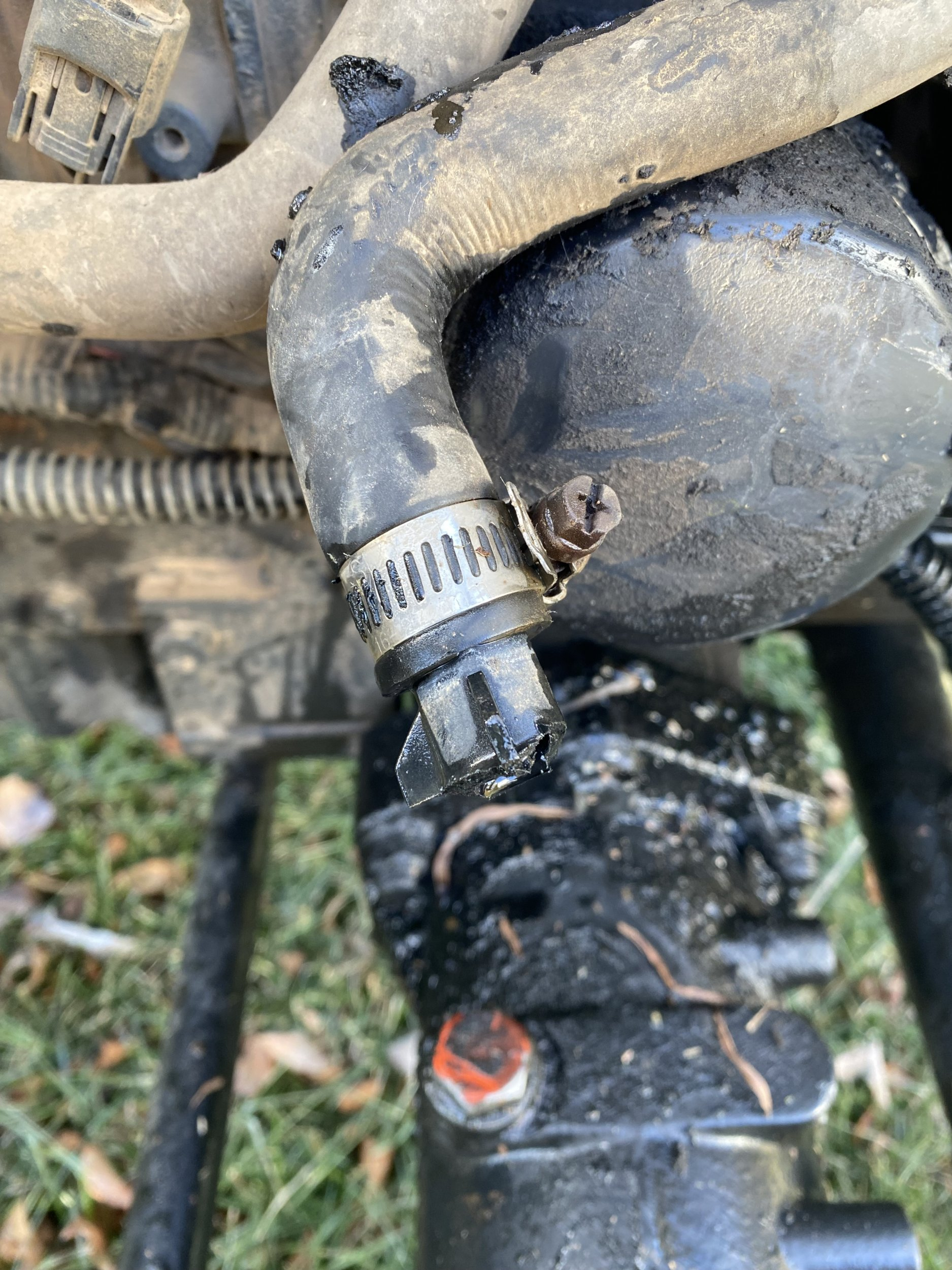

Well as the description says, was out clearing some brush and started smelling radiator fluid, checked and found this:
Closer inspection revealed this:
As you can see, the plastic part of the lower radiator, clean snapped off and is still in the hose. My guess is the only option is replace the radiator, but figure I'd check here first before buying something.
One last photo showing the broken opening on the radiator:
For the record, this is a Bobcat CT335....I don't think that matters but figured I'd throw it out there.
The radiators are made out of glass reinforced HDPE and I have tried many techniques and glues to repair them to no avail. Even 3m radiator glue (I forget the exact number on the epoxy I used but it was for radiators specifically) doesn't hold very long, maybe a year. I wish there was a better answer but replace is the best and only option in my experience.

I doubt those tanks are removable to repair from the inside. If you could fabricate a plate with a nipple attached and then with sealant or JB weld, pop rivet it over the hole it may or may not work. Good Luck.
